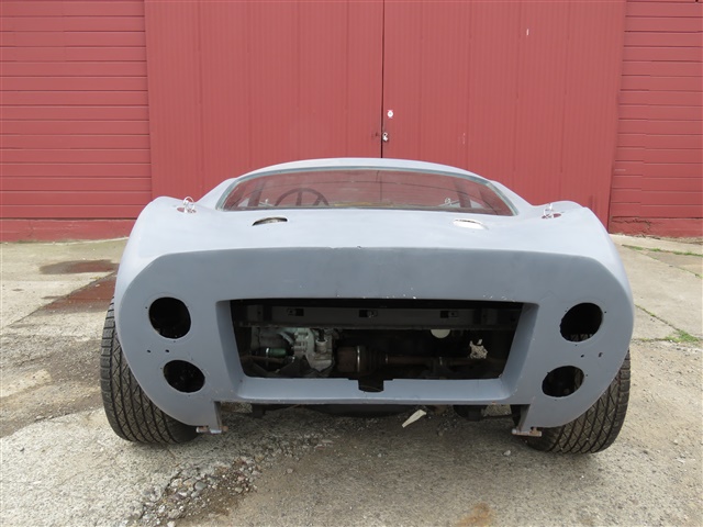

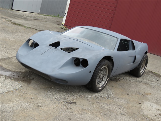

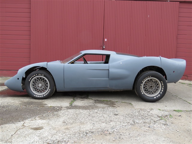

Patrick JUN 22, 01:29 PM
Originally posted by DroKnows:
I bought an Fiberfab Avenger GT kit from eBay.
Just so we can all see what you're referring to...

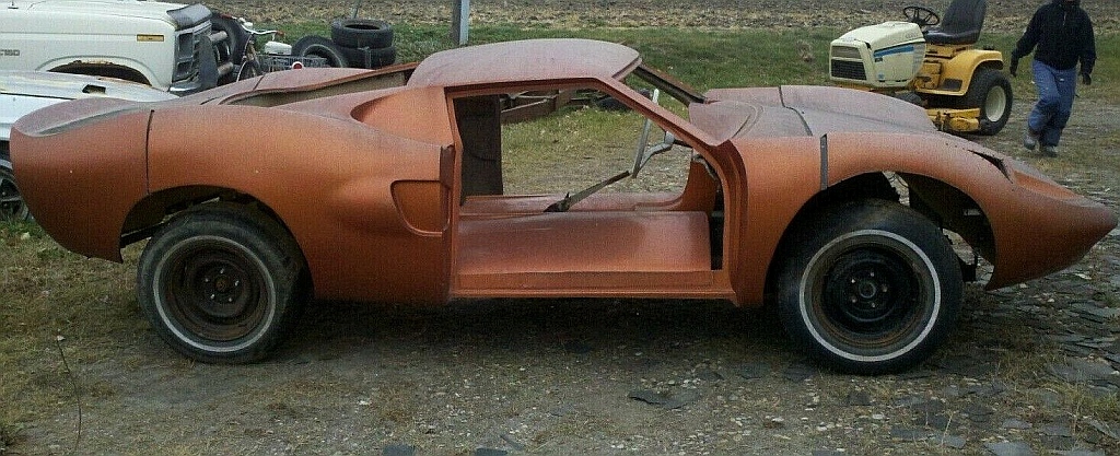

DroKnows JUN 23, 10:20 AM
Cool, very helpful. Found these pics of the exact kit I bought, mounted to a Fiero.

cvxjet JUN 23, 05:54 PM
Personally, I would go with the LS4 V8...Much lighter, and has the bellhousing shape for the Transverse transmissions. With a Iron SBC, you will be worse than 40/60 % weight distribution to the rear- spooky handling.....
They were in 2005-9 Pontiac Grand Prix, Chevy Monte Carlo/Impala and Buick LaCrosse.
How much structure is under the FG body? That will tell you how much Fiero structure you will have to cut away. Also, compare Wheelbase and track width to see how much the body has to be stretched to fit over a Fiero chassis.
