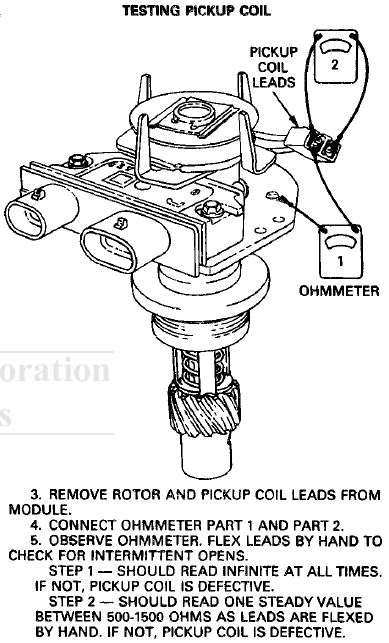

fierosound
MAR 03, 10:02 AM
One of our guys had a similar problem and I traced it to the pickup coil. Replaced it and no problems since. Testing is easy and can be done on engine.

phonedawgz
MAR 03, 08:02 PM
If you haven't replaced the pick up coil ever, that is where I would start. One that looks like crap even if it is still working is just waiting to leave you on the side of the road. Most (all?) pick up coils by this time are falling apart.

fierosound
MAR 04, 08:06 AM
quote | Originally posted by Lou6t4gto:
pick up coil replaced. ICM about 5 years ago. |
Don't guess - TEST the pickup coil with an ohmmeter. ICM could still be flakey. I had some aftermarket ones die in 1 YEAR.[This message has been edited by fierosound (edited 03-04-2018).]
