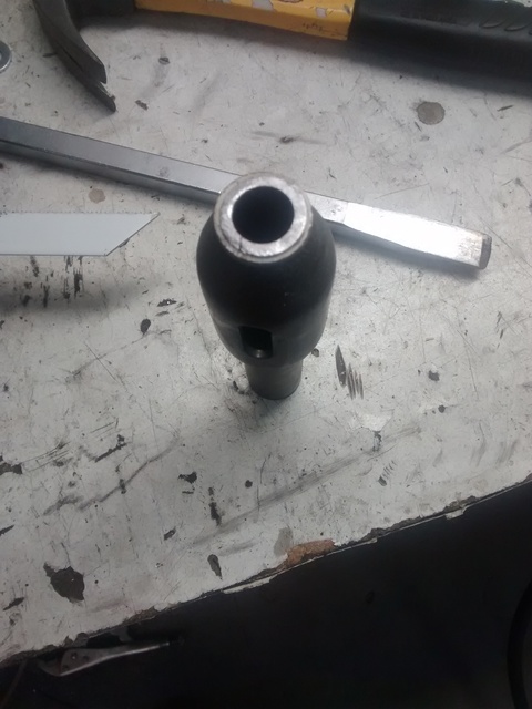

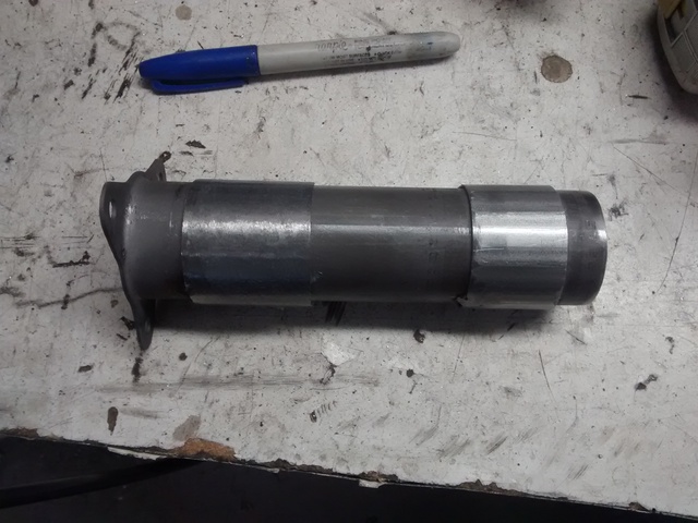

One of the first differences was the dis-assembly of the Vue column. The lower portion, with 3 bolts that attach to the motor, is what is required. Rather than Slicing into the Vue column to get access to this piece, I just knocked it out using a long socket extension . It is meant to slide in the event of a collision anyway, and if the edge you are tapping on gets a little damage, it's no issue to just cut 1/2" off after it is out. You really don't need the entire piece anyway.

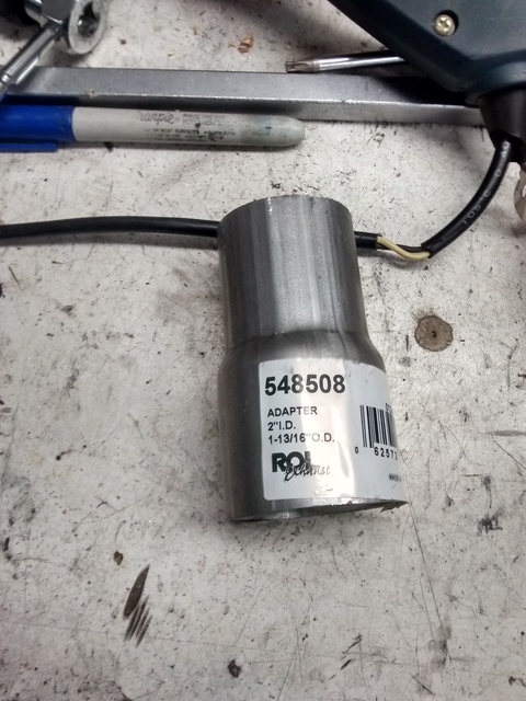

To make it fit inside the FIero column, I used a couple of "slices" of 1 13/16 OD exhaust pipe. It was a perfect fit. I got mine at O'reilly's via an adapter. I find that this particular size of pipe is otherwise very hard to find. I used a coupler, ROL PN 548508 , and just cut a couple of slices off with a reciprocating saw and tacked them onto the Vue piece we just pulled out. Grind the tack welds down so thay do not inerfere with the part sliding into the Fiero column. I found the first "slice" slide right in, but the second one got a little tight. A little light sanding removed some of the manufacturing defects of the exhaust pipe to make it perfectly round. Now you have a connection to the Fiero column that is perfectly centered.

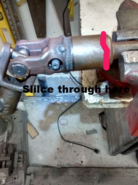

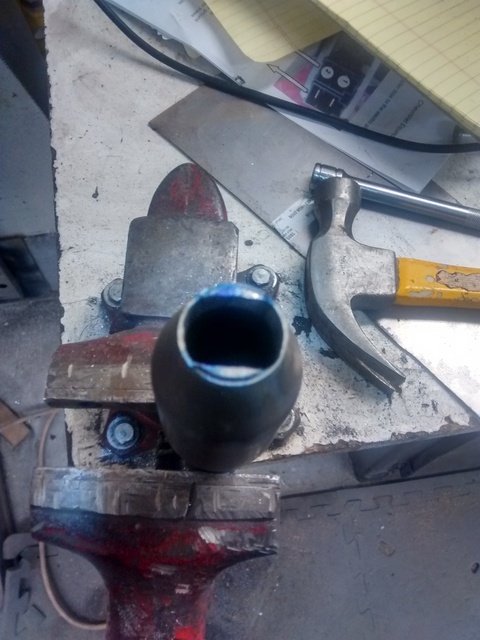

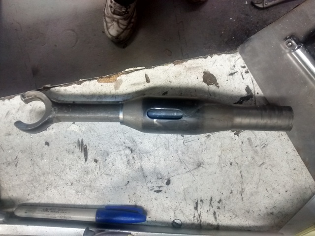

For the lower steering coupler, I used the VUE coupler shaft with the Fiero lower U-joint. I cut both lower u-joints off, and then welded the Fiero u-joint to the Vue shaft. Overall length was 19.5". Keep both u-joints in the same orientation.
If you "slice" through the outer portion of the Fiero U-joint, where I have the red line marked, you will find the inner portion is filled with rubber.
Once the outer portion is sliced, the Fiero shaft will just pull out ( with some effort). Don't forget to first drive out the Roll Pin in the shaft. You can then dig out the remaining rubber from inside the Fiero U-joint. I found in my scrap pile a piece of pipe that would just fit inside the Fiero U-joint, and the ID of this pipe was just the right size for the round Vue shaft to be installed. Gave me an easy way to reduce the Fiero u-joint to match up with the Vue column connector.
On the Fiero, the bolt for the lower u-joint was vertical ( head at 12 o'clock) when the wheels were straight ahead. I welded the shaft so that the Vue bolt was also vertical, but with the head at 6 o'clock, for ease of install. The Vue shaft slides on grooves, and it looks like the shaft was heat treated after assembly to create 2 "hot Spots" that restrict the ease of the shaft sliding. It can be moved, but it does require some force. This was probably one of the harder parts of the install- getting the shaft onto the end of the motor and onto the Rack and Pinion. I eventually pulled the 4 bolts holding the rack to give me some wiggle room. No problem with alignment- just bolt the rack back on.[This message has been edited by darbysan (edited 07-04-2025).]

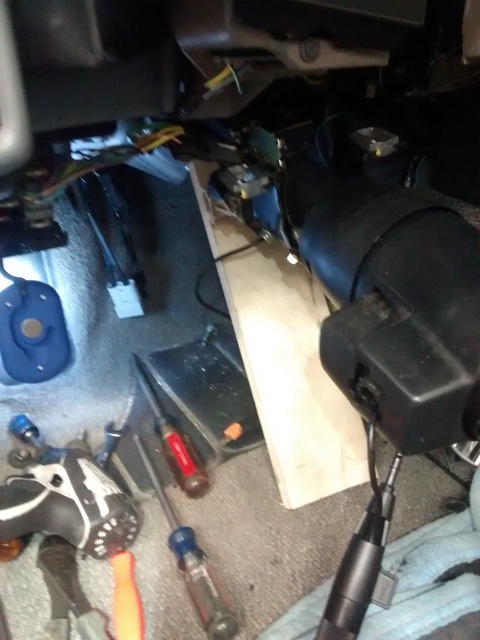

The hardest part of this install was getting my old, fat body to work under the dash. It got even harder trying to install the column with the motor attached, as the weight of the motor wants to torque everything towards the left. I finally made up a tool to help me install, from a piece of scrap plywood. I use it to support and wedge up the motor end of the column. I put the steering wheel nut on the column, locked the wheel via the key, and then used the nut with a long socket wrench ( breaker bar would also work, to help counter the torque as I shoved the completed unit into place.
Note that the end of the column shaft should have a "notch" in it, like a chisel strike. This was made at the factor to signify straight ahead when the wheel is installed. Use this notch, along with the key to lock the column in a straight ahead position for aligning the lower steering connector to the vue motor shaft.[This message has been edited by darbysan (edited 07-04-2025).]
