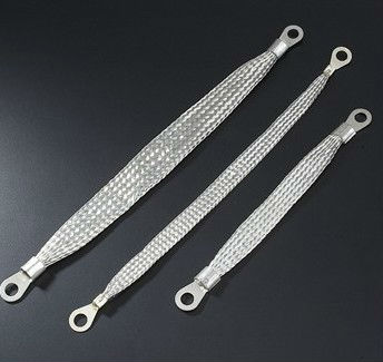

There is a ground strap which should be on the right side of the decklid. It is a braided stainless cable that has ring terminals on each end and looks something like this:
There is also a strap on the left side that is a circular cable which is sheathed with plastic and also has ring terminals on each end. That is a travel limiting strap to prevent the decklid from swinging up too far if the tension rods provide too much pressure (like if the deck came with a spoiler from the factory and you removed the spoiler reducing the weight of the decklid).
