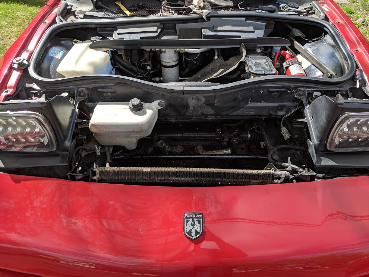

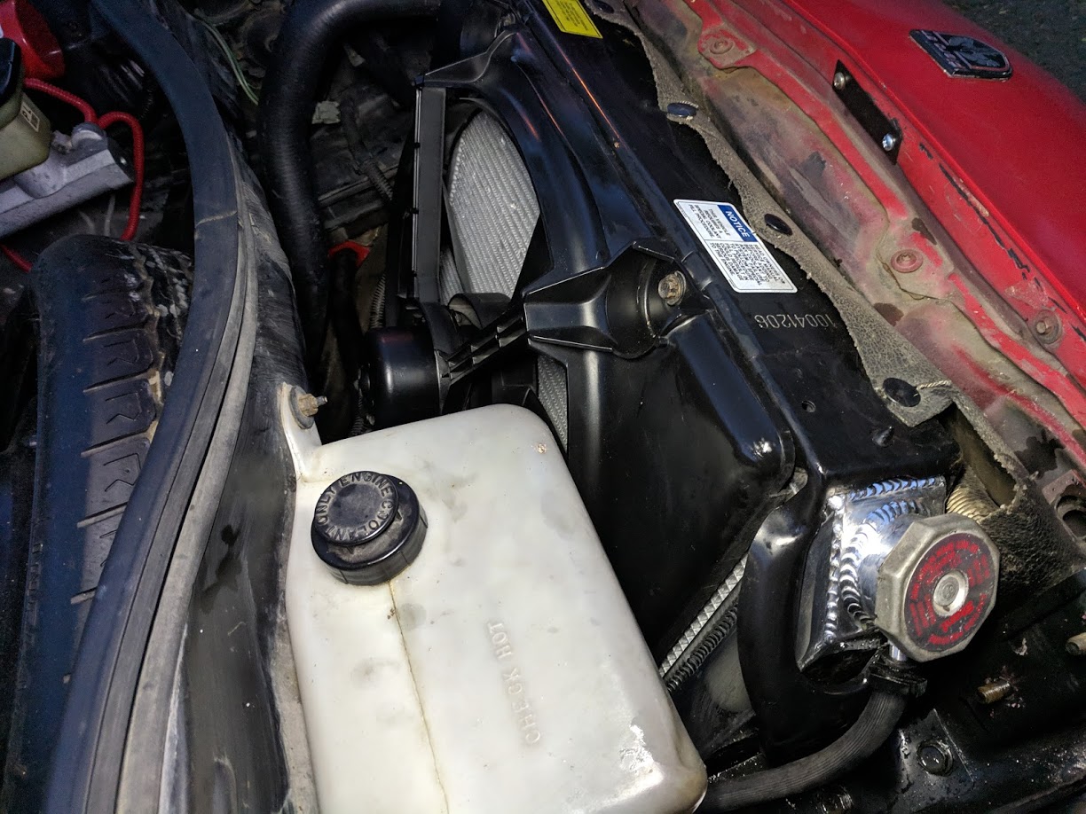

Champion radiator:

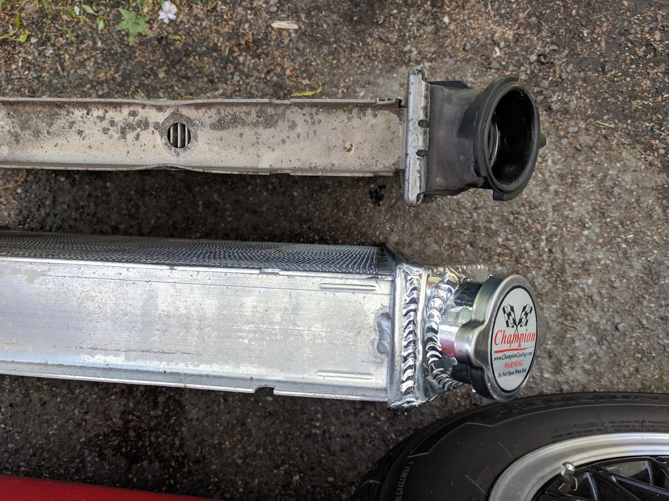

The plastic part of my radiator decided to crack, so I decided to upgrade to a three core Champion unit with new radiator hoses from Rodney while I was there. Works great.

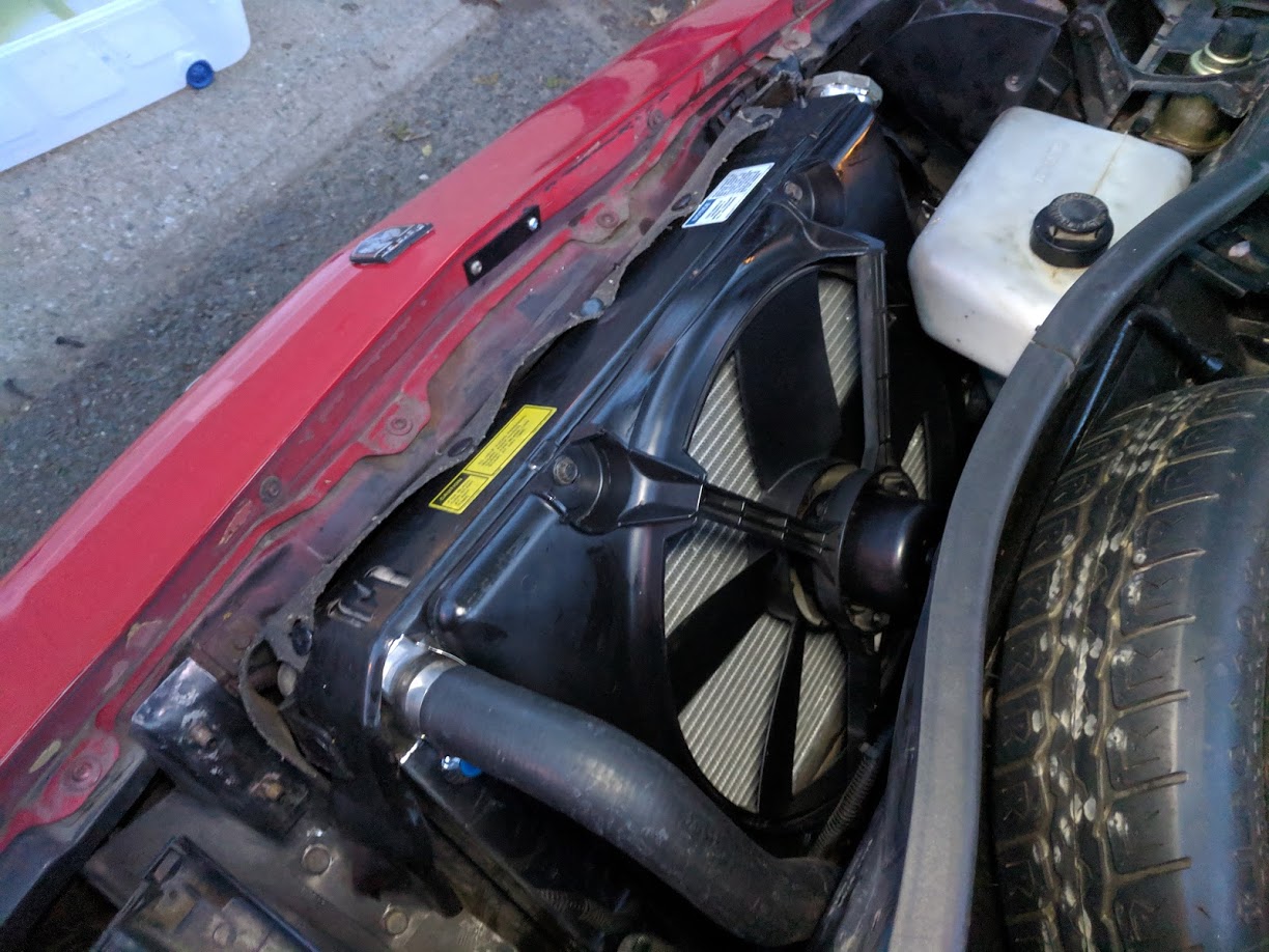

You can see how much FATTER the three core radiator is!
Air cooled Fiero? Would never work!

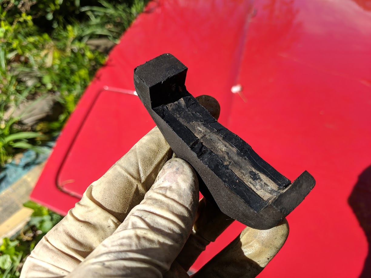

Some light modifications were needed to be made to the rubber feet and the top support to fit the wider radiator.
Like a glove!

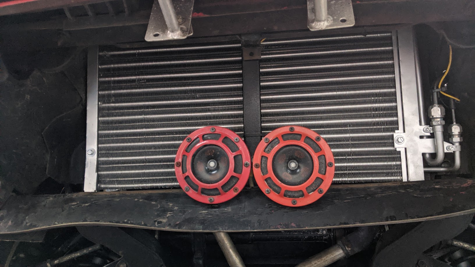

AC STUFF:

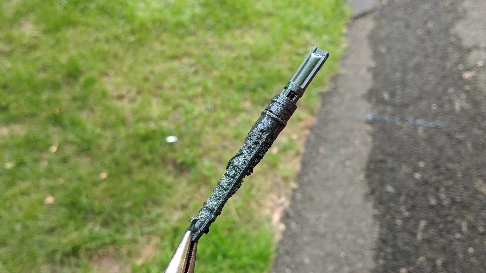

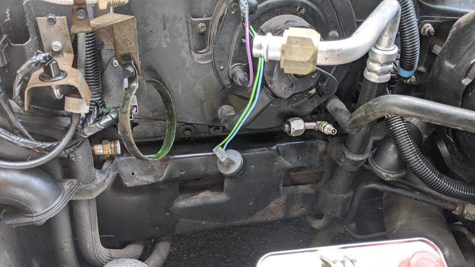

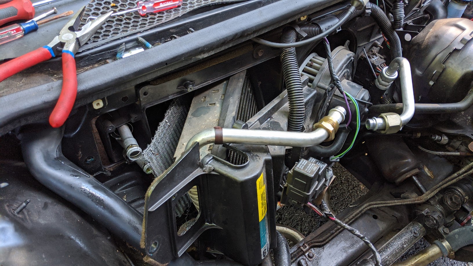

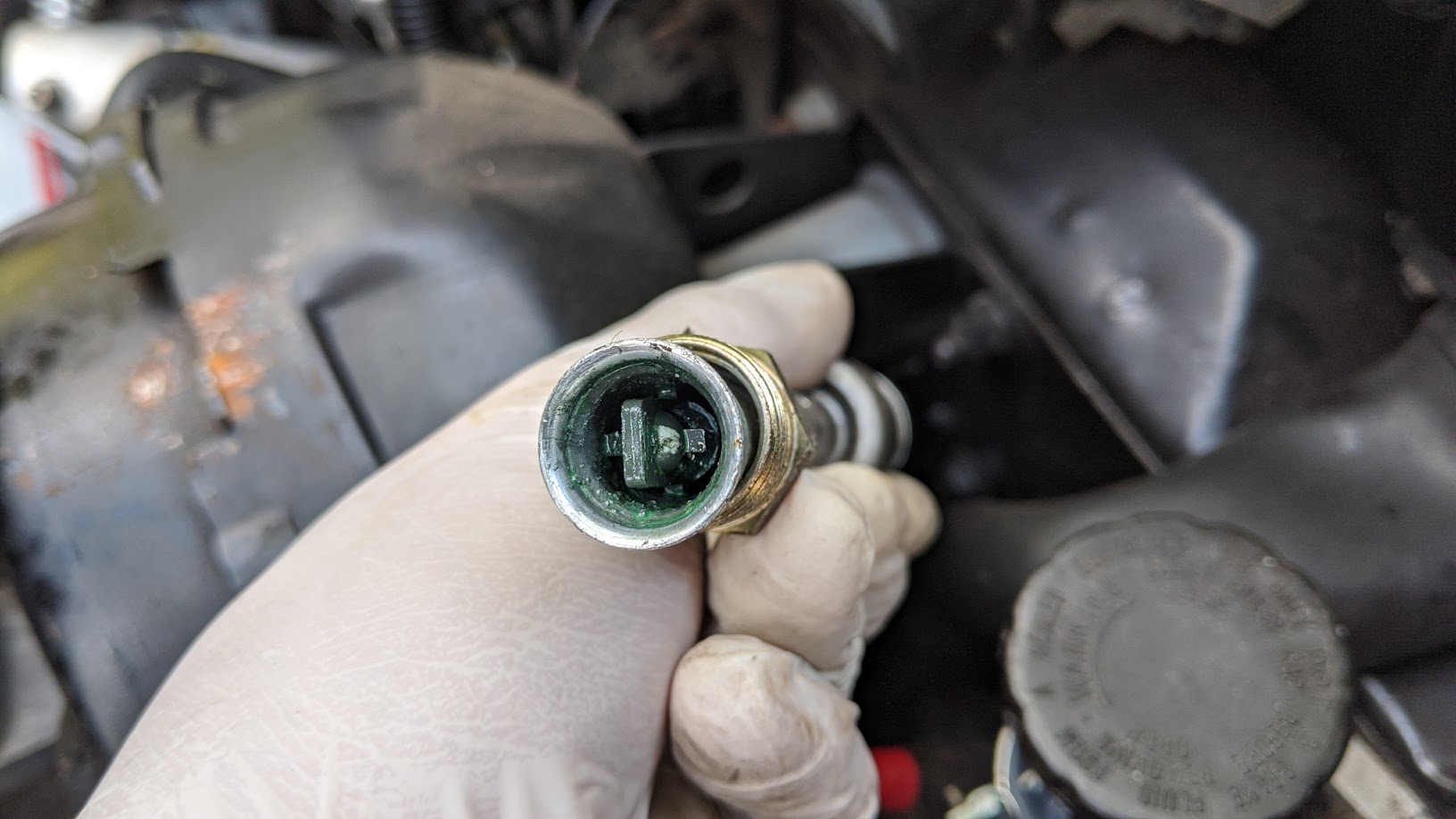

I wound up getting black death. Great. I went through the entire system; what a nightmare, I removed and flushed every pipe out individually with AC flush in both directions until no more crap was coming out, I changed the O rings everywhere to the green ones (whoever did the conversion before me didn't do this), also I replaced the evaporator, condensor since they aren't very flushable and didn't want to take any chances. Installed with a fresh, factory oriface tube too, of course!

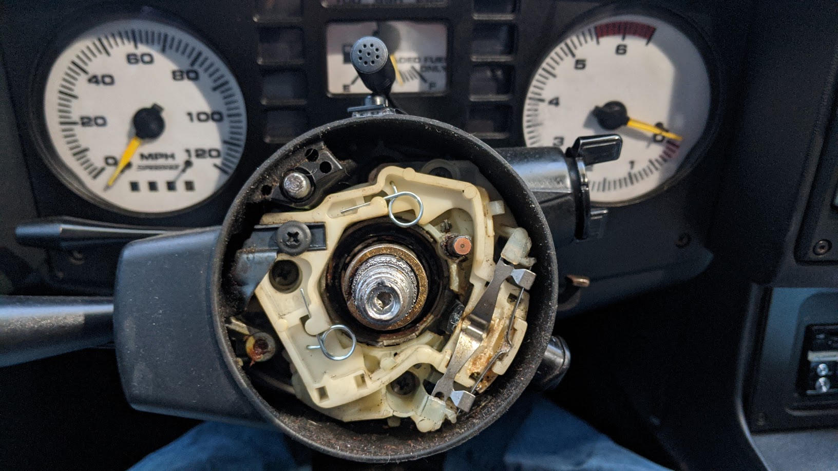

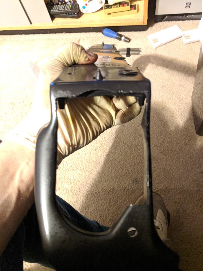

Random things tend to brake on old cars, the left blinker stopped canceling, so I took the column down to the blinker mechanisim and replaced a broken spring (replaced both springs) and threw a new cancel cam in while I was there. Nothing crazy to see here, honestly.
