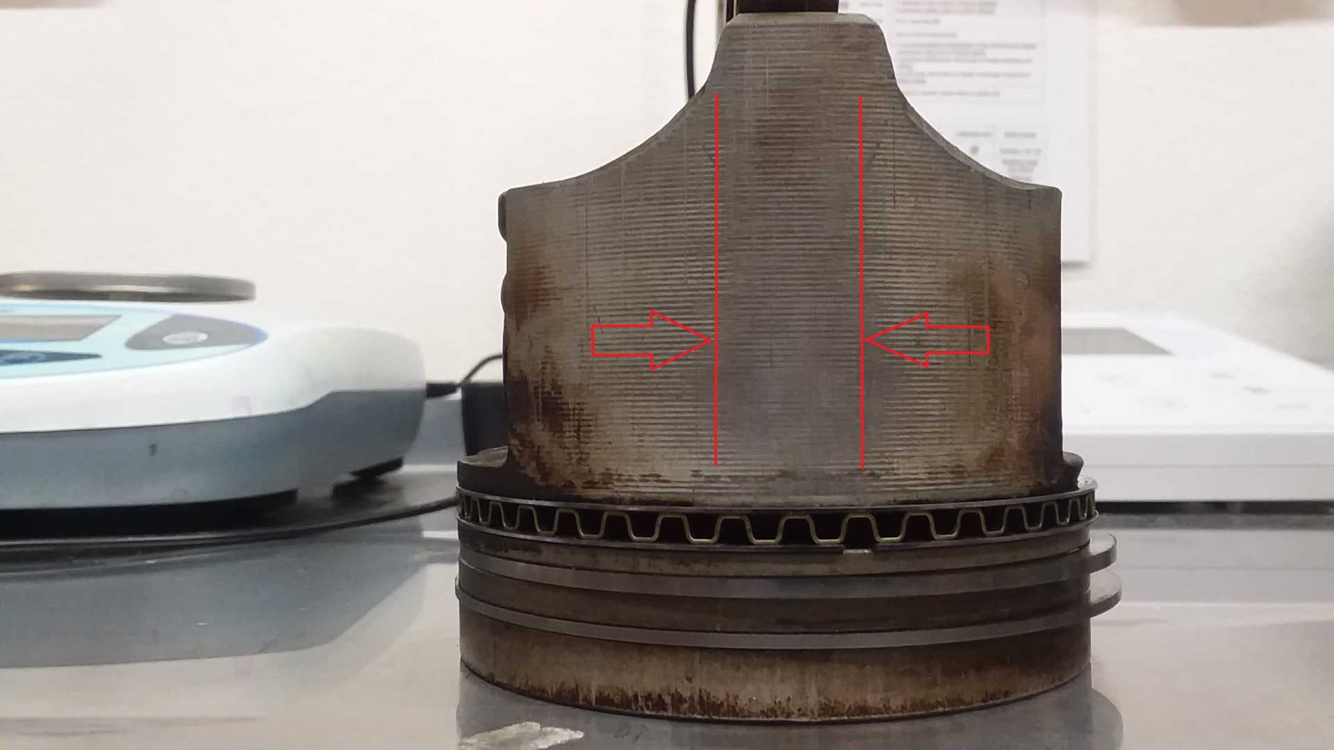

It seems like things are in spec and check out (It's super weird that everything checks out, yet the fluid leaked so much)...
You should do a hone job on that cylinder before putting it back together if you can to give those rings a fresh surface to seat to, the cylinder wall is looking shiny, maybe it wasn't honed properly by whoever was in there last and it didn't "seat" well?

Update: I looked for out-of-roundness with the top ring, using the piston to move the ring down about one inch at a time (per Uncle Tony), with a light at the bottom right beneath the crank. I ran the test twice: once with the ring gap clocked at Noon and once at 3PM. Both showed no light leaks around the ring edges. I can definitely see that the area swept by the bottom-most "point" of the piston is highly polished, with no remains of the cross hatch pattern (i.e. corresponds to region between the Red Arrows). This is about the only feature of the Bore that seems suspect to me.
