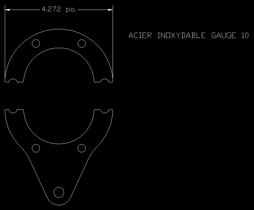

 Only for the more "precision" work, or for shapes that would be a PITA to do with hand tools, then I make a *.dxf drawing, which I have cut by a metal shop in my town. They have a plasma-cutting table.
 If we look at the turbo support components, the turbine housing clamping plates were something I outsourced. I made this *.dxf and had it cut from stainless:

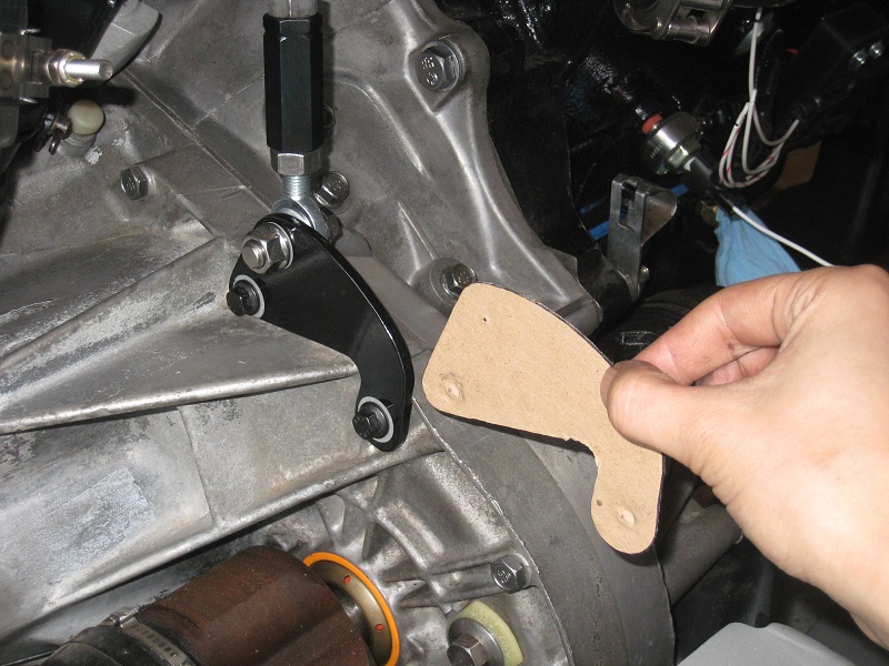

 On the other hand, the bottom mount that bolts to the transaxle was easily within my capabilities. I did the design in cardboard, traced it in steel, and then cut it out:
 It was just faster and easier to DIY it. I sidestepped the difficulty of digitizing a semi-arbitrary shape (as opposed to something easy to measure, such as a circle or rectangle). Outsourcing also brings the administrative burden of having to keep tabs on the supplier.

          | LOL at seeing dimensions in inches on a drawing labeled in French... |  |

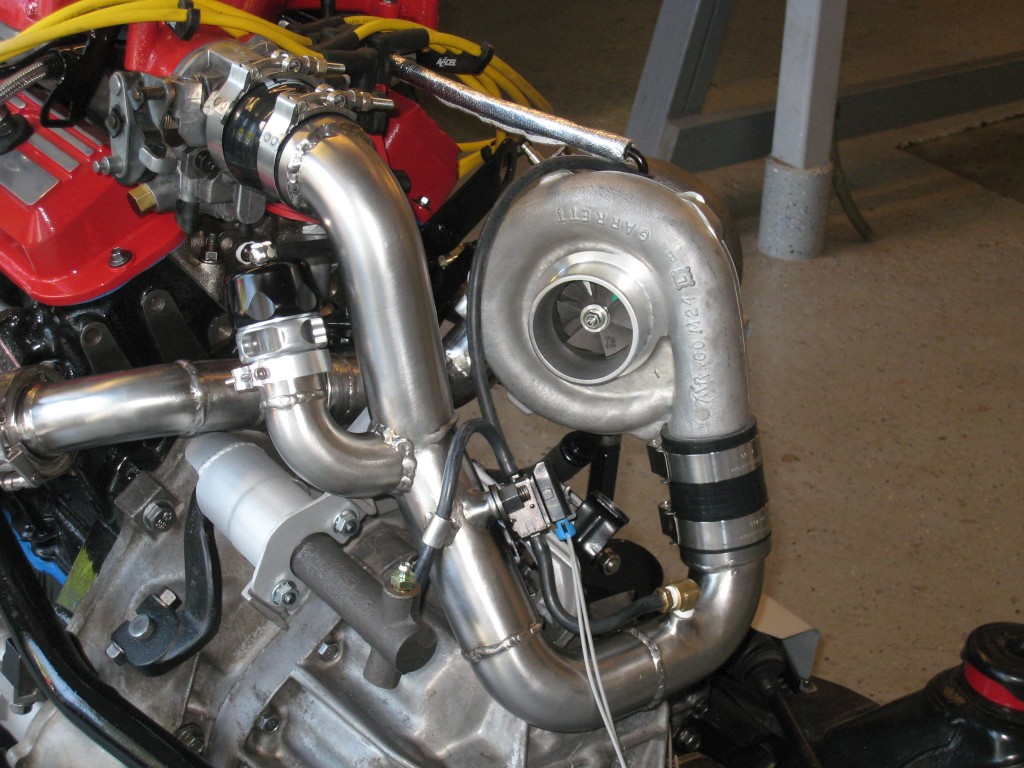

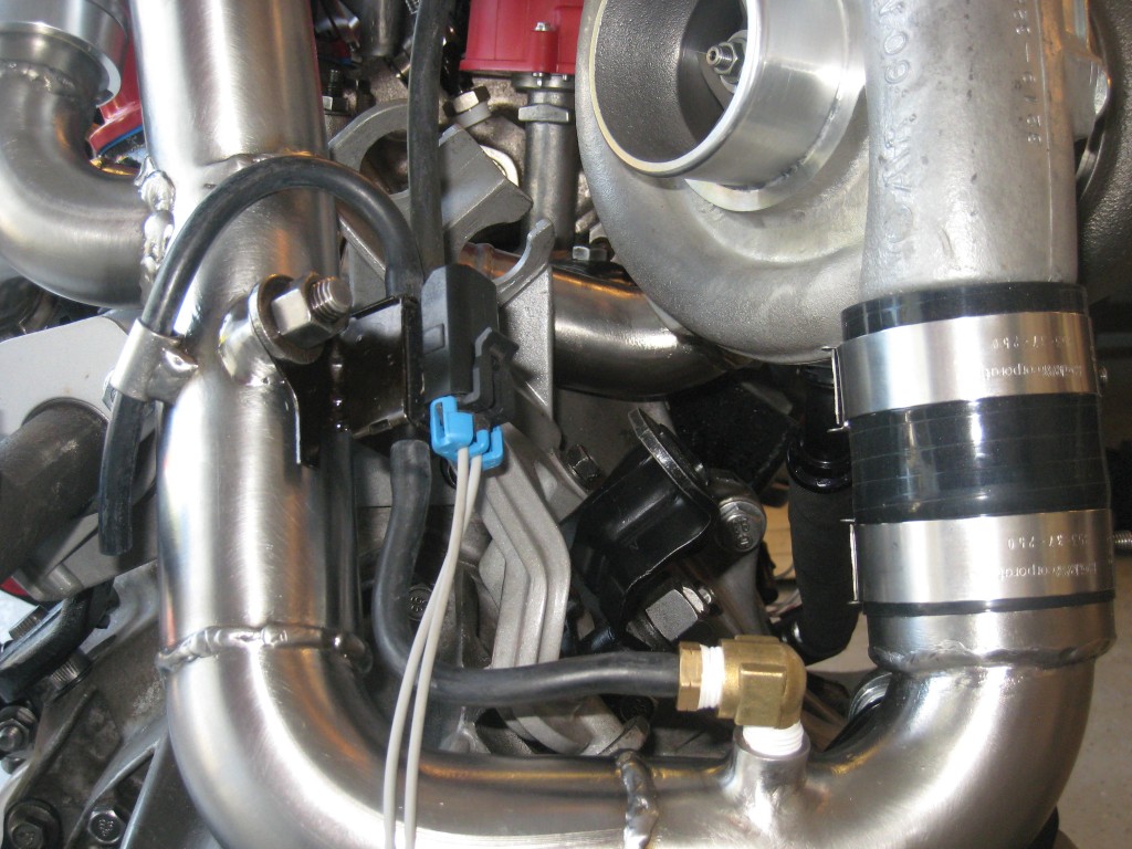

          | I finished the air pipe linking the turbo's compressor outlet to the throttle body:

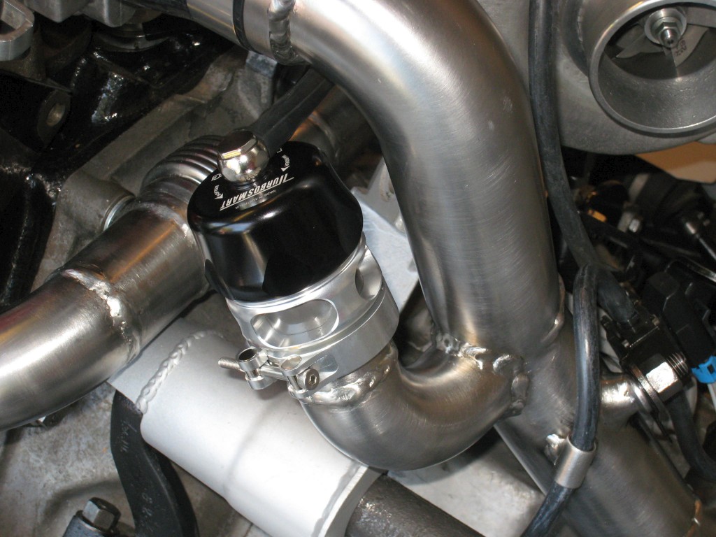

 I ended up going with the Turbosmart Vee Port Pro BOV. It's rated to be capable of venting 600 hp of compressed air, whereas the TiAL Q is rated at 1800 hp... which is overkill for my Fiero. The Turbosmart unit is physically smaller than the TiAL piece, hence I decided to go with the more compact, easier-to-package solution:
 Here is the GM 3-port boost control solenoid (used on the Syclone/Typhoon). This will be computer-controlled, allowing the computer to increase the boost pressure beyond the wastegate spring setting:

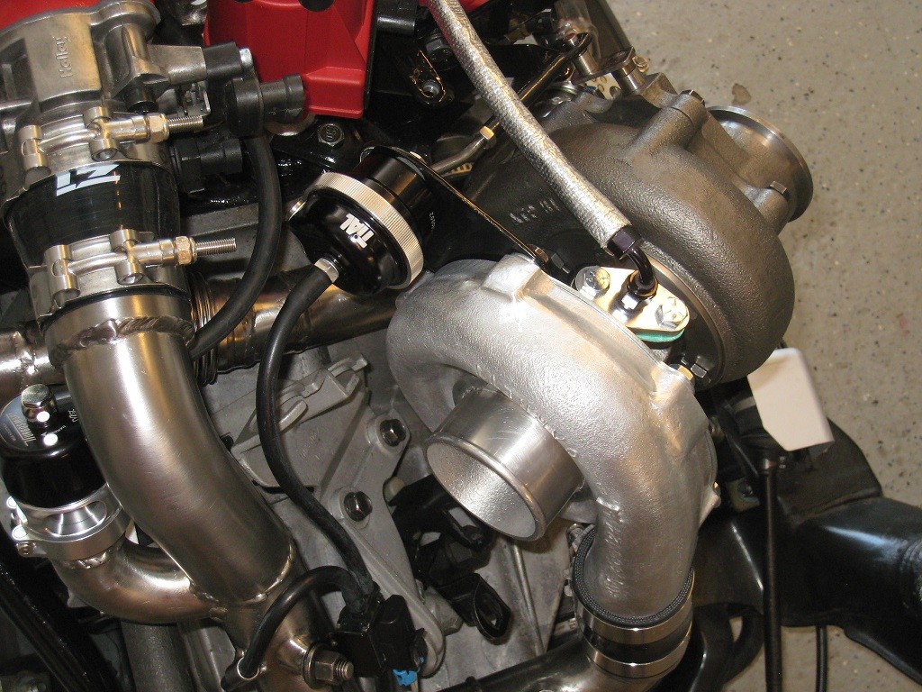

          | I installed the TiAL MVI 2.5 wastegate actuator.
 Its opening pressure is configurable by installing different combinations of springs:
 http://www.tialsport.com/do...vi2.5springchart.JPG
 I own the red and green springs, which should provide enough flexibility for me. I expect to fine-tune the boost pressure with the electronic solenoid, rather than by spring selection.
 I got the bent-rod version of the actuator, so that it would clear the compressor housing.

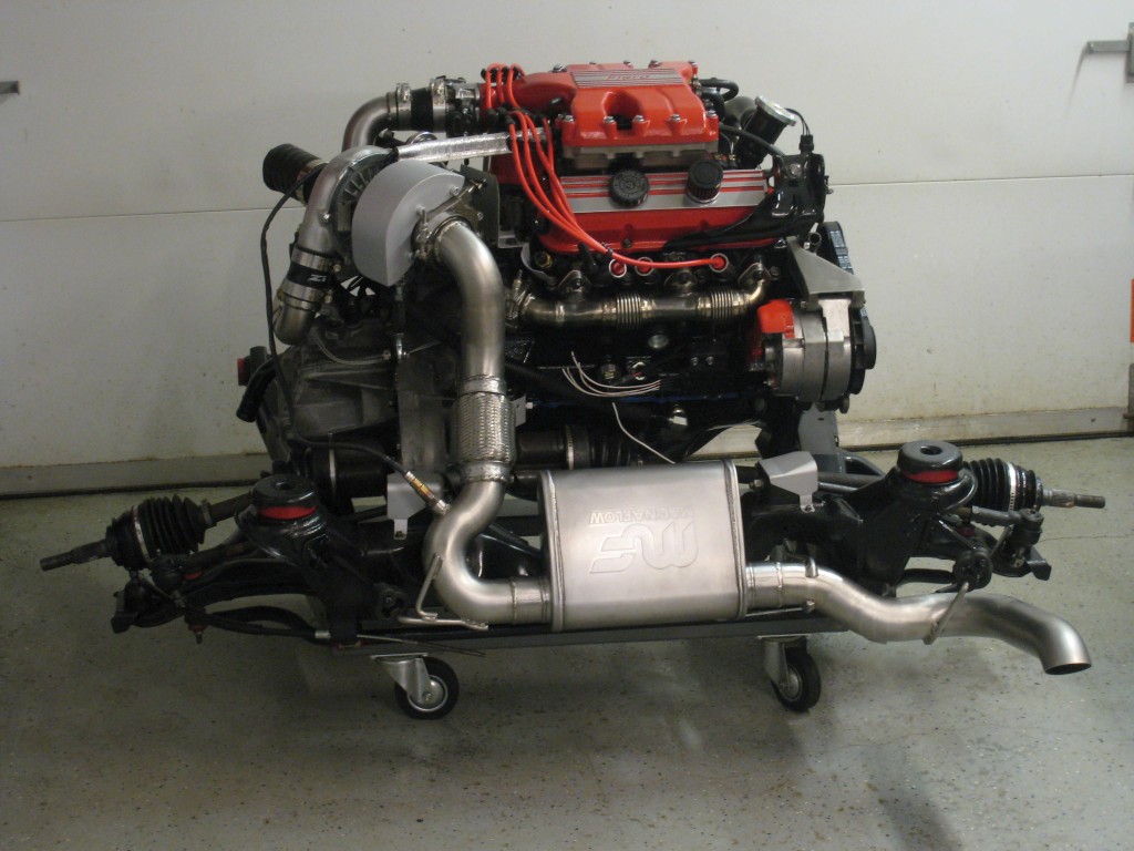

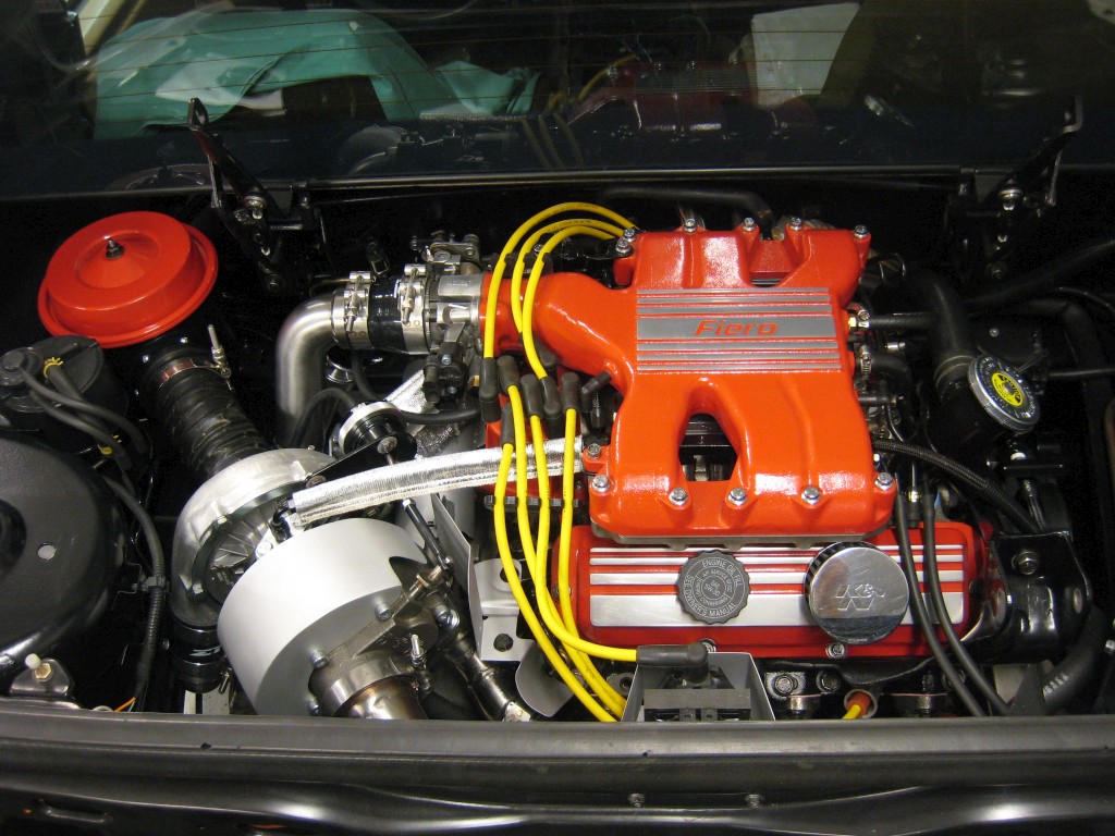

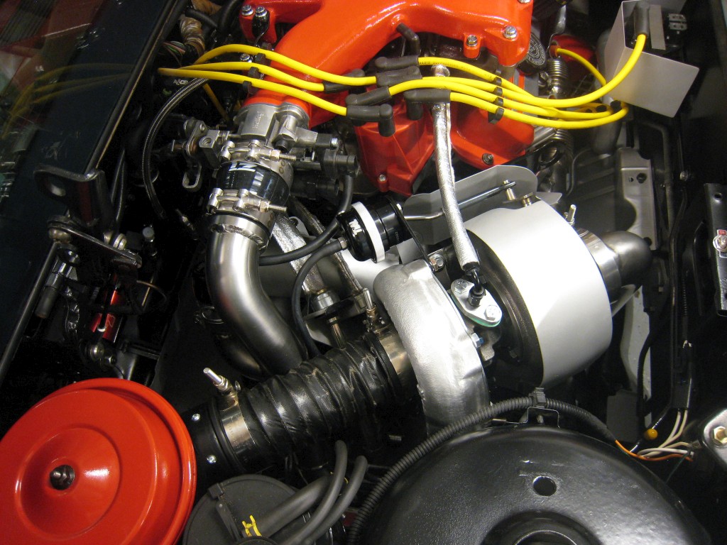

          | The powertrain is in the car (for the moment), and everything seems to fit.
 The main steps remaining before driving the car are to fabricate the exhaust piping from the turbine outlet all the way to the exit, and lastly tweaking the wiring harness as needed.

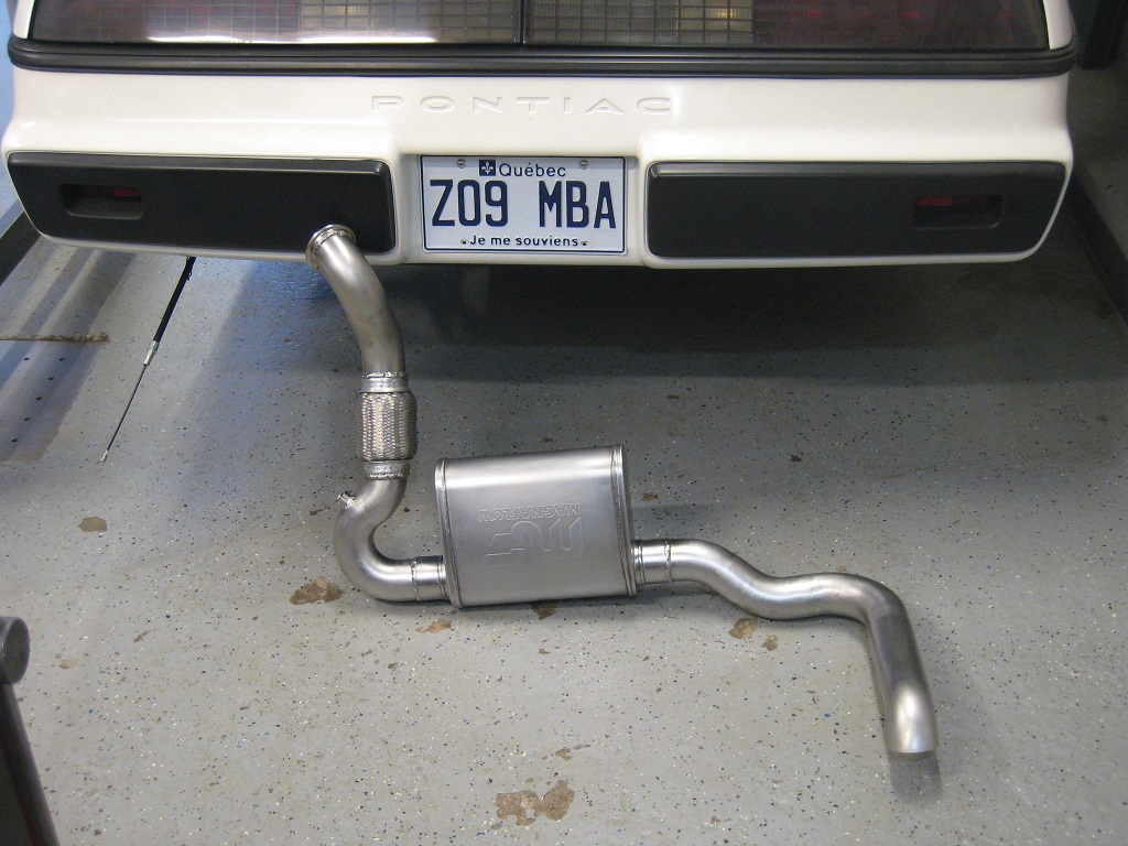

          | I have mostly completed the post-turbo portion of the exhaust. It's 2.5" all the way to the exit. I am using a Magnaflow muffler.
 Next, I must determine the exhaust hanger configuration.

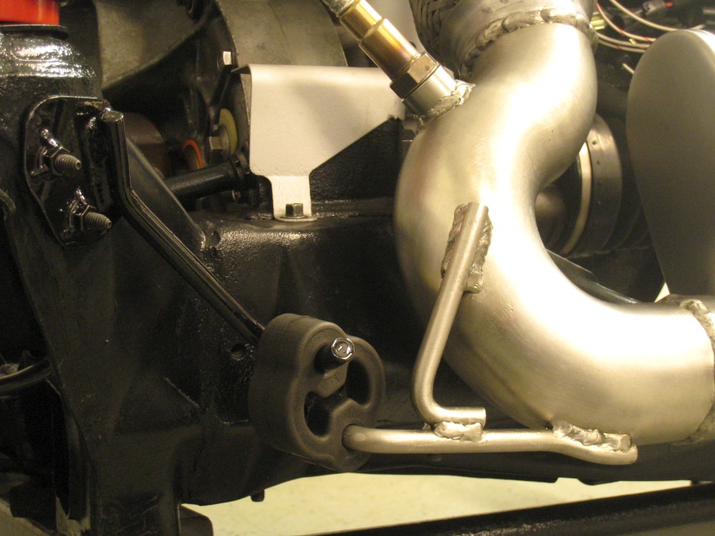

          | The exhaust is now supported from the cradle at three points:
 Here is a typical hanger. I'm using 3/8" round rods, bent and welded as required. The actual rubber isolators are from a Ford Freestar minivan:
