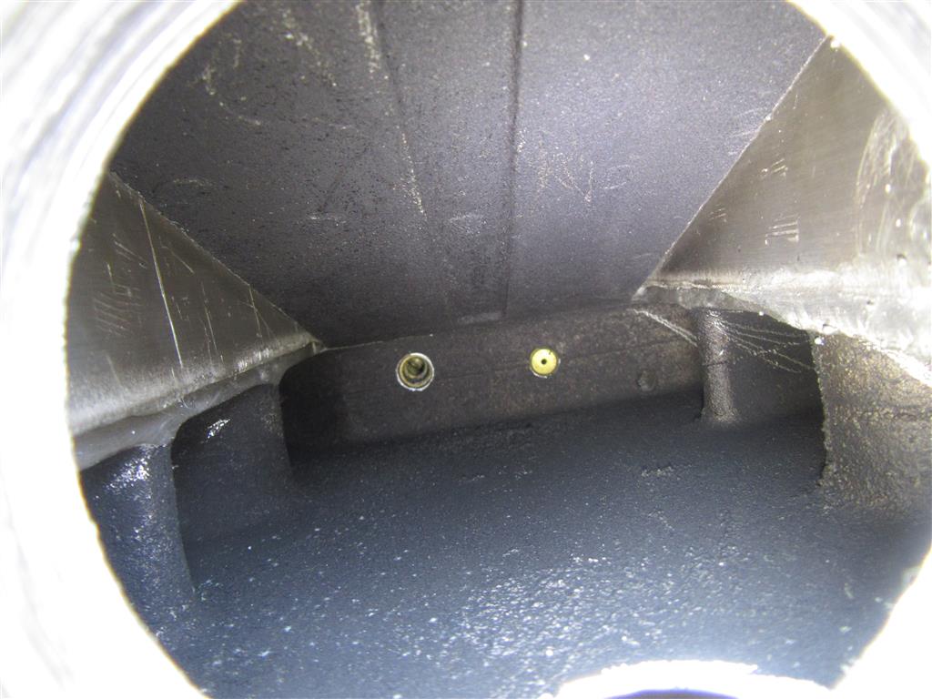

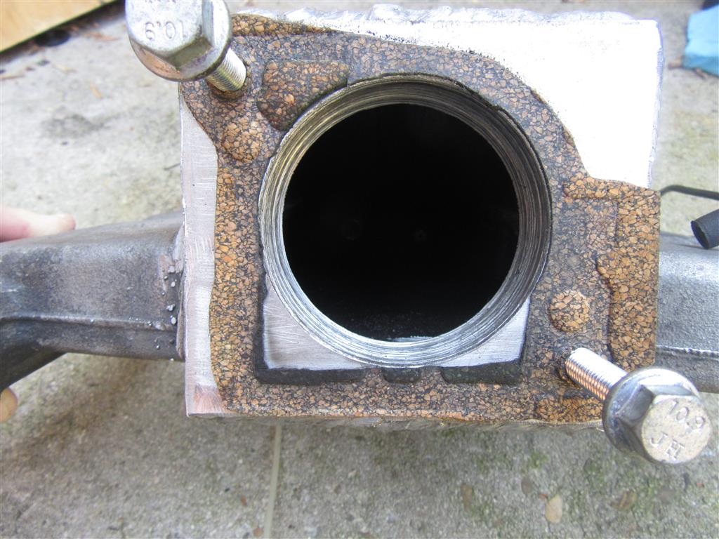

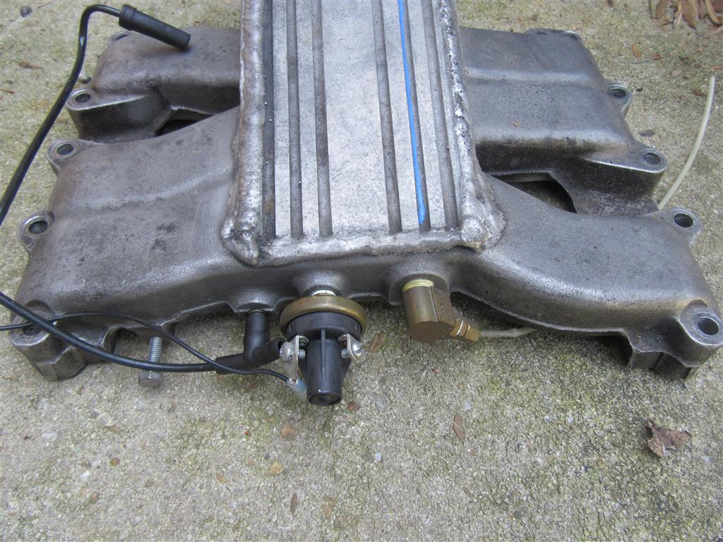

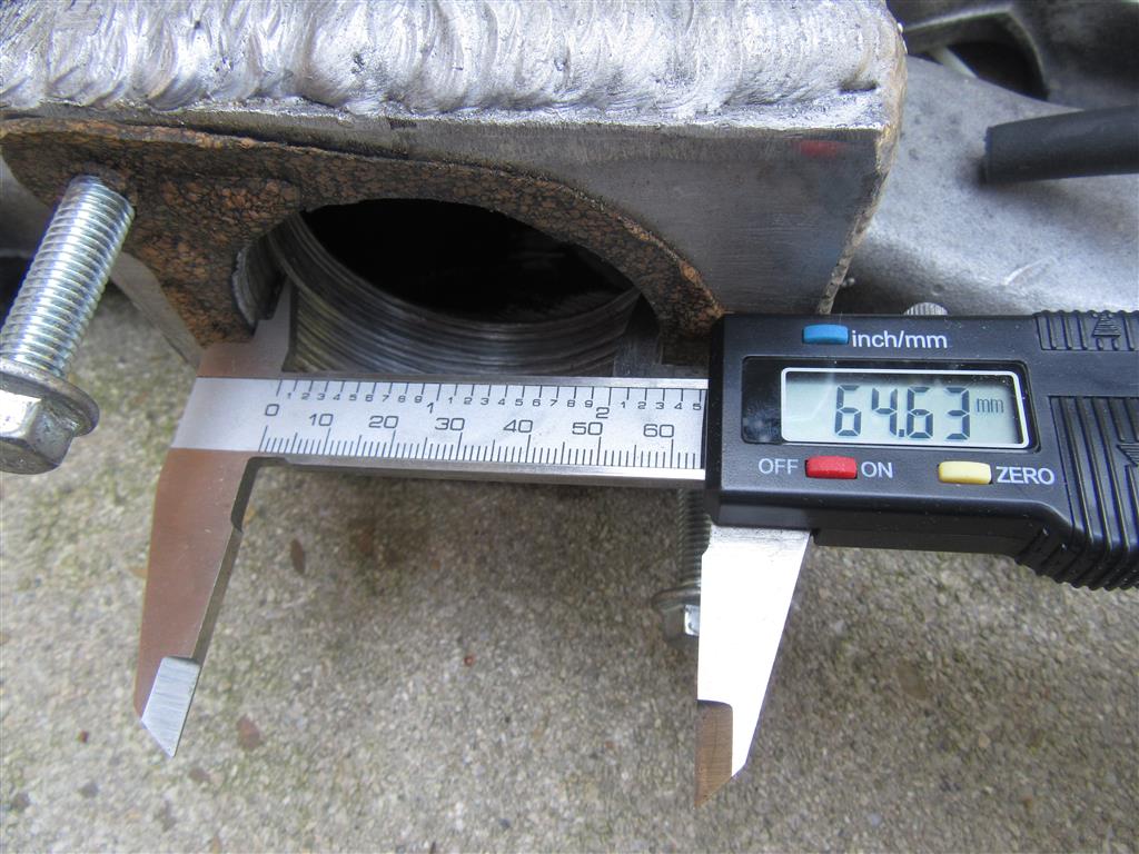

Anyway, this turbo intake has been ported out to 64+ mm. Of course you don't have to use one with that large of an opening. Here are some more shots. There's more than $50 in work done to it. Looks pretty clean inside.

Yeah that is a lot wider opening than I would probably use, I think I'm just going to go with the guy that Ray recommended and port a stock TB to 56mm and just make a gasket so that's a little more plug and play. I do wonder though if it will fit...

I replied to the one PM a few days ago, but that was the only one. For me I'd save the money and use a larger TB and replace the electrical plug and any hose fittings. Especially for a potential turbo later. The stock intake is about 51.9mm with this caliper. You'd have to drill and tap for the Fiero TB and it's pretty close to the opening of the intake throat to fit a stock TB. It's probably doable but it's not so difficult to change the TB itself and save the 150 and spend half on reworking to a larger TB.
Along with the TB I'd do the exhaust manifold mods and cross-over mods that people talk about.
