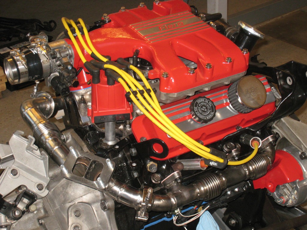

          | I finished the exhaust up to the turbine inlet. I am using the stock log manifolds, but with bellows in between the ports. With the bellows, each segment of the exhaust can grow independently as they get hot, without developing undue stress. The same reasoning applies to the bellows in the crossover pipe.
 The bellows fit underneath the stock front manifold heat shield, provided that I hammered the AC compressor clearance bump flat. Since I don't have AC, no problem there.
 I'm using the Volkswagen exhaust port gaskets. They have a stainless steel exterior; looks like they won't blow out.
 The compressor housing is quite close to the shift cables, but I should still be able to install/uninstall them. I successfully tested this theory with the engine+cradle in the car, as if I were doing it for real.
 The shift cables come really close to the crossover pipe; I'll have to come up with some sort of heat shield, in addition to the insulating sleeves that come on the Rodney Dickman cables.
 Right now the turbo is supported only by the exhaust. An additional support to hold the turbo's weight is presently in the works.

          | Here the turbo support is installed. Its function is to support the weight of the turbo, to take the weight off the crossover pipe.
 I'm using a RH-LH pair of 7/16"-20 rod ends threaded into a hex rod. Since the crossover pipe sags by 0.008" under the weight of the turbo, I simply crank up the rod-end assembly to raise the turbo's position by 0.008". The idea is to put the crossover pipe into its "zero-stress" position.
 I was inspired by seeing many 80s turbo Formula 1 engines having this kind of setup.
 Honda RA166E: https://upload.wikimedia.or..._Collection_Hall.jpg
 Renault EF4: https://upload.wikimedia.or...n_Player_Special.jpg
 TAG-Porsche: https://upload.wikimedia.or...t_Porsche_Museum.jpg
 However, it's not because this design is found on race cars that it's suitable for a street car. I guess I'll see what happens.
