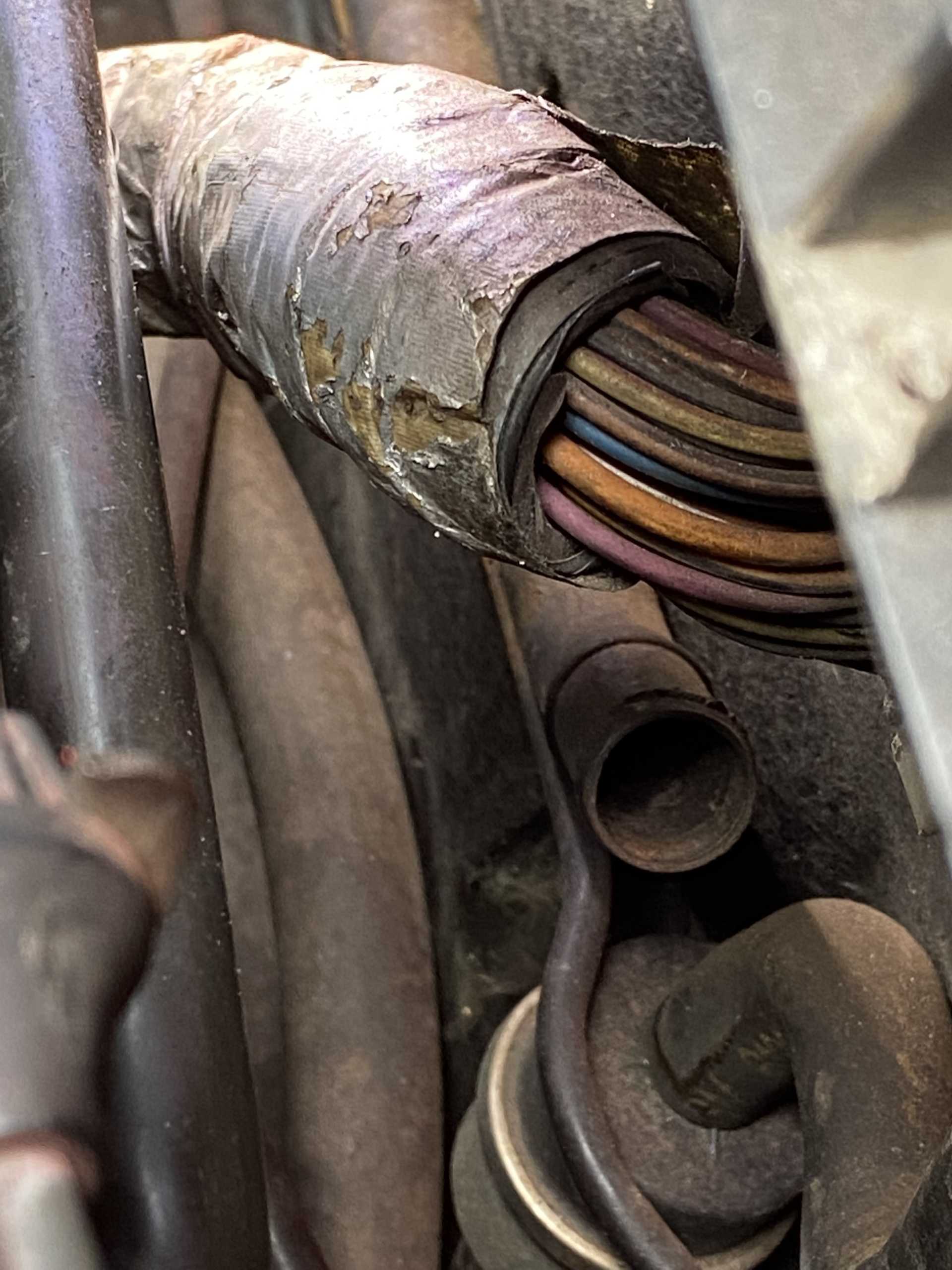

OCT 08, 10:30 AM
What is this tube thats open directly below the wire cluster? Its against firewall left side (drivers) in back of V6 engine, My mechanic says its nothing, just a vent, possibly fuel return vent.
OCT 08, 12:47 PM
| quote | Originally posted by 72and86:
About once a month someone asks about that pipe. Relevant thread Here.
Hopefully that pipe was disconnected from your air filter canister during the recall (and the canister hole plugged), otherwise that uncapped pipe has been allowing outside unfiltered air to enter into the filtered side of your air intake system all these years.
