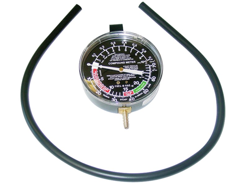

Yesterday a 0-100 PSI gauge would not even hit the 10 PSI mark. Guessing/interpolating it was 7 to 8 PSI. No clue as to the resolution of the low end of that scale, but repeatability was good.
I picked up what was 'supposed' to be a 0-15 PSI gauge from NAPA this morning. Despite the catalog describing the test set as 0-15 PSI it was actually a 0-10 PSI gauge. Bought it anyway and that pump I stuck in or the next replacement (if needed) better peg that gauge at 10 PSI+.

Here's a pic of what was supposed to be a 15 PSI tester!

OK...definitive PSI reading.
It's reading 2-1/2 PSI on the tank side of the disconnected inline filter line. That, to repeat, is 2.5 PSI. Weird that it is flowing so well, but obviously my 'fuel starvation' diagnosis causing the stumbling, rough running and lack of RPM's was correct.
