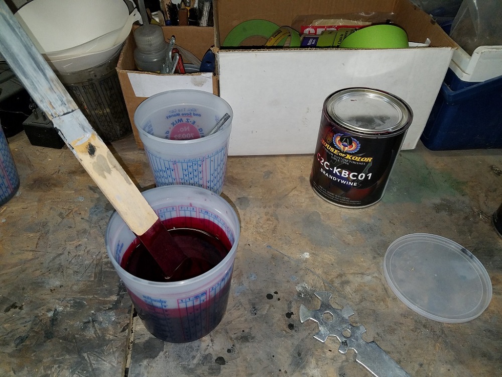

I got started but had to stop because it rained. To humid, the door skin started to blush on the corner. I fixed it with adhesion promoter. It still needs another coat.
hercimer01 AUG 19, 09:06 PM
If any one has had experience with blushing please chime in.
Edit: 09/18/2024
The blushing was the the KBC-01 base coat . The humidity was over 60%. Alot of the parts turned gray due to blushing. From what I had already known from furniture finish repair, you need to resoften the lacquer if you get a gray ring or spot due to heat or water. So I ended up spraying the parts in base coat (rear bumper cover and other panels) very lightly with BullDog Adhesion Promoter. You can see it in the next pic. It softened the base coat and the color came back like normal once it had a chance to recure slower.
