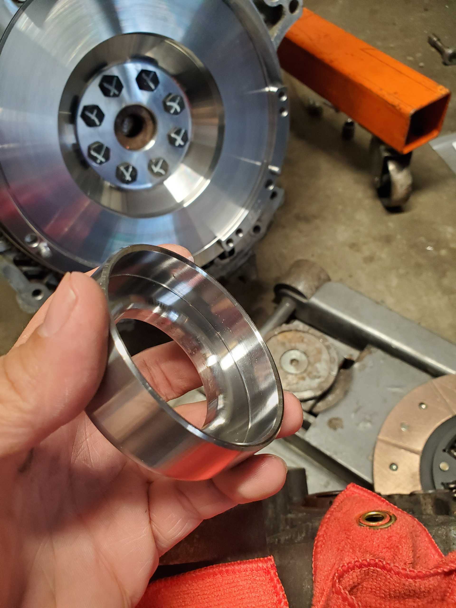

RandomTask APR 03, 07:55 PM
Thanks. I ended up ordering them from fastenal. They were M10-1.0 and I got them in 25mm length for my flywheel.
Next up, figuring out what the hell this piece is that came with the clutch kit...
