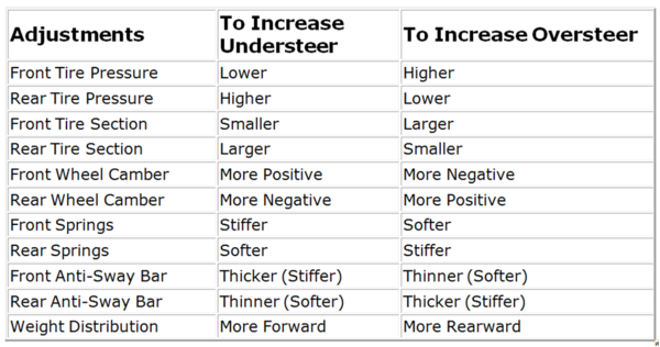

This chart below, put out by Quickor Suspension in the 90s, was part of the literature they put out to their customers. I was one of their customers then when they lowered my car and added a rear anti sway bar.
They changed the front anti sway bay at the same time, because the Fiero front anti sway bar was designed for a car without a rear anti sway bar. Anti sway bars should be a matched set that are designed to manage the characteristics of the front and rear to achieve the desired handling result. The anti sway bars for the front and rear will likely not be the same, but will be a pair of anti sway bars that will be designed to work together to stiffen or soften each end appropriately.
As the chart shows, tire pressure, camber, springs, anti sway bars and weight distribution all play a role in oversteer and understeer. Weight distribution is probably the most difficult to change, so is the logical choice to accept as complete as you start your suspension tuning journey. My Fiero weight distribution is 44% front, 56% rear. That is the same weight distribution that competition karts use as their baseline for suspension setup.
As far as how much negative camber you need, my opinion is that you need no more camber than necessary to keep the most tire contact in cornering. That can vary with tire width, stiffness, tire pressure, springs and suspension travel.
A little bit of internet research into the completion karts, will show that there is a bit of similarity in karts and Fieros, except size and body panels. Karts use shifting body weight to induce rear oversteer in cornering where Fieros do the same with off-throttle oversteer. If you add a rear anti sway bar that is too stiff, you will get quick lesson about off throttle oversteer.
