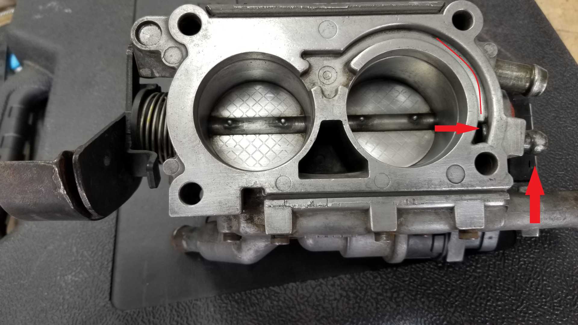

I must say, it was really easy to take the intake off. Job is definitely a 1 out of 10. I have a question regarding TB . The last owner had this fitting on the TB {RED ARROW and RED LINE) filled with gasket maker. I take it he wanted to block it off. It was drawing vacuum none the less.
Can someone tell me where this goes to and what it does? If one wanted to can I block it off again?

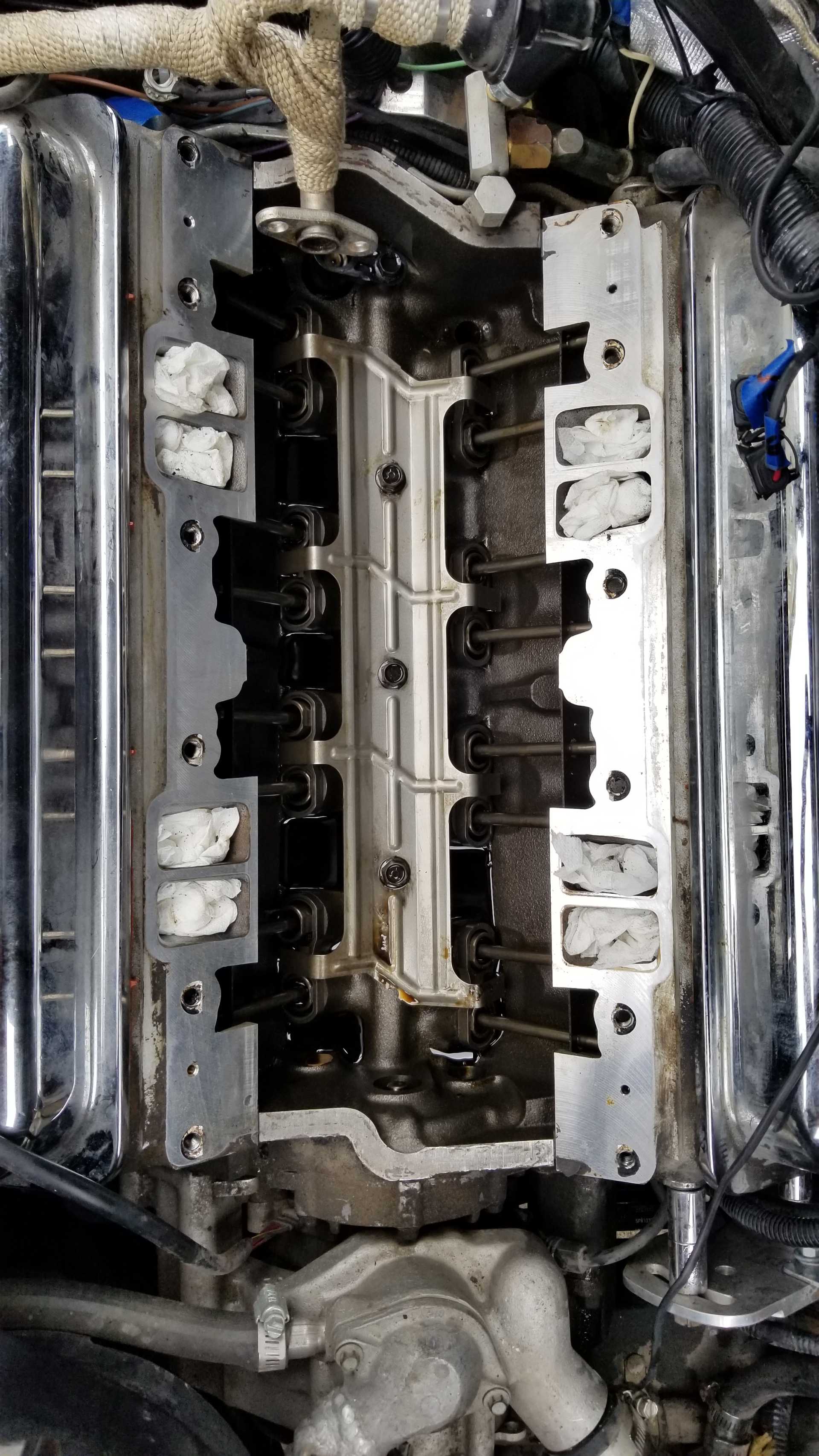

Here is a pic of the engine with intake off. Anything I should be concern with? Anything I should change now that the intake is off?
I used a burgundy scotch bright pad to clean the surface. Not sure if I should be using something else.

I believe that's for the EVAP control solenoid which needs a constant vaccum. The one on top (the bigger one) is for the PCV valve if I remember correctly. You can block it if you are not using emissions.

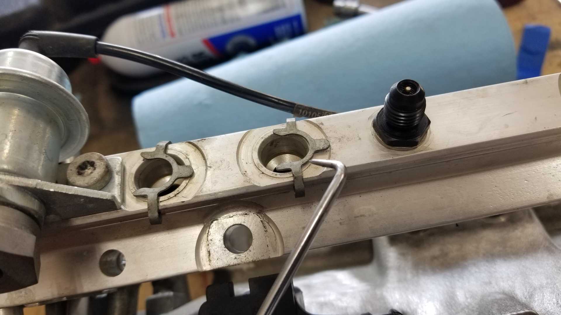

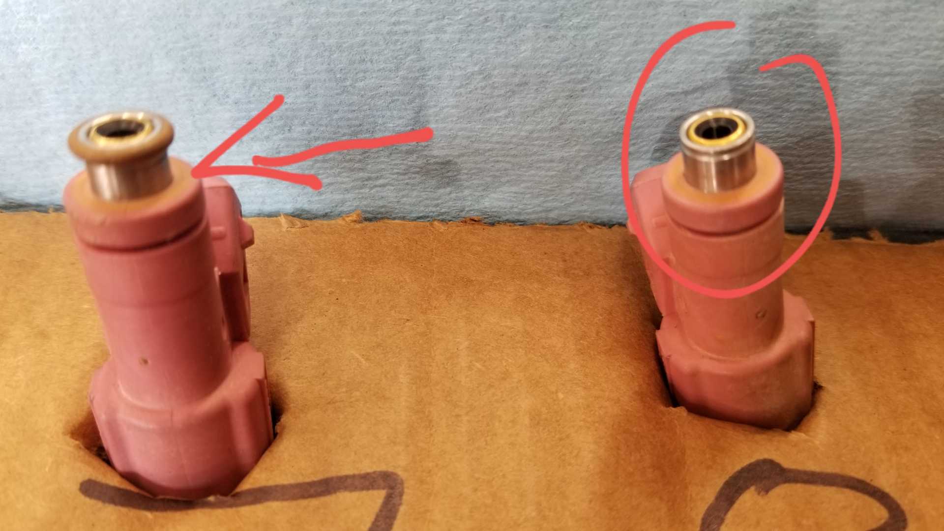

I'm missing an ORing on one of the fuel injectors and one is broken on another. Can I use green ORings on the injectors?
Also, I'm missing 6 of the fuel injectors retainers , are they needed?

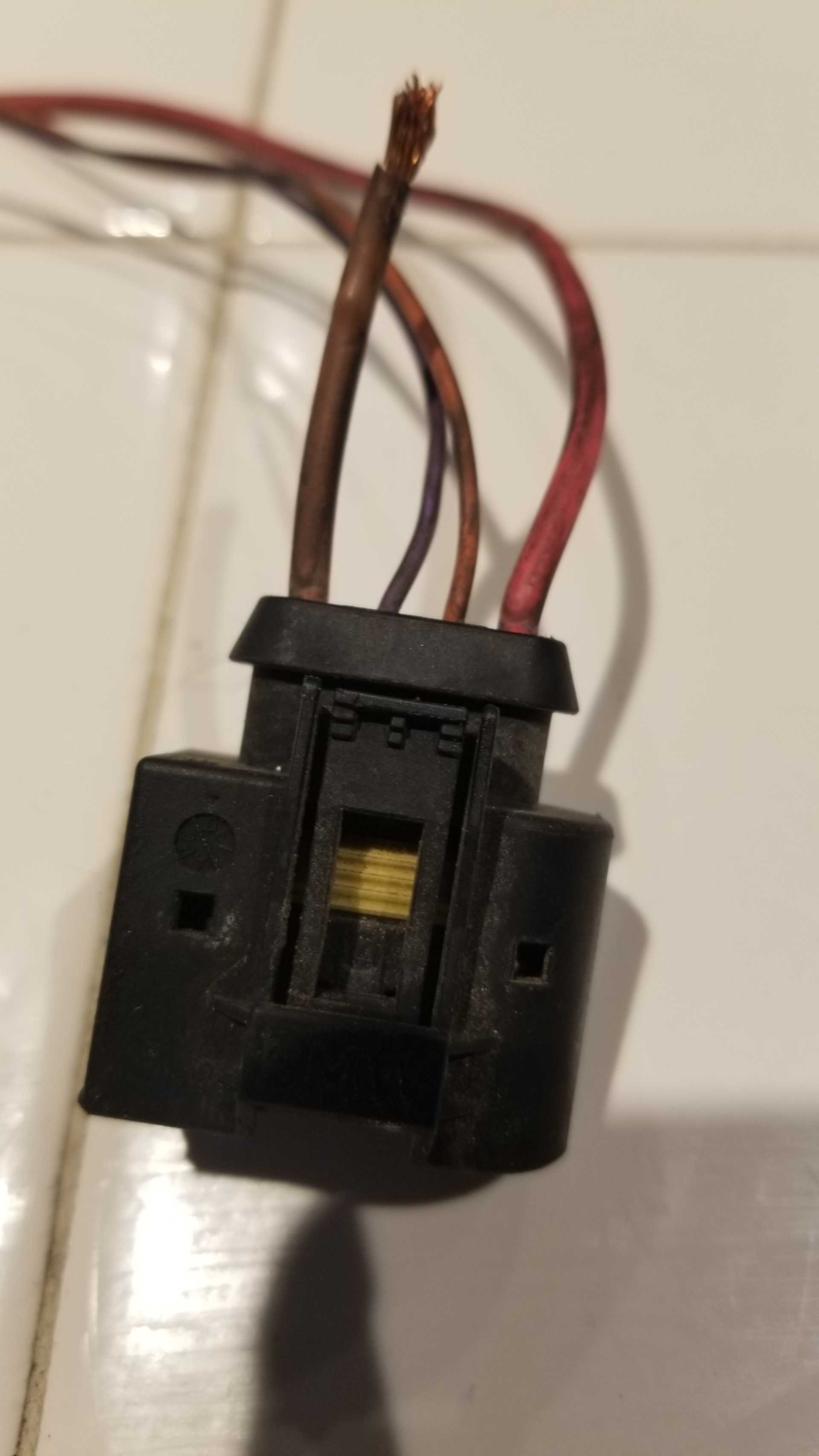

Can you tell me what wires go where on the BMW Pump?
I picked one up at the junk yard today... I have Red (+) and Brwon (-) and Orange and Purple >
I'd like to bench test is if possible. Thank you .[This message has been edited by str8maxn (edited 08-23-2021).]

Hello All, I was able to find a way to bench test it without a PWM controller.
From the BMW forums:
A description of each of the 4 pins and what each needs to see in order to control the pump speed. I
Pin 1 is battery voltage Pin 2 is PWM signal Pin 3 is a test/BSD signal Pin 4 is Ground
Supplying +12volts to Pin 1 AND pin 2 (and grounding pin 4) should make it run full speed after a 'timeout' period of about 3-10 seconds. To vary speed based on PWM input on Pin 2, you need at least 3ms of an inturrupted high pulse in order for it to awake the pump. Keep that in mind when you decide on the PWM frequency and/or your duty cycle percent's.
The pump was taken from a 2008 BMW 328i its model CWA200. Specifications: Name: "Pierburg CWA200" Operation voltage: 8-16 volts Weight: approx. 2.15 kg Current consumption: 15A (16.5A max.) / (approx. 0.2mA in standby mode) Nominal diff. pressure: 0.45 bar * Flow rate: ca. 116 l/min @ 0.45bar / 166 l/min @ 0.30bar Speed: approx. 4500 rpm Temperature range: -40°C – 128°C (water) / -40°C – 140°C (ambient) Protection: IP67 FYI- used pump was only $20.00. I also ordered a generic PWM for another $20. I saw someone testing this pump with it and looks like it will work just fine.[This message has been edited by str8maxn (edited 08-23-2021).]
