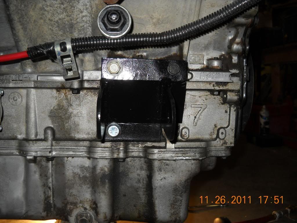

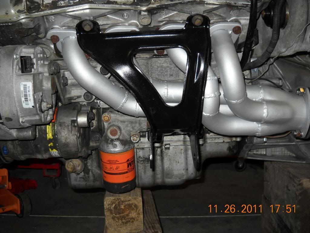

I got the motor mounts done and here are the pics. By the way, the header is the first one I ever built. I know the tubes are unequal length but getting to fit behind the original motor mount was a pain. I not trying to get every HP that I can but I think it will be better that the stock system. Next will be the other header then I will mount the engine/trans on the cradle hopfully for the last time.

what's with the date stamps on your pics??? ------------------ there's a Group on 60degreeV6.com for us 660 Fiero owners!

Its a mix if old pics, new pics, and two different cameras. I don't think the date was ever set on the one.
