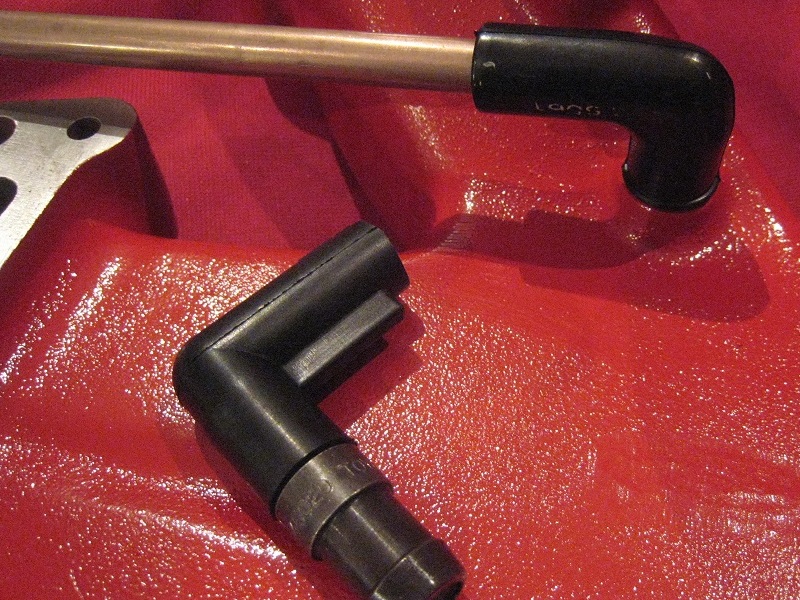

I tried two elbows: Dorman 46024 Dorman 47029
At the top is a modified (just shortened, the ends are original) stock Fiero 2.8 PCV assembly, for reference.
Either elbow works in either position (intake manifold or PCV valve).

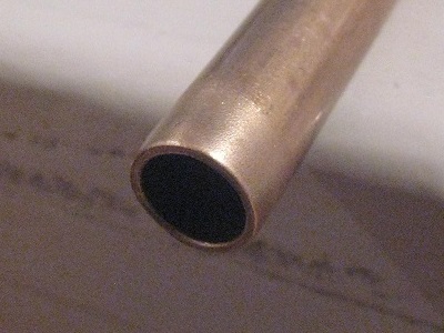

The elbows also fit well over a 3/8" OD cupro-nickel brake line. A plain deburred end results in a tight fit with either elbow. No clamp would be necessary.
I'm not sure which elbow is preferable. The Dorman 46024 is made of a stiffer rubber.
The Dorman 47029 is more supple; it stretches a lot more when attempting to pull it off a fitting. Could this result in tearing when I go to service/disassemble the elbow down the road?

The Dorman 46001 may also be a candidate to be evaluated.
EDIT: The Dorman 46024 has awful reviews on amazon. Splitting after weeks or months. 47029 and 46001 don't have much data. I guess no reviews is better than bad reviews?

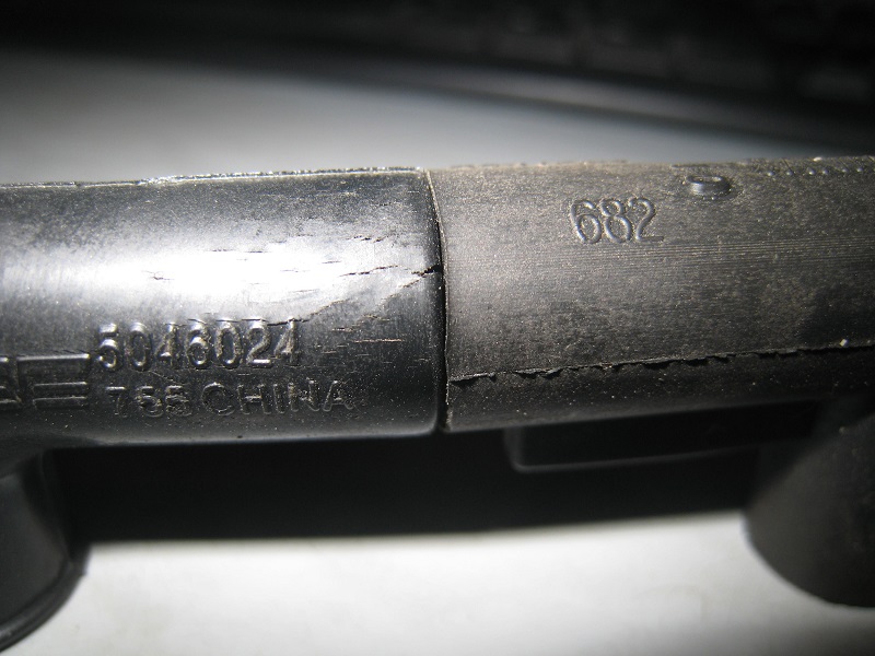

To follow up on this:
I placed these two elbows on the engine of my daily-driver Ford Ranger. Both elbows were slipped onto a piece of 3/8" OD tube. Dorman 46024 Dorman 47029
After 4 months of daily driving with the Ford, here is the result:
The elbow on the left was cracked. The elbow on the right (Dorman 47029) looked fine, so I chose to use it on my Fiero build.
I have two summers and about 12000 km on my Fiero since the rebuild, and the elbow has been holding up fine.
I recommend the Dorman 47029.[This message has been edited by pmbrunelle (edited 07-19-2021).]
