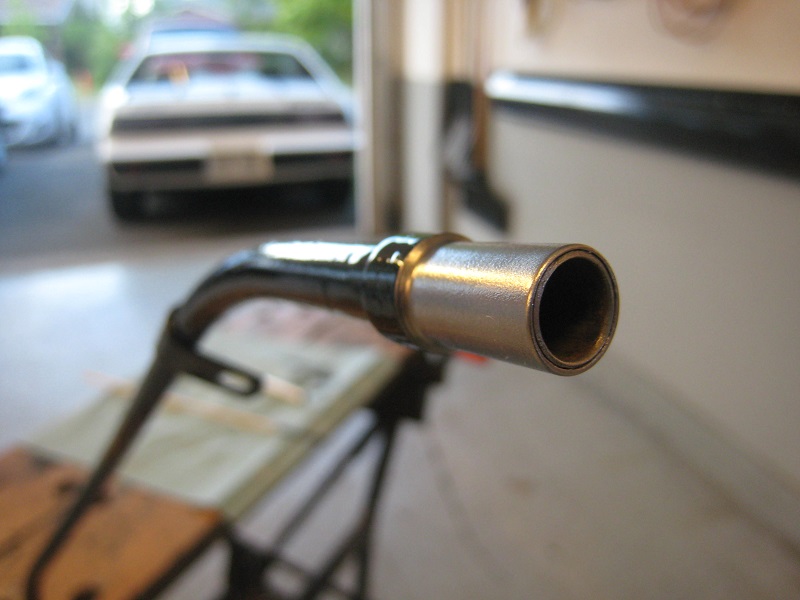

I have observed a hint of crankcase pressurization when I found the dipstick popped out of its hole (perhaps raised 1 inch) a few times, though it did sometimes that with the stock 2.8 as well. However, it seems like the rubber on the original dipstick shrank, and it was no longer making contact with the dipstick tube. So, I made a small sleeve, and that gave the dipstick enough friction to hold:
