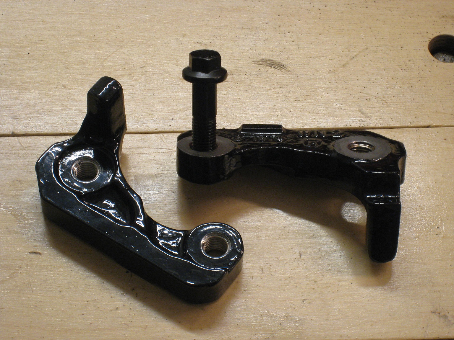

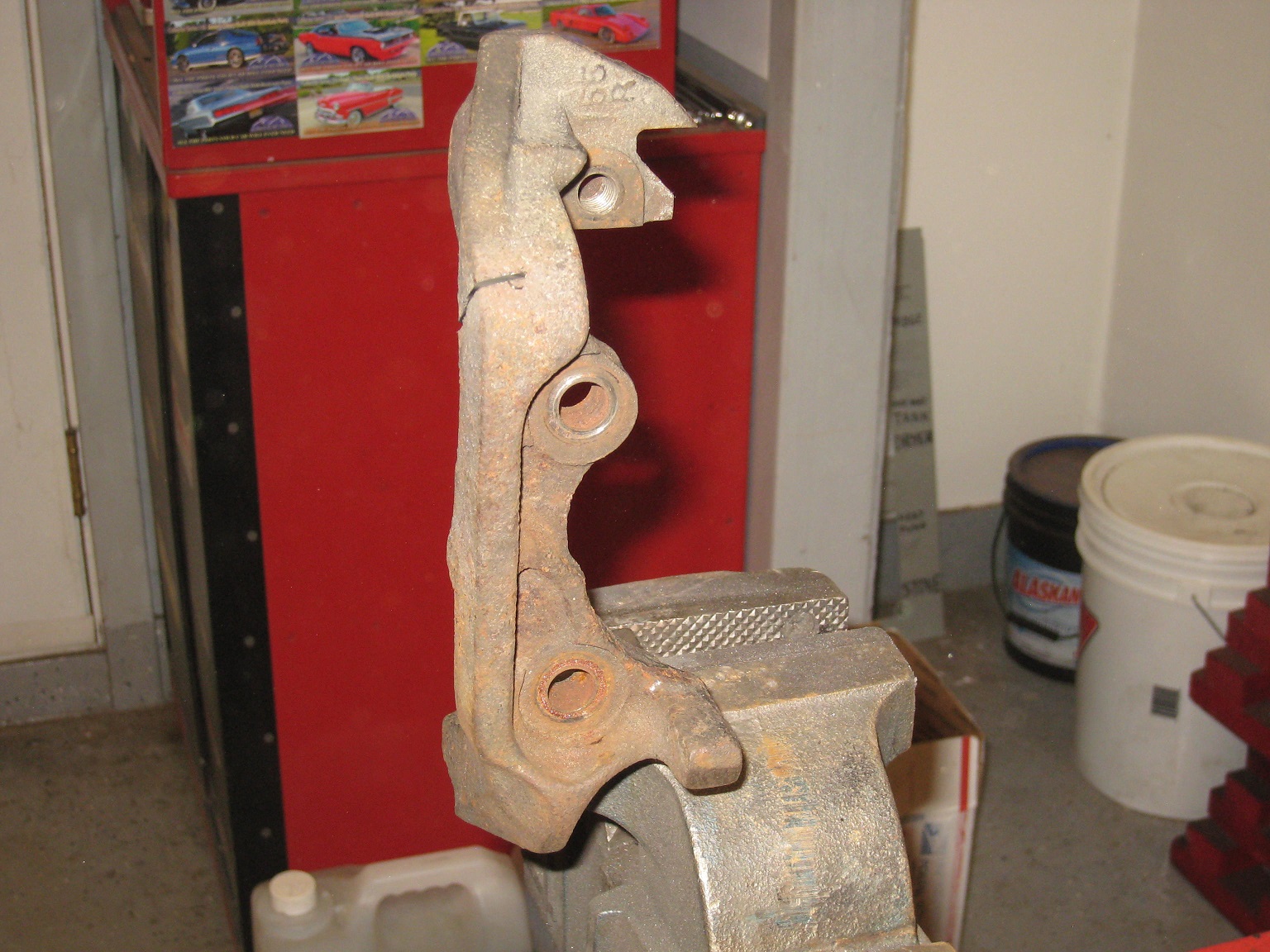

One issue was the lack of steering stops on my old car, so the calipers would end up hitting the shocks. Not the stuff of a premium car. Therefore, I decided to retain the steering stops of the stock caliper bracket.
My Zettner brackets (and spacers) will be attached to the outboard face of the knuckle (could be machined) using M12 bolts, threaded into the stock caliper bracket on the opposite side of the knuckle. This setup brings the advantage of more bolt stretch, though loosening wasn't a problem before.
Stock caliper bracket:
Chop-chop Mill Grind/Dremel Sandblast Paint Heli-coil M12x1.5 ...
Completed steering stop:
The stops weigh about 1 lb each. Kind of heavy for what they are; I could redo some from scratch out of aluminium, but for now, these ones will do.

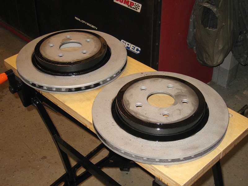

The rotors were still in good shape, so I decided to sandblast and reuse them. I painted the hats so they don't rust too quickly.
I'm debating if I want to drill/slot these rotors, or maybe just leave them plain.
For the moment I'm leaning towards slotting, because: I need practice on the semi-automated milling machine at work (don't want to get rusty) Drilling apparently leads to cracks, whereas slotting does not I already had drilled rotors on a previous car (my Saturn), so this would be different
I don't think I need slotting, it's more because it would be fun to do and give a subtle tuner car look. I would have to buy a small ball-nose mill for the job.

You can buy them slotted & drilled or slotted or drilled. For your application I'd leave them plain. I have the plain and with Hawks DTC 30 I have never had any brake fade. (I'm a very late braker) The only things I have are lots of dust and noise when cold, but not brake fade. That was with the 173WHP 2.8. Now with the goal of 350+WHP with the 3.7 I'm getting slotted and drilled rotors!

You really don't want to drill and slot the rotors yourself. They are cast parts with thicker and thinner spots. When you drill the holes, you are not removing the exact same material from every hole, which will lead to the need to have them rebalanced. When you buy drilled/slotted rotors, they have already been balanced post drilling.
