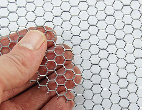

| quote | Originally posted by Patrick Here:
I have a 4-banger Fiero that had a heck of a problem with oil/blow-by entering the air filter canister. Oil would actually pool at the bottom of the canister. It was quite a nuisance. I had the valve cover off while doing something to the engine, and I noticed that the valve cover was baffled where the PCV breather tube plugged into it. However, this hollow chamber was obviously failing in regards to separating oil vapor from the rest of the crankcase gases. So I used a strip of metal hexmesh and folded it back and forth about half a dozen times, and positioned it securely inside this baffled area. The crankcase gases now all had to go through this multi-layered mesh before traveling up the tube and entering the air filter canister. Honestly, the results were simply unbelievable! I now find no oil in the air filter canister when previously it was pooling and needed to be drained.
The hexmesh I used was similar to what is shown in this following online image. The holes are about 1/4" in diameter.

Perhaps you'd be interested in this...
[QUOTE]Originally posted by Patrick Here:
[/QUOTE]
I may try that. first things first, though.
