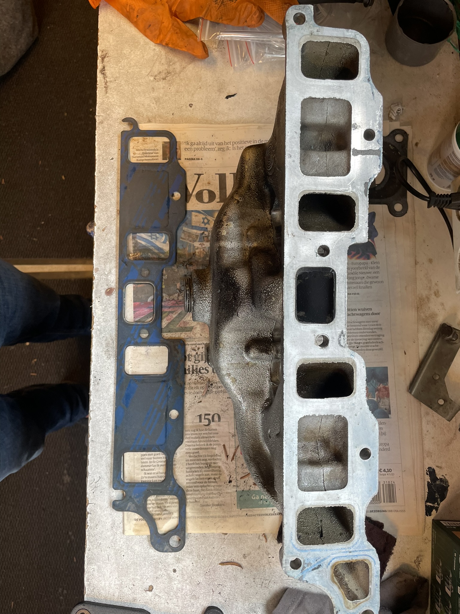

I mounted the gasket without any gasket pasta so there is maybe a reason for leakage.
When i came from work this afternoon (because when the car drives it rides lovely) i took the carburator and the whole manifold from the engine.
It is very diffucult to see if the gasket is been leaking to be honest. Carburator gaskets are allright i think and the EGR bracket gasket looked ? ok.
Tomorrow i buy proper gasket pasta and put everything back on and then it has to be ok i think.

That image is quite helpful, as it rules out those Nothing "holes" in the center of the head as being some sort of open ports.

But yeah, I suspect you simply have a vacuum leak somewhere, and hopefully an application of Permatex Aviation Pasta® (or equivalent) to the gasket surfaces will resolve the issue.[This message has been edited by Patrick (edited 05-22-2024).]
