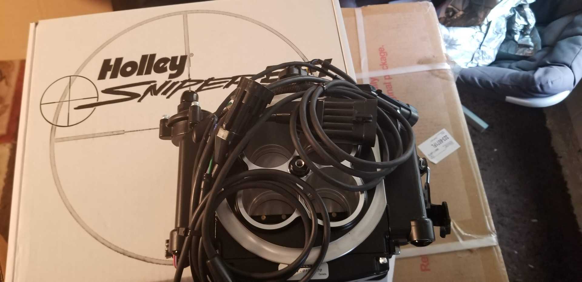

This is a VS Racing 78/75 that I bought a few years back to turbo my 6.2 LS truck with. That project just sorta never happened.
So, hey! Let's take a turbo I bought for a 5000lb truck with a liter more motor and put it on a 2700lb car! Great idea right? Right.
Well, I haven't actually done that yet.
See, the FiTech that came on the car can't read into boost, can't control timing, and it's VE table is 3 cells wide by 3 cells deep. Not exactly the pinnacle of tuning ability...
Here's where the irony sets in. One of the reasons I used to convince myself building the SBC was a neat idea was that I wouldn't be spending an extra $1000 on a Terminator-X.
So I spent $1800 on a Super Sniper and Hyperspark setup instead.
This thing reads 2.5bar, has timing control, VE tables, fueling curves, IAT and CTS offsets, extra I/O, nitrous control and the same software as the Terminator. Cool.
Why not go multi-port? Well, I'm running out of room.
See, I'd like to keep the trunk, so the turbo will need to mount over the transmission. That leaves precisely zero room for an A2A or A2W cooler. I don't want to run meth injection. BUUUUUT blow through carb fuel atomization has been shown to be a VERY effective air charge cooler. The same effect applies to a throttle body injection system.

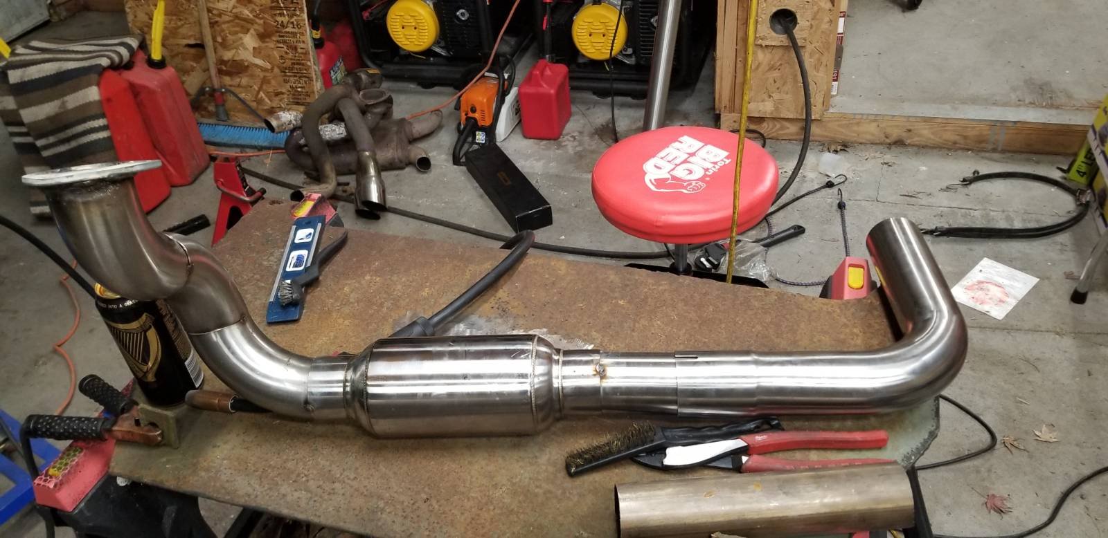

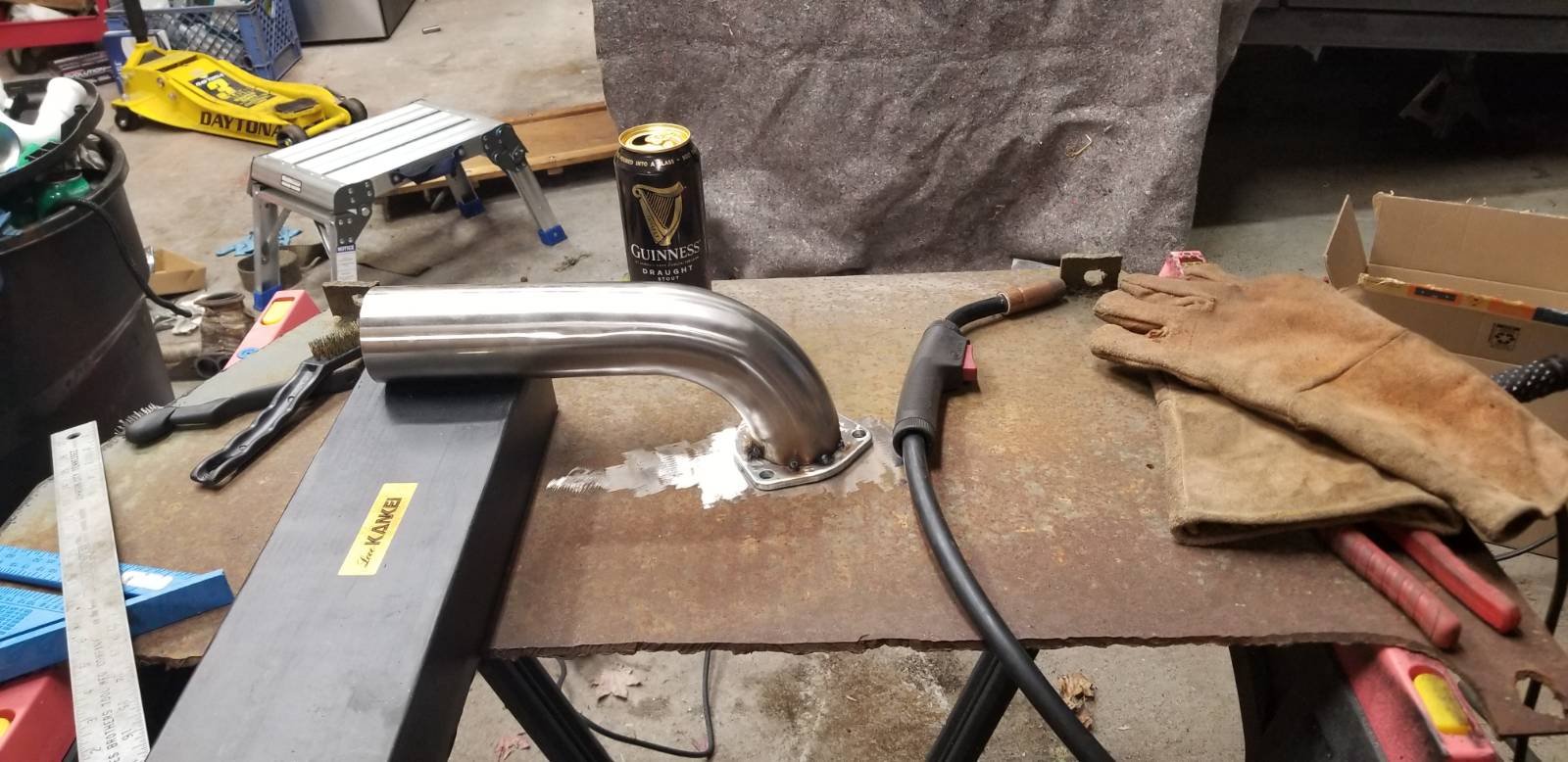

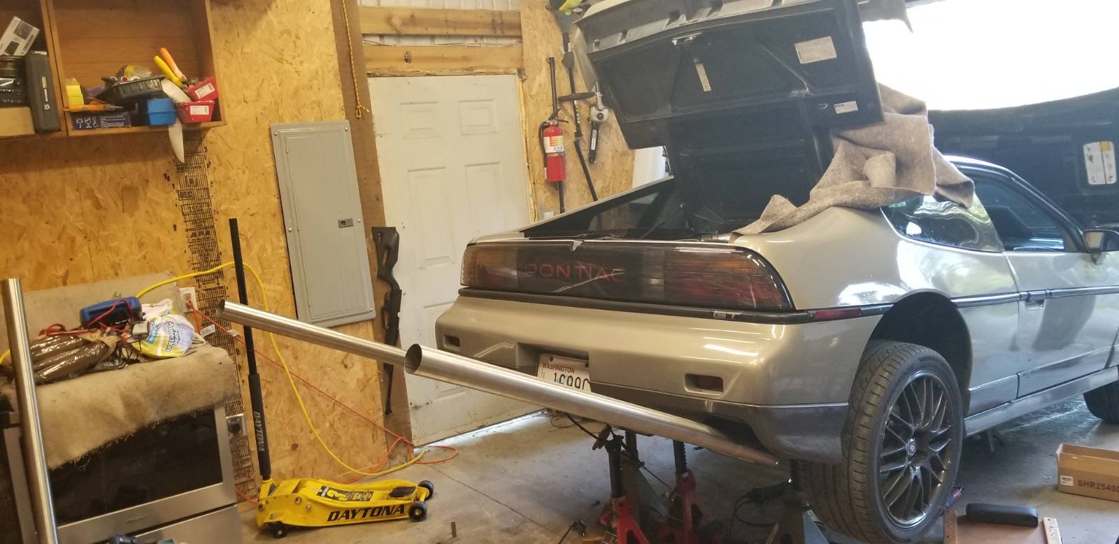

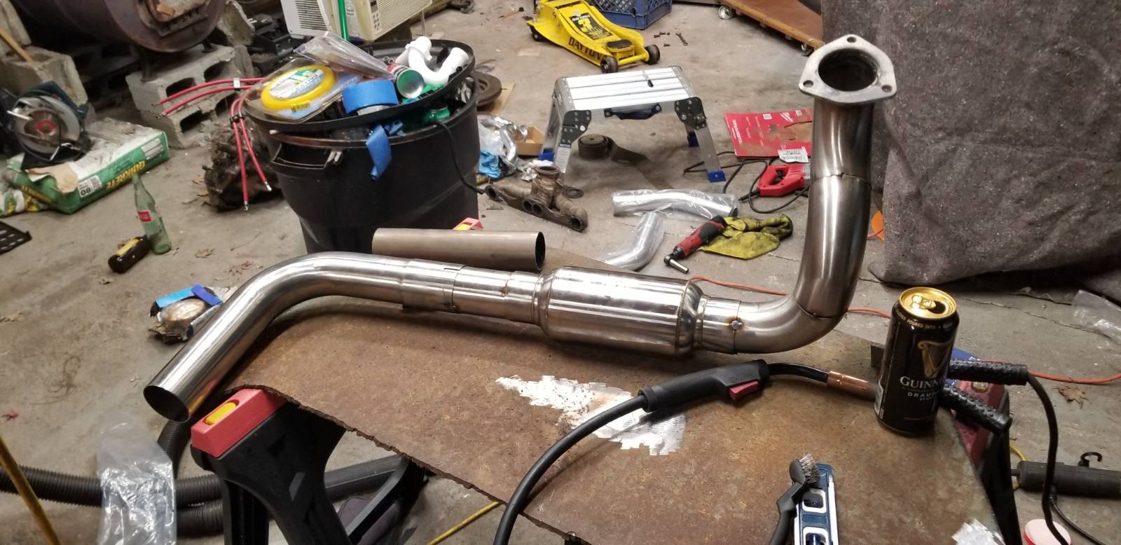

BUT. I did do something with that horrible, booger welded, overly bendy 2" exhaust.
I cut it off and booger welded my own exhaust on. With 2.5" mandrel bends and stainless pipe. It's true dual, mostly because it was simpler and there was no room for an X pipe.
Also replaced the leaking (surprise) Sanderson headers with coated Patriots.
Pipe alignment or Fiero Takeyari?
Yeah, I know. "But you'll need to redo it again when you turbo!" Oh well. It cleaned up the exhaust note quite a bit, and it's actually quieter in the car now. Mandrel bend kits are cheap on Amazon.

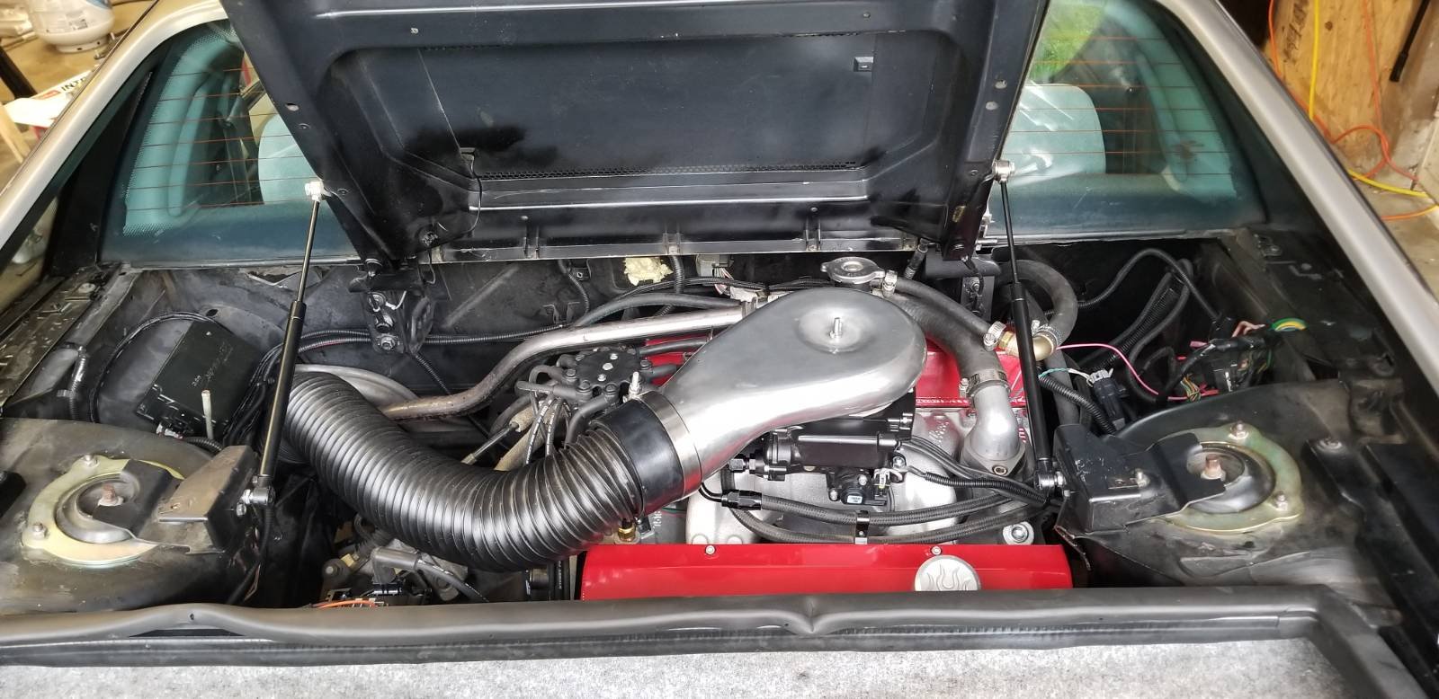

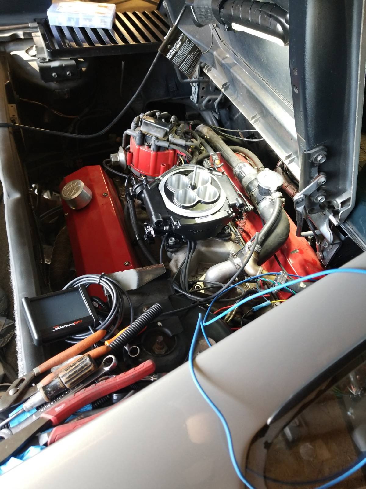

This is what the engine bay looks like these days. I did loom up those couple wires that are showing.

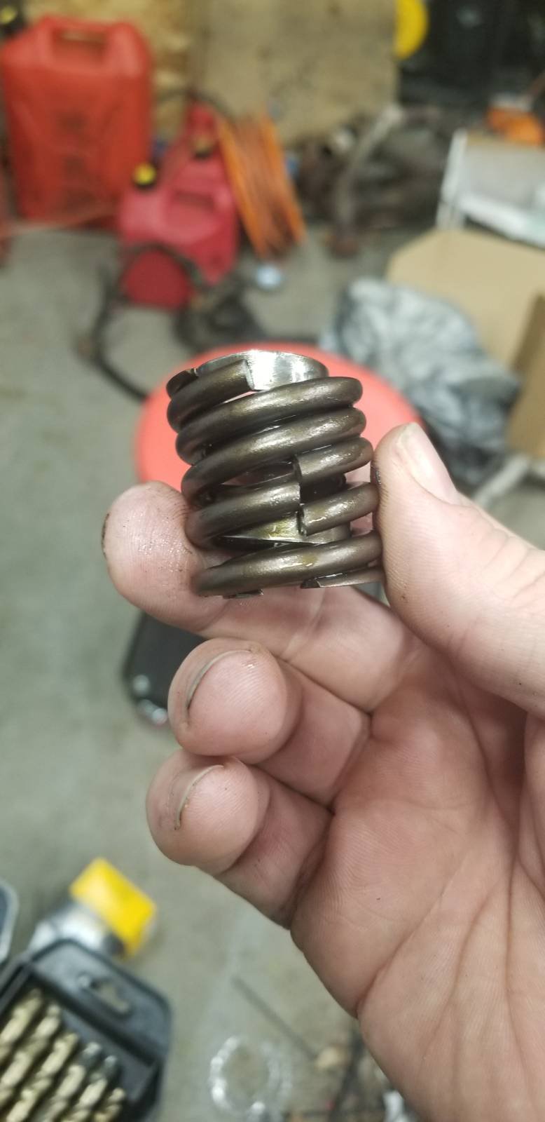

Well, it did at least. Last week just cruising about 2 miles from home, the motor started to load up a bit. I got it home without much drama, but it stalled the moment I pulled it into the shop. When I started it the next day it was pig rich and running super rough. I poked around thinking maybe the FPR was stuck. Turns out I broke the #8 exhaust valve spring.
The guy on the phone at Lunati assured me those springs were good to .600 lift and 6500rpm all day long. Maury Povich has determined that to be a lie. At least it held onto the valve.

Right? Lunati springs. Maybe they relabel General Tso's valve springs.

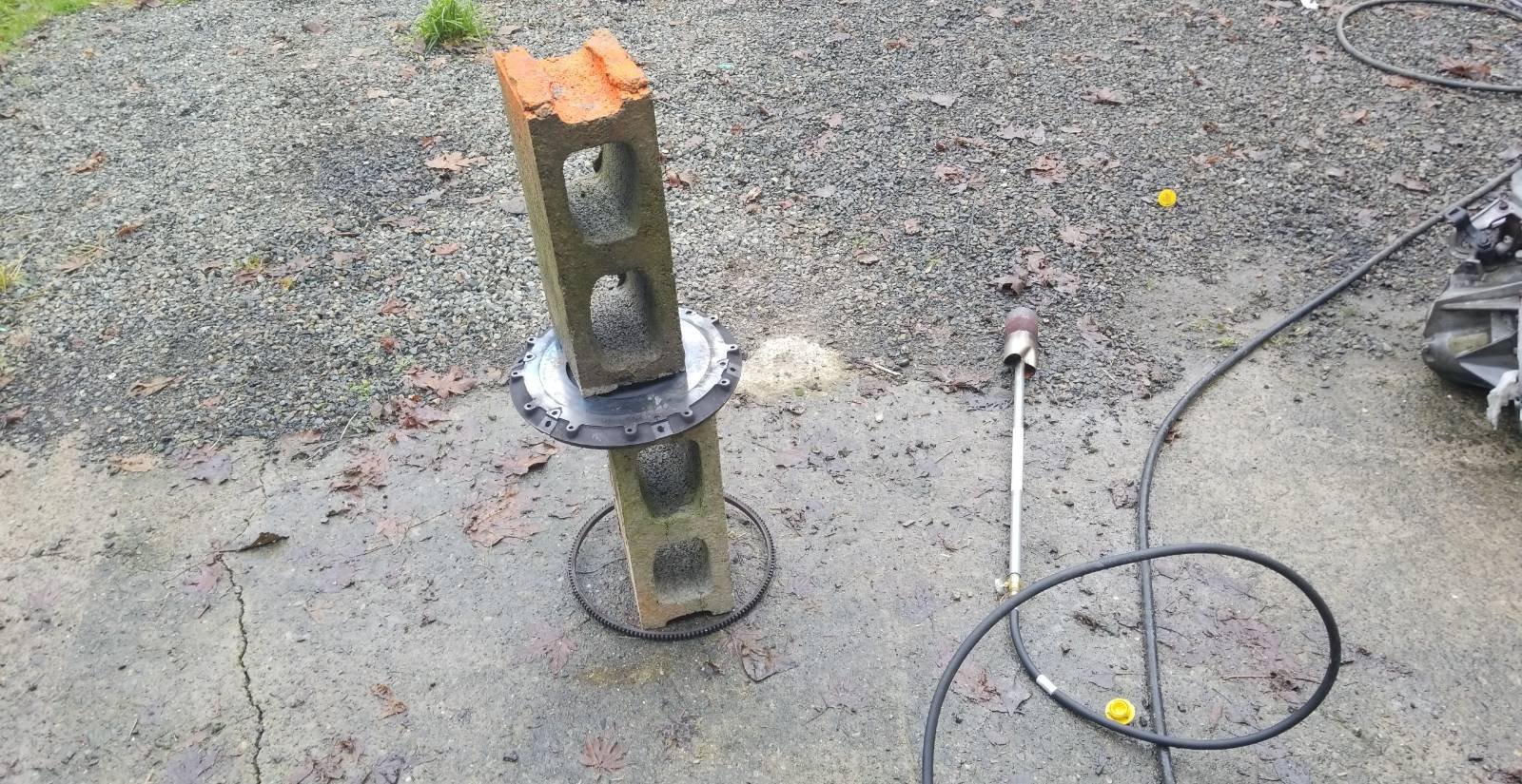

For anyone else wondering WTF I was talking about when I mentioned weed burners and flywheels, this is how you pull a ring gear. MAP and Oxy torches work too. But you'll be there all day trying to use a small propane torch.
