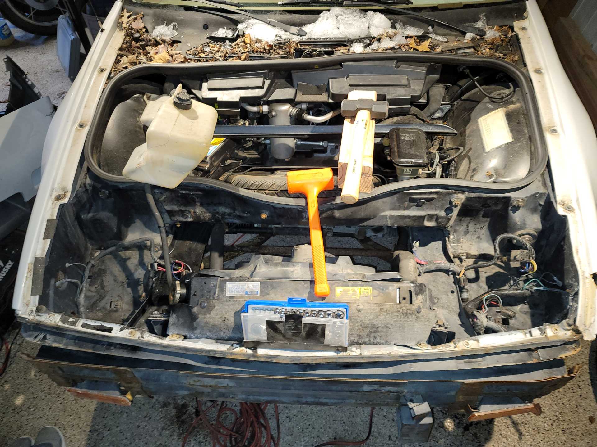

Update:
I started with the hydraulic ram / bash it with a sledge approach, and am pleasantly suprised by how much progress I was able to make in an hour or so.
I still need to fix the downward bend in the fender guard area under the front quarter. However, the headlights fit in the buckets again!
Next steps are more banging while enough "stuff" is on the car that I can see if the body panels are sitting well, then strip down the whole section and start welding to fix the seam cracks that opened up and to add some reinforcements to areas that "tin canned" a bit.
cle_fiero
FEB 12, 11:40 AM
Headlight bucket:
Whole front end:
