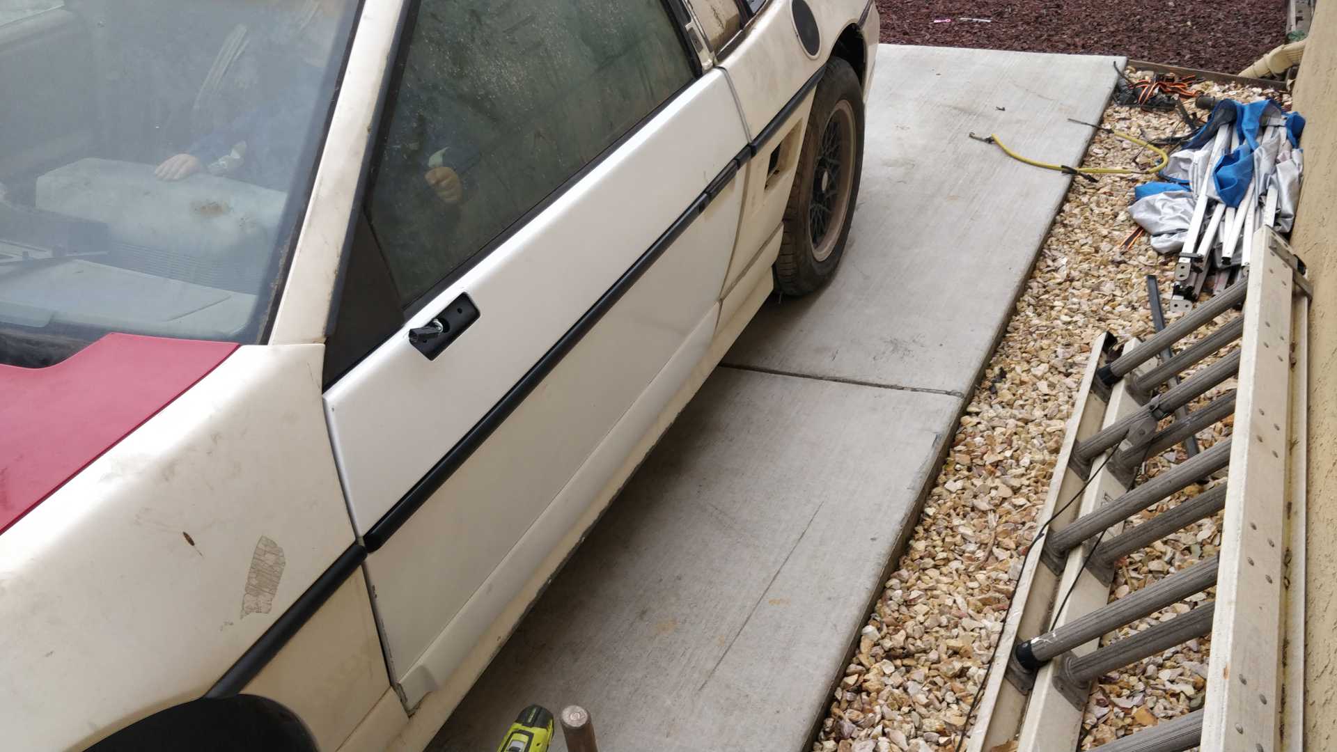

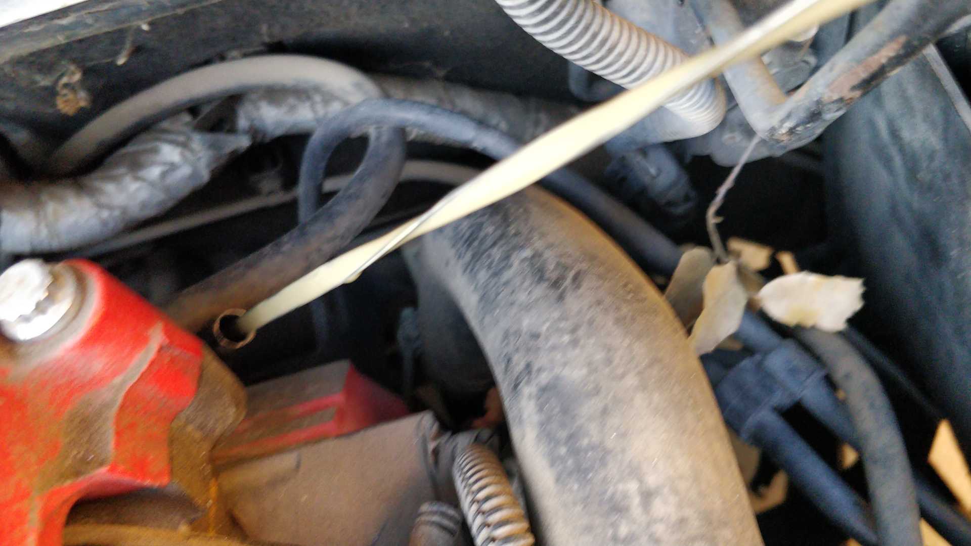

I crawled under the white GT today to inspect for forklift damage and found that along with the fuel line i already knew was damaged the heater line has been crushed flat the width of a the forklift fork. I know the car will start and run if I get gas into the rails. Im just a little overwhelmed as to what side to start on.

Heater line replace.

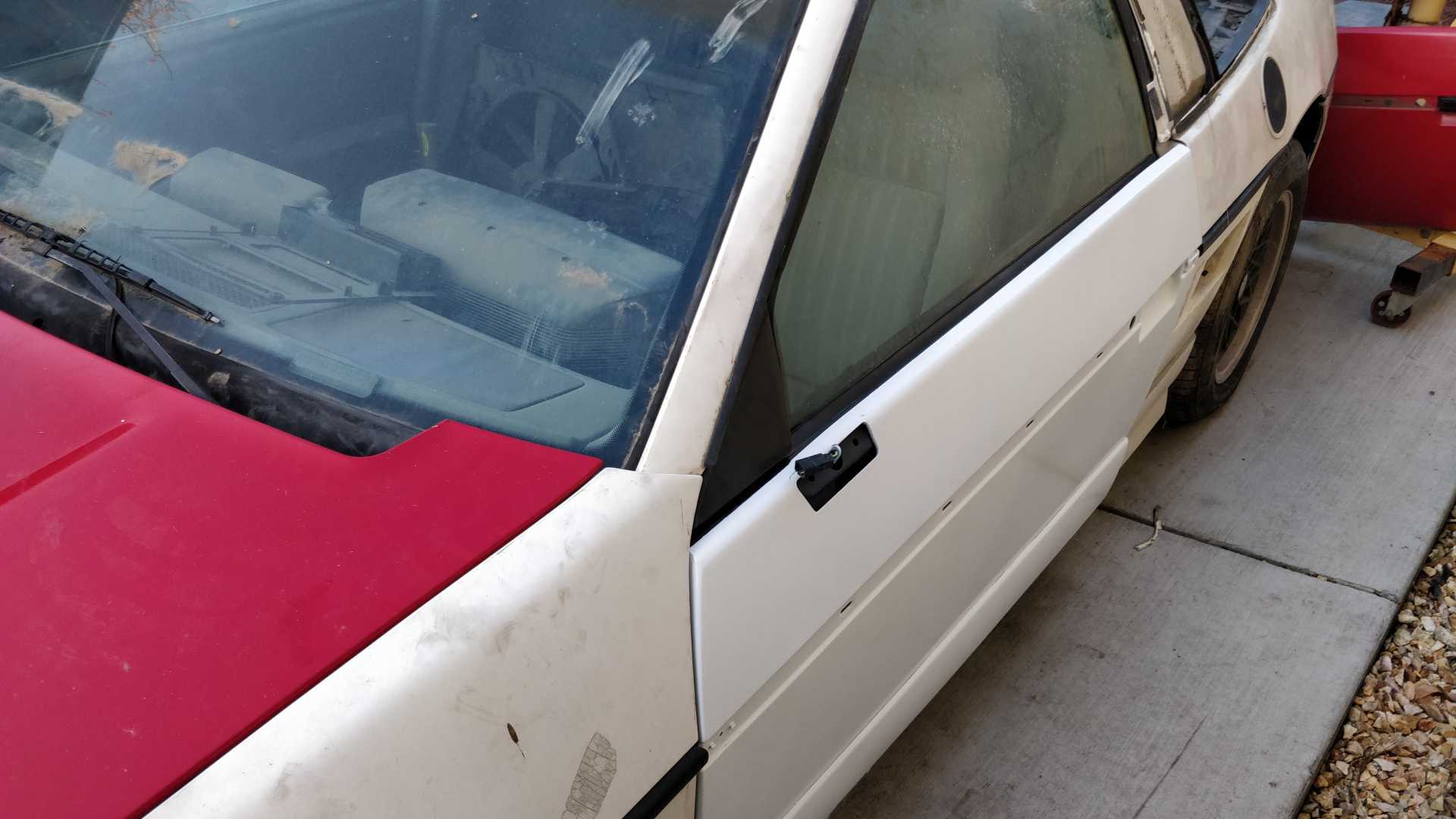

Saturday I worked on pulling down the Red GT more. I also tried my hand at lock smithing. I pulled apart about 5 door locks and rearranged the tumblers to make a matching lock for the replacement door. I also glued a 1/4 window back together... Im not sure if it's the best idea but will probably be ok until i want to drop money on replacements.
Today I pulled the Red GT down some more. I also painted a GT door skin i had gotten from wrecking yard.
I'm not sure if the car used to be that color or if the codes i used are off. Once i get some lock parts in (i had to order new spring retainers as i broke every set i tried to remove.) I will then attach the door skin.

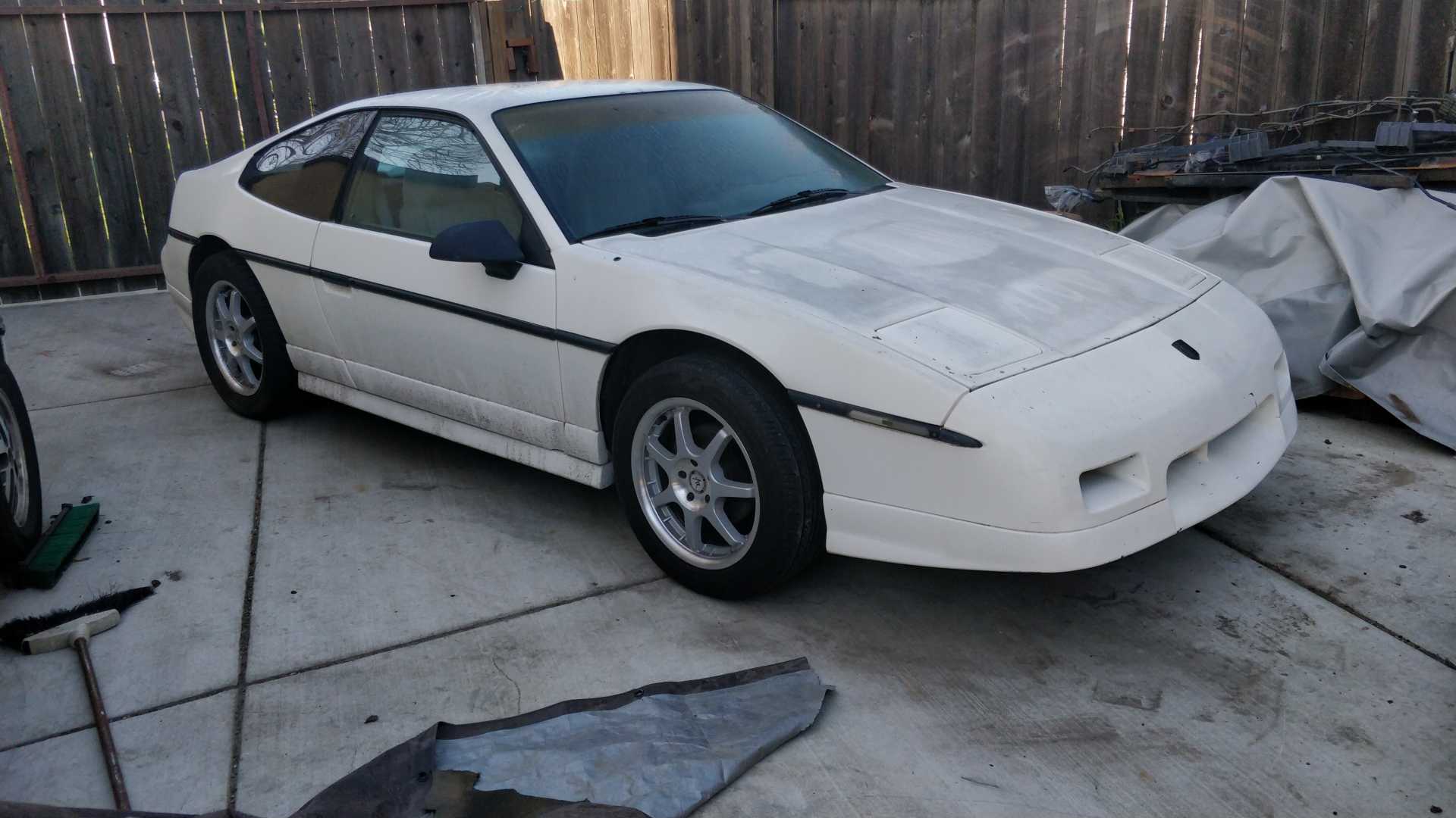

So I don't think i am going to start a new thread. But I picked up another White Wingless solid roof 88 GT with lumbar seat. This car is 5spd already but factory without AC. It doesn't have Cruze control, power mirrors, or power locks. This car has been a CA car all its life and is more or less rust free. The engine is hosed and the paint is not the best but the seats are not ripped.
At this point im debating what im going to do. I know this is only 1 of 271 GTs in 88 without AC. However I have always been of the school of "Well optioned cars" are typically most collectable. This plus the fact that the original paint is all done and the odometer is at 140k im thinking of adding options back. Also this all doesn't bode well for my original white GT as it has a good engine and a few options id like to swap. Plus the wife said i can't keep both
Id like to hear other thoughts.
Im thinking ill do an engine swap and wheel swap minimum. (I like the stock wheels on my original better)
