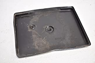

Oh, you mean that plastic shield that helps to keep heat off the battery. I thought you were referring to a plastic tray that sits under the battery, like a tub.

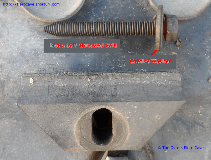

Put plastic block and bolt in but don't final torque the bolt. (some cars let you to pull/install battery w/o completely removing these parts but easier to remove most times. Plus can clean etc the bolt at same time.)
Find/make a "wedge" or tool to push the block tight to the battery.
then torque the bolt.
There is no "torque spec" for mounting hardware in FSM.
Needs careful tightening so won't move but don't go so tight plastic warps etc.
Also OE bolt is made for this job w/ most have a big thick captive washer.
The washer is so big it hinds most to all of the slot in the plastic block and even a lot of block too.
Many are missing the OE bolt and block won't hold right w/o the big washer to spread out the loads.

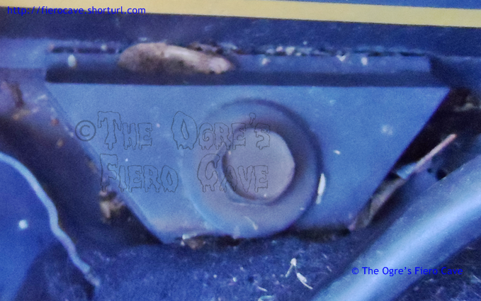

theogre MAY 25, 08:12 PM
Closeup of mounting hardware.
Is Not a "self-threaded" bolt tho looks like one. Just so fools won't strip the parts.
Plastic block doesn't mater which way up. Can be easier w/ smooth side up because washer may have trouble adjusting to battery case.
