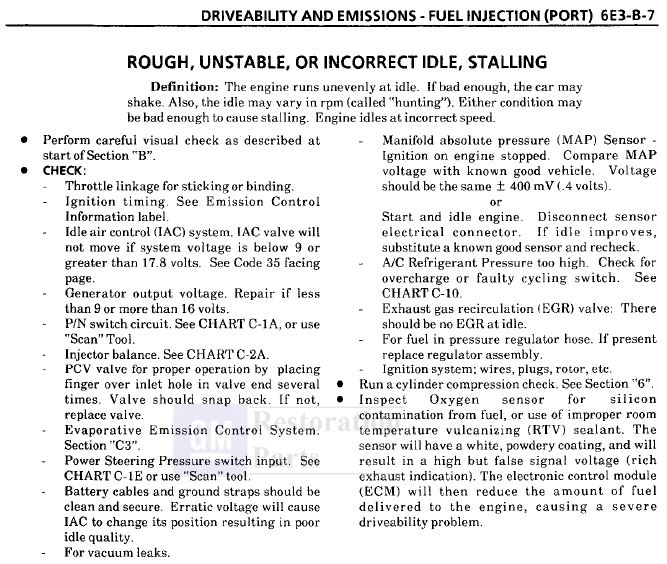

You may try disconnecting MAP when idle is rough as described here:
Wow a lot of great information, I guess tomorrow I have a lot of things to check, il get back to you on any results. thanks so much for helping me out!
