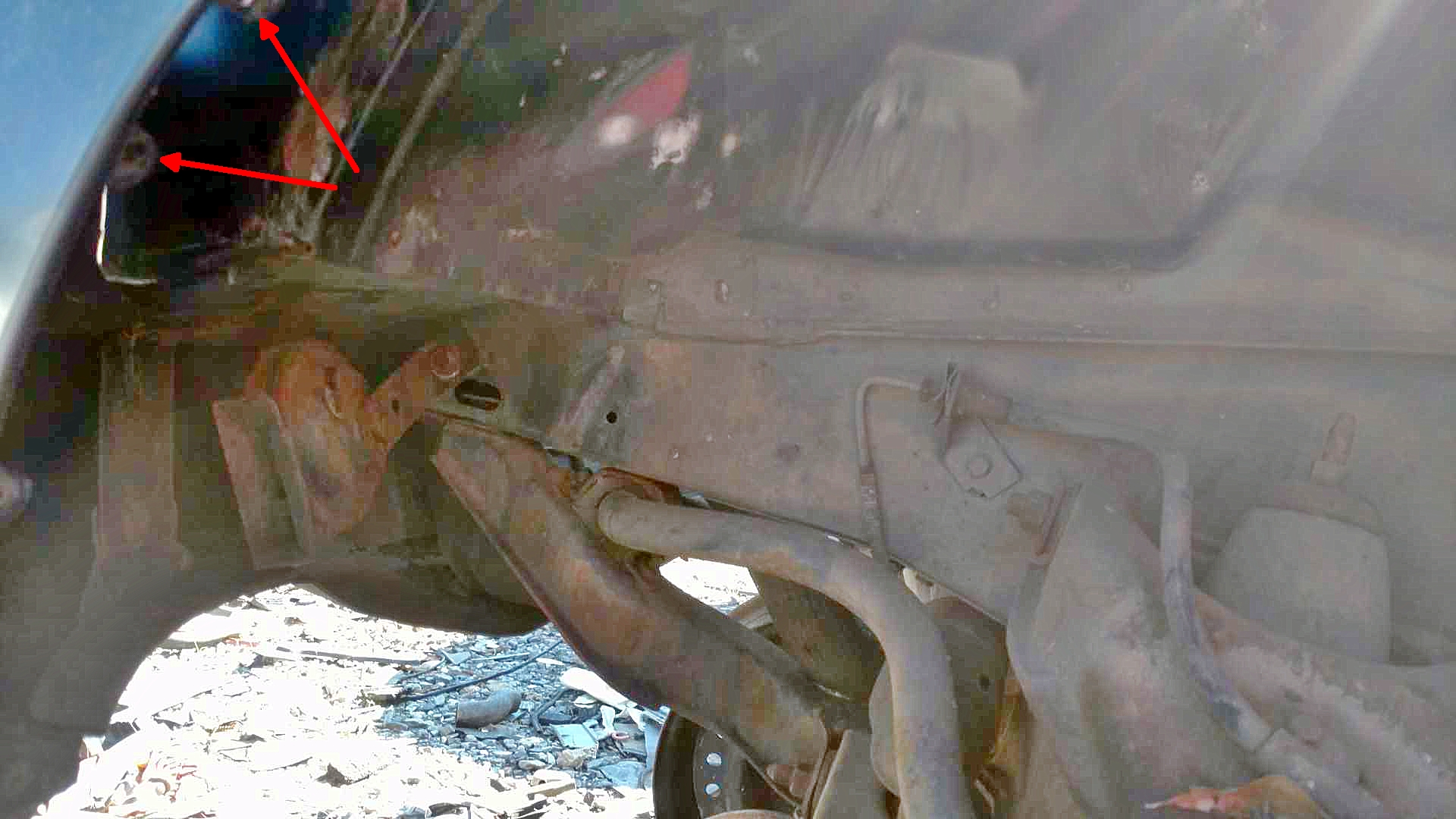

In theory you could bypass the isolation relay on the Gen 1 system and make the system work, but I can see a way to make the headlight motors work without the control module on the Gen 2 system. If the Op posts pictures of the harness and the connectors are there then someone took the module.

Patrick MAY 08, 12:47 AM
Originally posted by DirtyDawg:
I can take a pic of harness to show it hasn't been messed with.
I'd like to see the picture.
I removed the front harness today from my '87 parts car. Here's a picture of where the module was mounted. I don't think the OP was looking in the right spot.
[EDIT] New info added below...
if it had been snatched there would have to be wires that went to it or signs of cut wires, there is neither. No holes in the inner fender where they are usually mounted.
If you look close at the pic there was no module in the fender.
I think I've solved the mystery. I re-processed the OP's photo... and lookie what we can now more clearly see... the two mounting holes for the module! Pretty sure (like 100%) that the OP's harness has been clipped.
