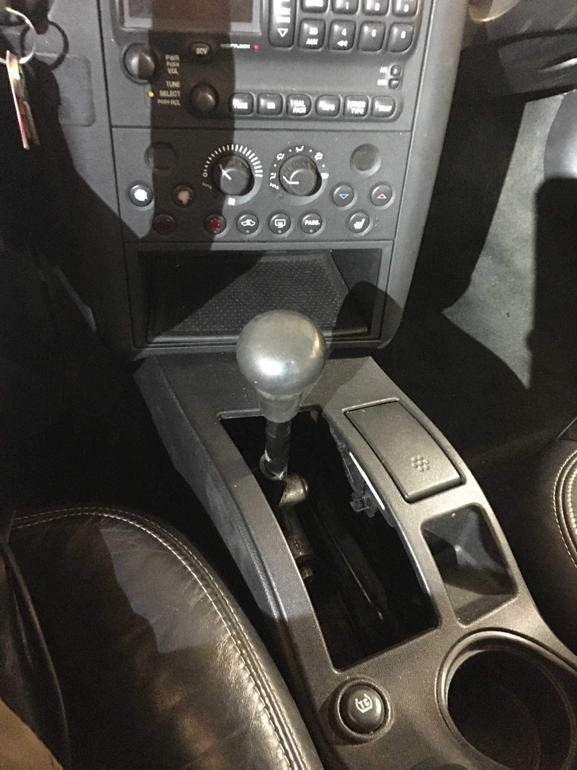

I’m using the 89 Grand Prix shifter, and went out to watch the shifter linkage moving the arms on the transmission while the wife went through the gears. It looks and feels like it’s changing gears, the same as it did on the bench. But then the car just doesn’t move, and it sounds like the transmission is moving once the clutch is out in any of the non working gears.

I have seen 282's get stuck in the 5/R gate, but then the shifter won't move into the other gates. Are you sure you're getting the select (side-to-side) cable range of motion at the transmission?

Do you have the roll pin in the select linkage?
