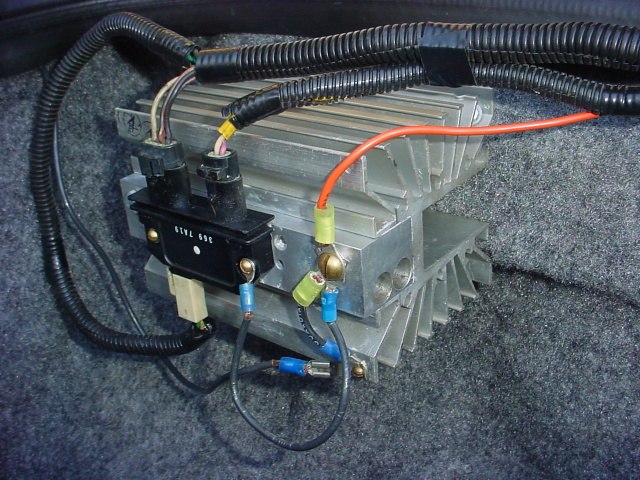

quote | Originally posted by Patrick: That's what larryfiero reported doing in This thread.
 | CLICK FOR FULL SIZE | |
Remote mount in Fiero Trunk isn't a great plan for Same reason Not to mount MSD box or audio amps... Because that area gets hot from exhaust and weather and no airflow. (V6 engine blower get air to blow thru a hole in the wall. Not thru the trunk.) Ignore the amount of whatever get put into there often fill up a lot of space or short out or slams into the ICM. Some Remote mount on other frame parts in the engine bay but farther away from exhaust and plenty of airflow to cool.
