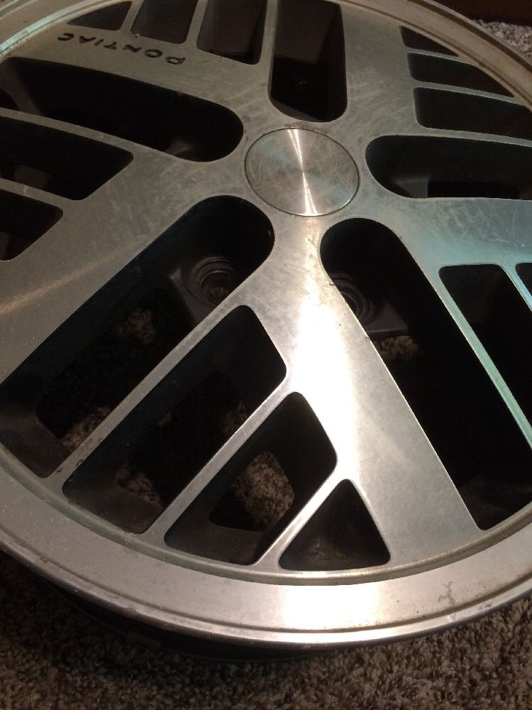

Your right it does look funny. I discovered this when I bought a 88 coupe off the lot brand new in 1988. Upgraded to BFG's (big mistake) and soon discovered the different offset. I also just parted one out a couple years ago and the wheels are different. They are just like the Formula GT wheels. 1" lip in the rear 1/4" lip in the front. See picture:

I don't know that the width was different just the offset. I just remember that discount tire put one rear wheel on the front and it looked very odd. It took me a few days to figure out the problem. It has been almost 30 years so my memory is fading but that is how I remember it. The picture above was taken from an eBay ad.
I am with you on the misinformation front...
I have owned a lot of 88 coupes and have never come across one with a deeper offset 14" wheel in the front. If you look for examples in good condition with good pictures of the wheels, it isn't hard to find them with the same offset front and rear: http://www.ebay.com/itm/198...AOSw42dZFjh4&vxp=mtr https://www.carsforsale.com...cle/details/30701640 https://chicago.craigslist..../cto/6126884379.html
Pontiac used the same "style" 14" wheels across nearly every model with the 5x100 pattern, so possibly the different offset came from one of them. I did some searching and the Pontiac Sunbird and GrandAM used the deeper offset versions and a couple of wheel suppliers for this style, do not list the Fiero, Citation, or Pontiac 6000 (both of which are the closest cousins to the Fiero) as an application. http://www.wheelsandcaps.co...UtLcaO3-uRoCC_fw_wcB http://mvpwheels.com/factor...el-rim-1368-u30.html
As to how your Fiero came from the dealer with the different offset in the front, it is hard to say. Maybe someone at the dealer thought they looked better with the deeper offset version so they swapped them out. Maybe someone scratched them during a customer test drive and they replaced them with a set they had on hand. Maybe the wheel change was part of the western edition that even to this day there is little known about it as it was a regional option. Maybe there was another little know regional option with the deeper offset front wheels. Maybe the early 88 models had the deeper offset, but changed mid-production to using the same wheels front/back (similar to the power steering option that was designed, developed, shipped on a few car, then pulled from production).
It is hard to say for sure, but everything is pointing to the deeper offset 14" front wheels being on the front of the 88 4cyl coupe is the exception, and not the norm.

| quote | Originally posted by carguy8t8:
Sorry I can't let this go. I hate misinformation on here.
That's a Grand Am wheel. They came with that offset.
I'm not disputing that your brand new 88 coupe came with that wheel on the front, but it didn't leave the factory that way, unless it was a mistake. The dealer might have swapped them, or whatever. I've owned two different, original 88 coupes. They all had identical wheels, front to rear. My originals, that came off the car pictured above, are in storage. I can get pics if you want. Or I can find the page in the 22P parts book. The only difference in any of the 14" aluminum Fiero wheels, are that some of them are white (Indys) and some of them have gold slots (86-87 SE.)
Edit - Personally, I think they should have put those wheels on the front of the coupe, but probably didn't because the tires were also the same size, and were able to be rotated with the "same" wheels.[This message has been edited by Raydar (edited 05-13-2017).]
