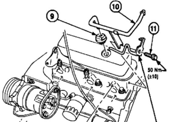

In a misjudgement I made (penny wise pound foolish), I ordered an aftermarket PCV valve for a 1995 Toyota Supra 3.0 Turbo from Rockauto. The brand was Intermotor.
I saw this thread, thought I might get lucky with an aftermarket part, but no. Real POS, I could blow through it the wrong way just as much as the stock (or stock replacement) Fiero PCV valve.
Then, I decided to head to my local Toyota dealer. I tell the parts guy that I have a "1995 Toyota Supra 3.0 Turbo", he asks if I have the 2JZ engine, then I reply "I suppose so", and then he looked at me funny.
$19.62 CAD (taxes included) and a week later, I have the Toyota 12204-46020 PCV valve in my hands (plus a spare one, for an additional $19.62). I blew into the PCV valve to simulate boost, and it didn't leak.
The purpose of this message is to corroborate fierosound's findings.
I have yet to test the fitment of the PCV valve with the grommet and elbow.[This message has been edited by pmbrunelle (edited 04-26-2018).]

On topic, the Dorman 42332 valve cover grommet works OK. It's not perfect, but it's rather acceptable. I'll roll with it.
The Fiero PCV elbow does not fit onto the Supra valve in a manner that conforms to my standards.
I am researching solutions for this now, when I have part numbers, I will post them.[This message has been edited by pmbrunelle (edited 05-01-2018).]
