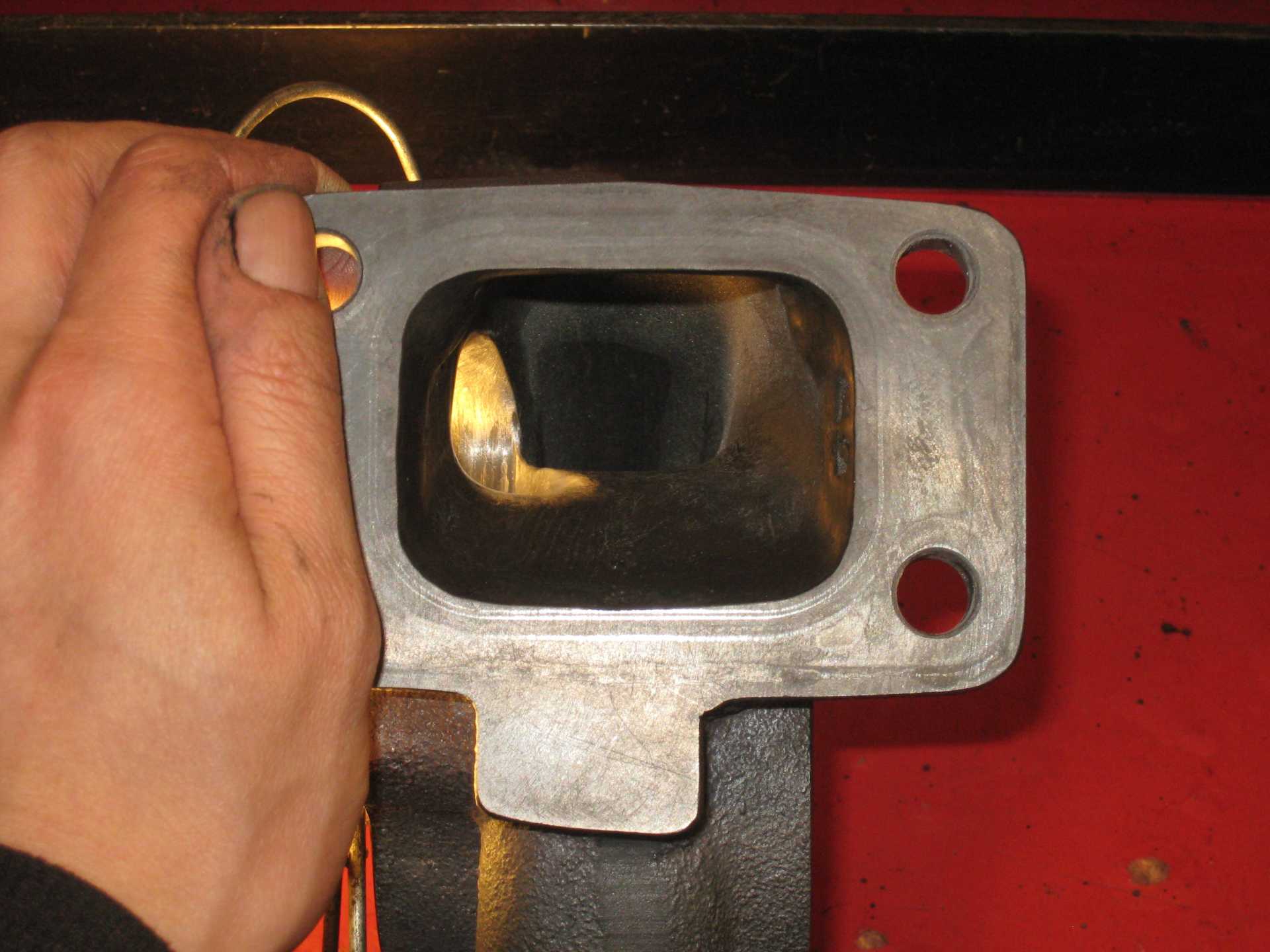

This is what the wastegate passage looks like for exhaust gas entering the inlet flange:
I think that this Saturday I will go to Princess Auto and purchase an electric die grinder + burrs. I need something more powerful than my Dremel to port this.
Even if porting the wastegate passage doesn't solve my immediate problem, the electric die grinder will be a useful tool to have. I don't have a big enough air compressor to run an air-powered die grinder.

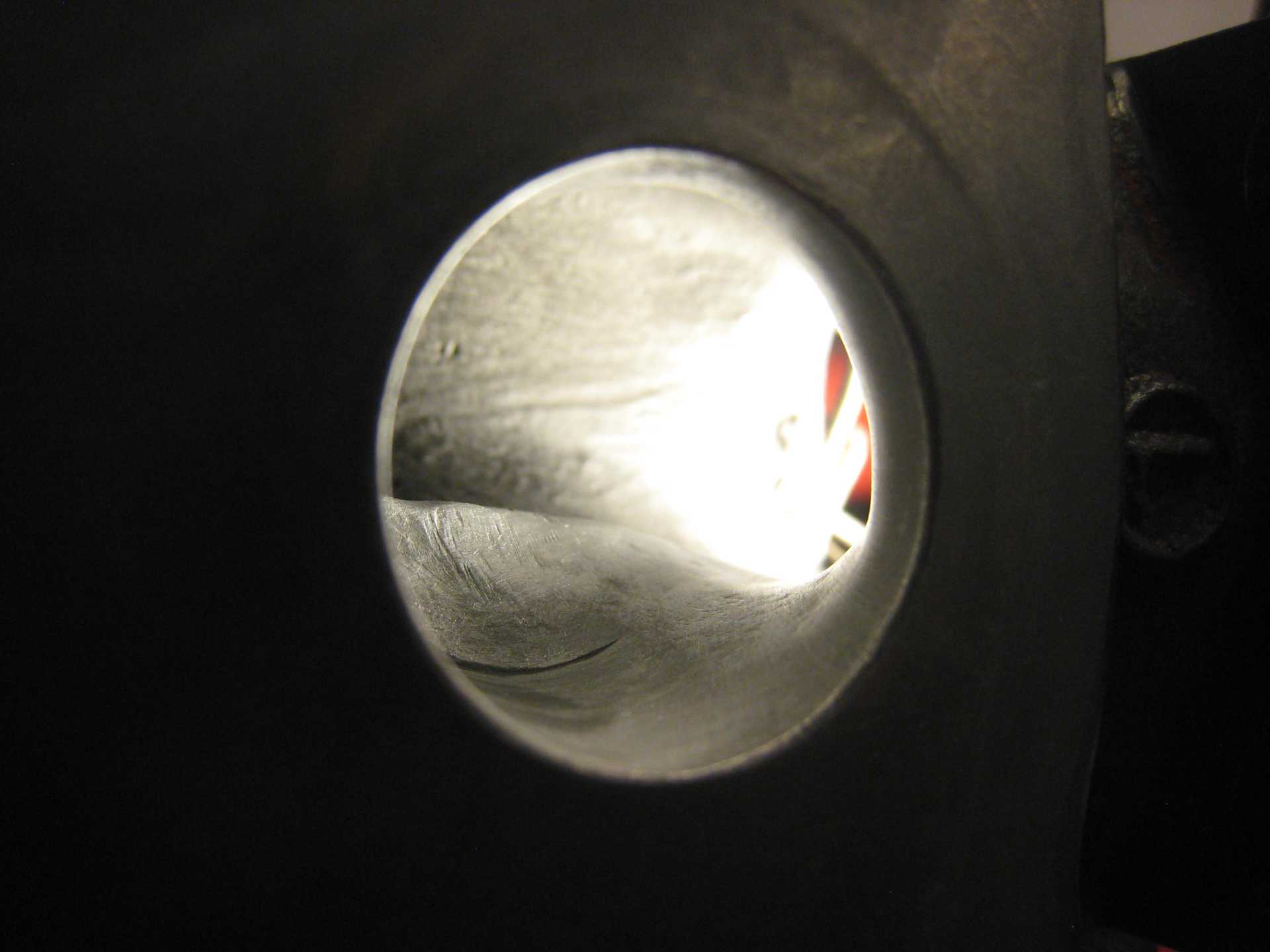

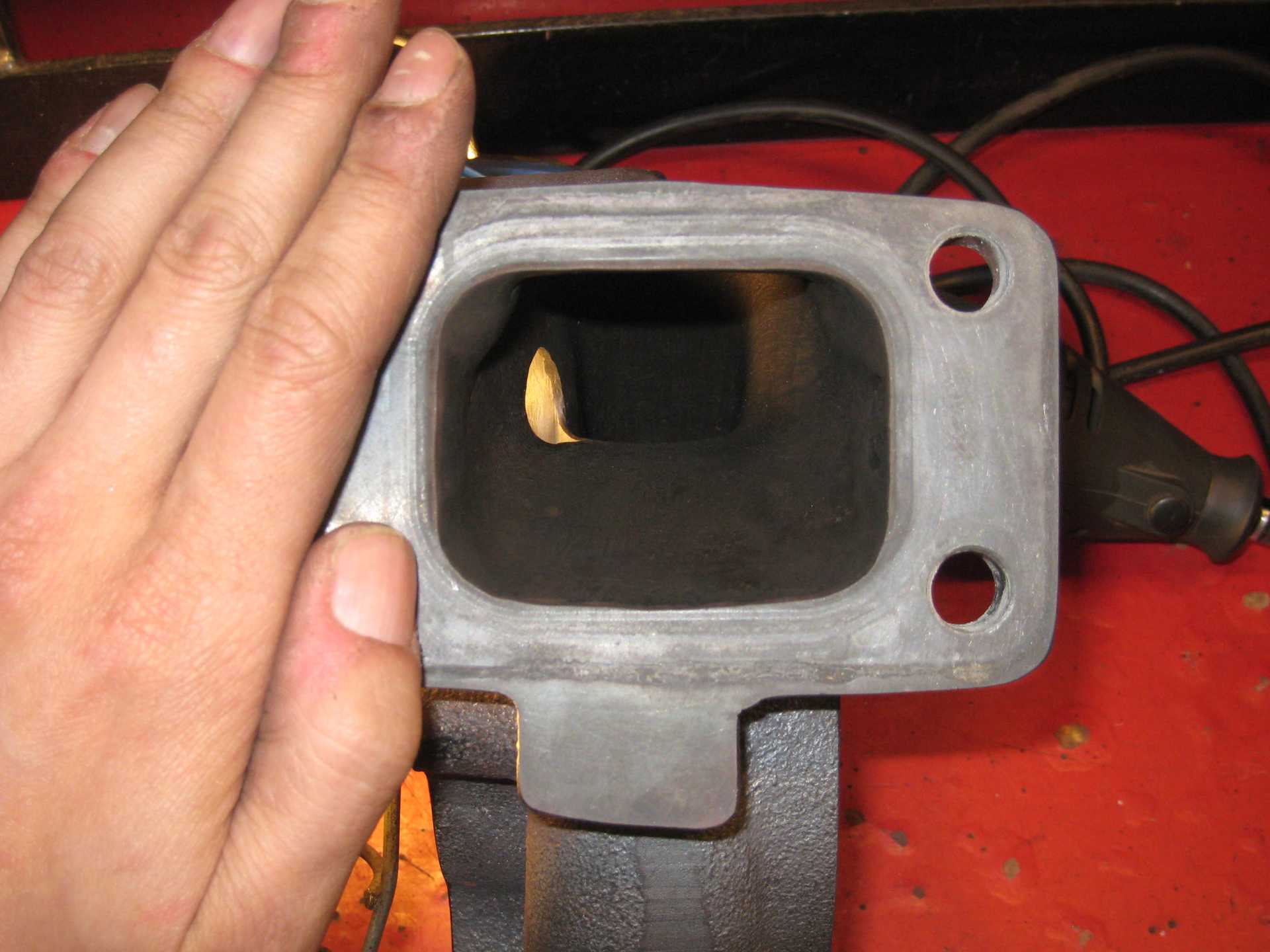

I ported the wastegate passage. There is a radius of about 0.4 inches on the inside of the turn. I left a sharp edge on the far side.
Looking into the wastegate hole towards the inlet flange, with a light shining into the inlet flange:
The shape of the turbine housing lent itself to me carving a scoop shape to help divert exhaust gas towards the wastegate passage.

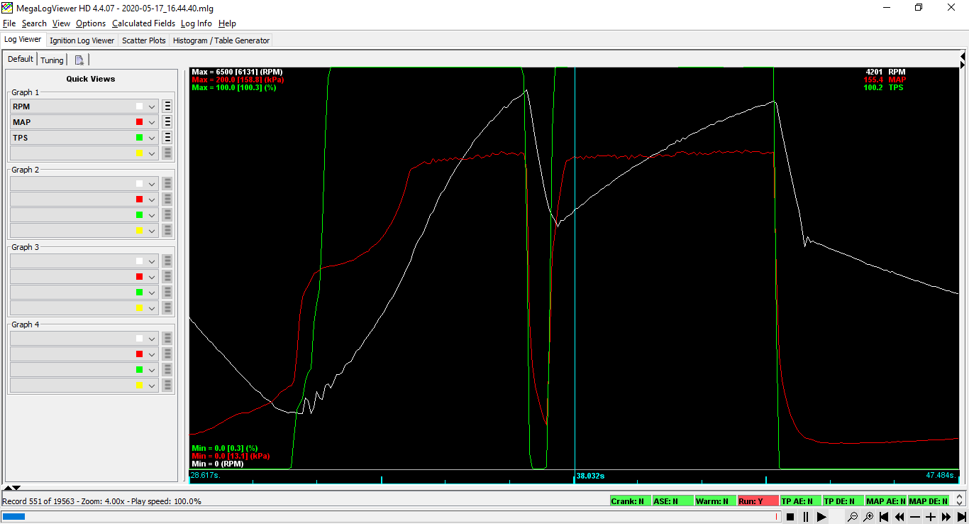

2nd gear pull from 905 RPM to 6131 RPM, followed by a 3rd gear pull:
During WOT, manifold pressure stabilises at about 155 kPa.
