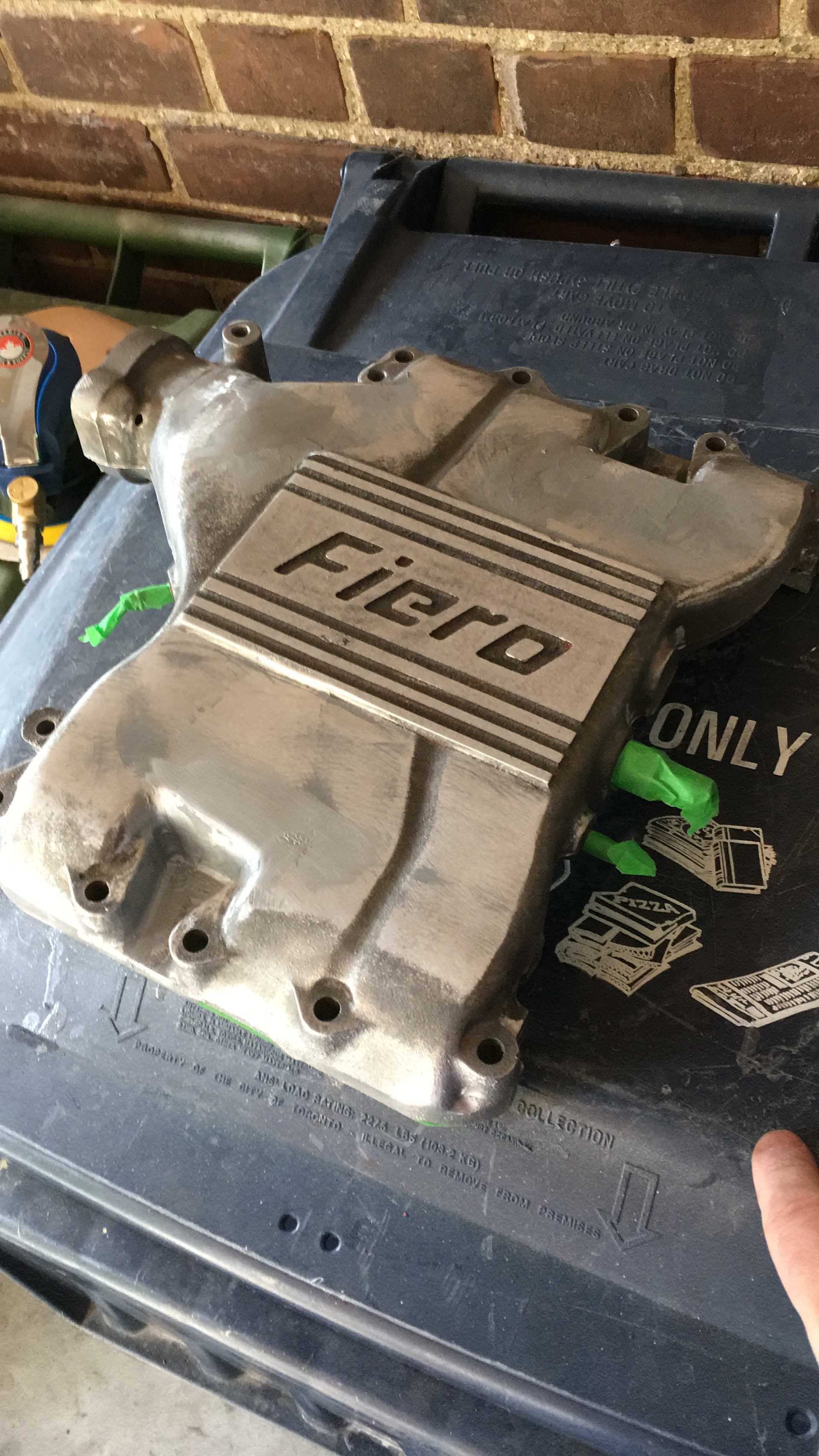

| quote | Originally posted by jjd2296:
that's why I went this route. still cost about 325 usd

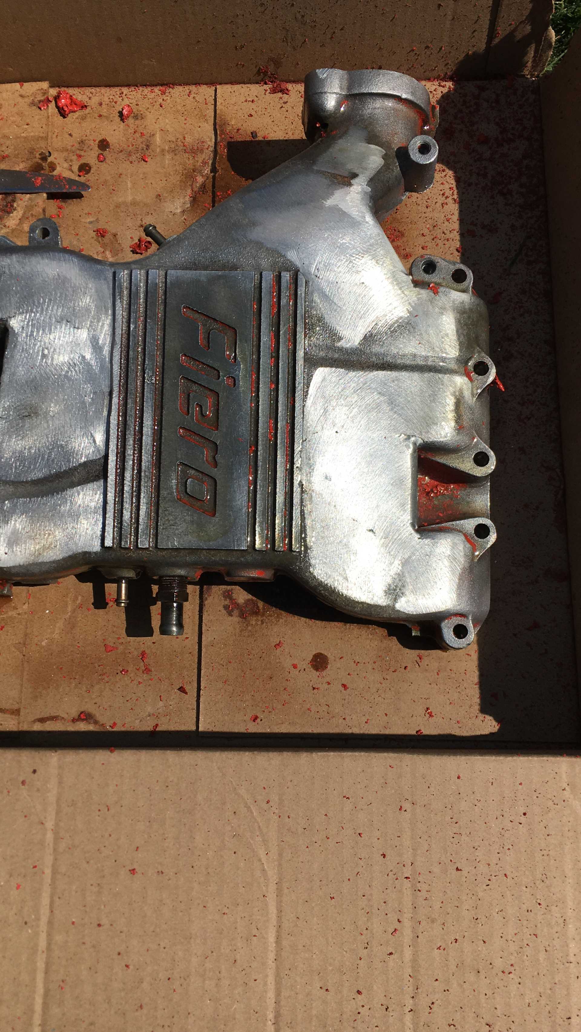

 What I do is also cut back the inner all of these ports a few mm. Basically to about half the thickness you see on the inner edge of the ports. I do this to the middle intake as well. You'll have to use a razor to cut the gasket to match it. This is a substitute for not shaving down the lower part of the upper intake and the upper part of the middle intake.
you can see here what I mean:
It also lets you polish around those areas more...
Also, don't forget to port those heads...
