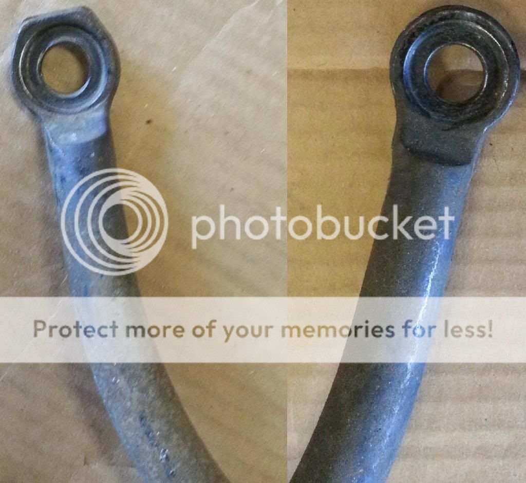

FYI 84-87 Front Swaybar has two different ends...
Round goes to the passenger side, Oddball goes to the drivers side.[This message has been edited by MulletproofMonk (edited 05-29-2013).]

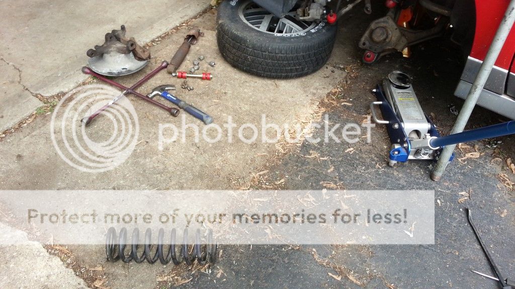

So, I keep hearing about the front spring jumping out and biting you or giving you rabies or laying its eggs under your skin or some other pile of hot garbage. This hasn't happened to me (yet). So, I decide that I want to see what all this brouhaha is about. As all good internet videos start out, "Hey Y'All, Watch This!"
http://www.youtube.com/watc...tfY&feature=youtu.be
BTW, the spring is sitting 4 feet from the lower control arm and only stopped because of the rolling mechanic chair I had my phone on. I have seen the light, use something to secure that spring before you pop it loose...
BE SAFE

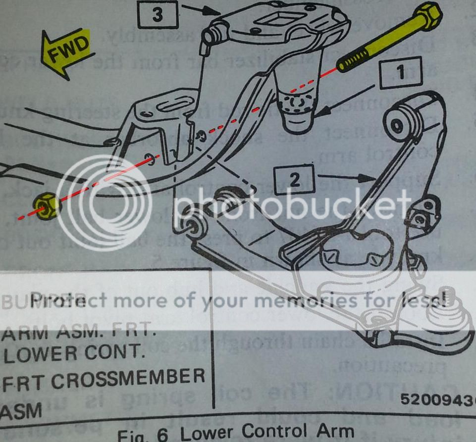

So... While I was sitting around pissed off because I tore another steering rack boot getting the control arm bolts out... and I noticed this in the service manual... It shows putting the front bolt in forward so you don't hit the boot. I can only assume that they installed the bolts one way at the factory and changed it in the service manual. I haven't seen one Fiero with the bolts going forward yet. Of course mine do now...
