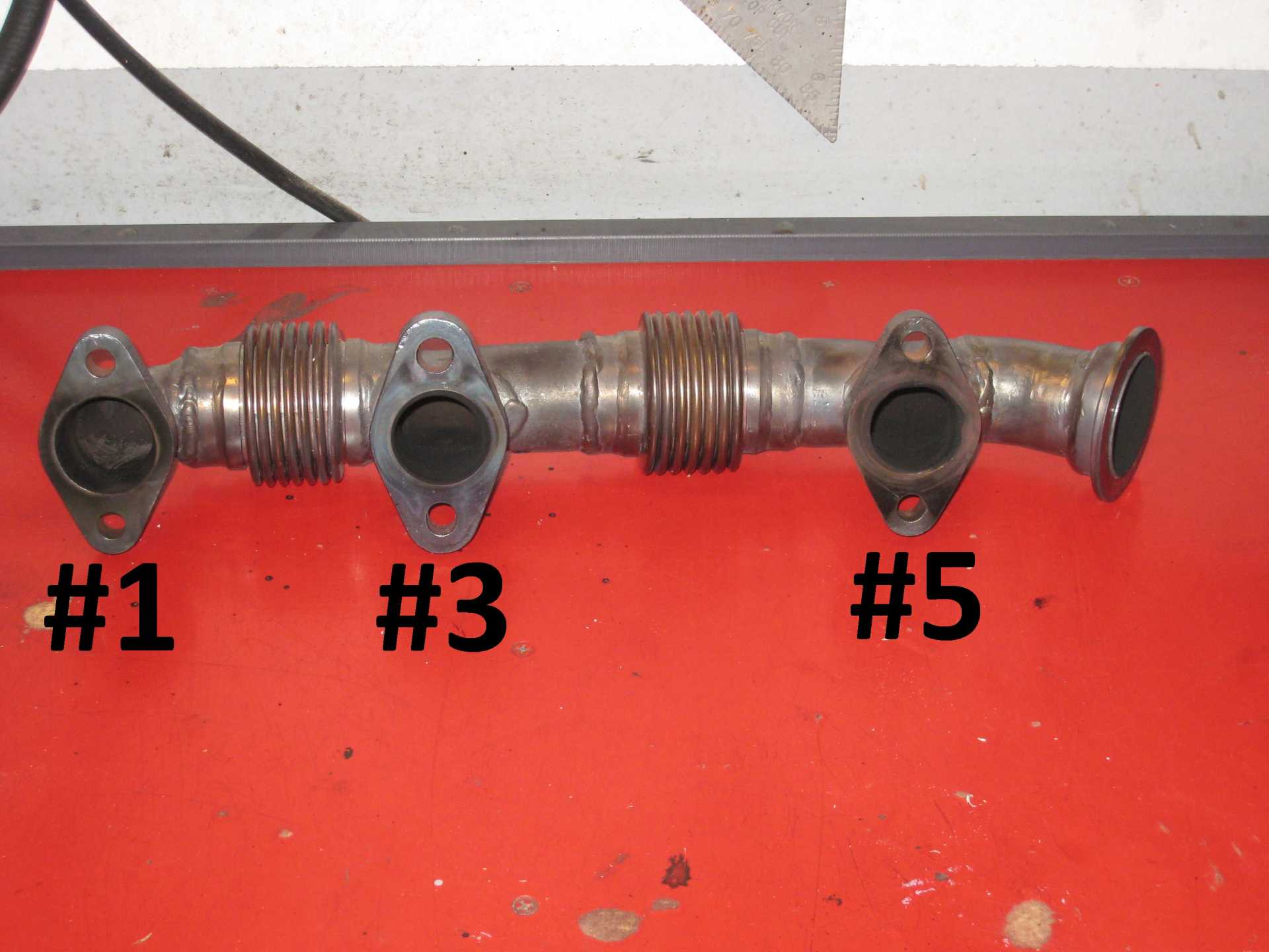

In preparation for the bolts to arrive, I have removed the manifolds and cleaned them with non-chlorinated brake cleaner, as well as the sealing surfaces on the heads.
Before cleaning, I took this photo of the rear manifold:
From the carbon, we see that #1 and #5 were leaking.

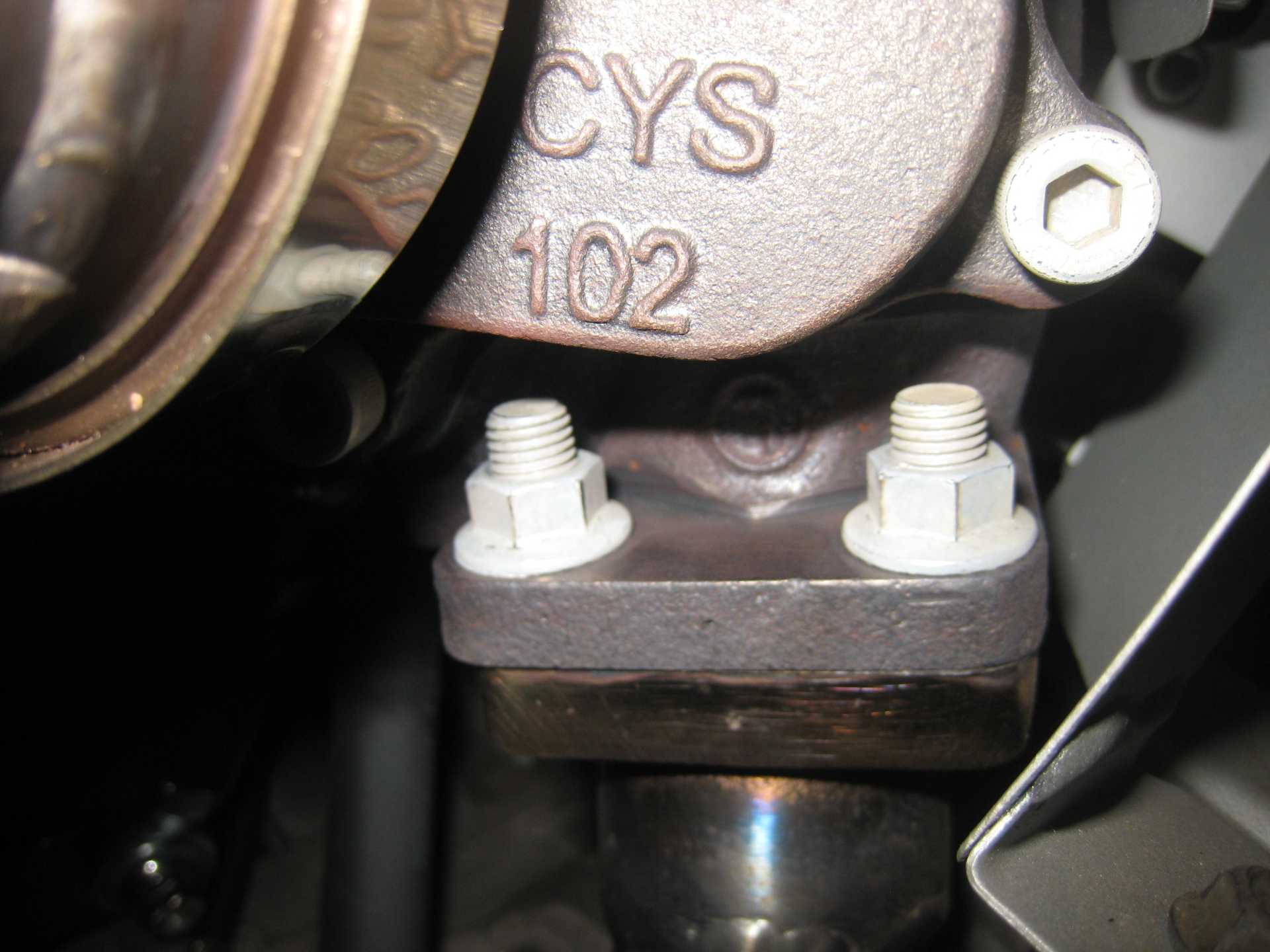

I have stainless on the turbine inlet flange. That joint (and the piloted V-bands) have held up so far (100 km).
This is what I did on the turbine inlet: Serrated-flange nut (10.9, zinc-plated) Faced nut seating surface on cast iron turbine housing (was as-cast with draft angle on the ATP housing as-delivered) Machined sealing surface on cast iron turbine housing (while porting the housing, I damaged the sealing surface, so the local machine shop fixed this for me) Thin layer of wheel bearing grease (apparently an old trick; burns away and leaves carbon which can seal small gaps) Thin stainless steel gasket. Has an embossed ring around the hole in the middle. Thin layer of wheel bearing grease Machined (as-bought) 304 stainless exhaust flange with tapped holes Double-ended zinc-plated studs, anti-seize on both ends.
For the manifolds, I thought about using no gasket, just metal-on-metal (with some wheel bearing grease), but I'm not sure if the sealing surfaces (head + manifolds) are good enough (surface finish + flatness) to do that.
For Volkswagens, I found copper gaskets (3-week delivery time if I order some), but I haven't found straight stainless yet.[This message has been edited by pmbrunelle (edited 05-06-2020).]
