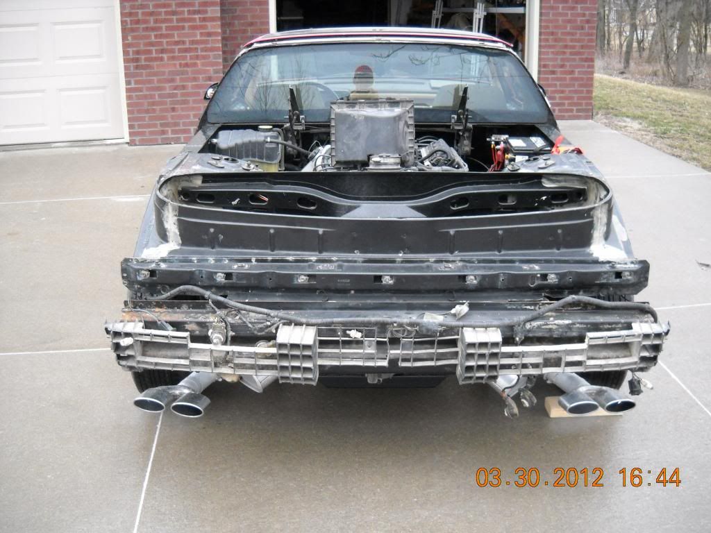

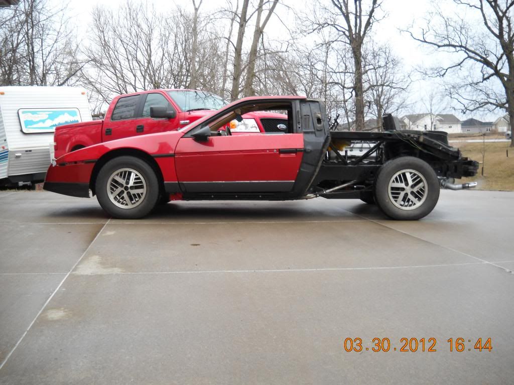

MAR 30, 06:01 PM
I got it out of garage today. I did drive it up and down the driveway a few times just to check things out. Then.... I took it around the block with no major issues. I know the shifter needs some work and the brakes need re-blead. Man, that northstar is smooth compared to the 4 banger that was in it. Its also alot smoother the my 2.8 daily driver. Here are some pics outside. Does it look familar BubbaJoe ???

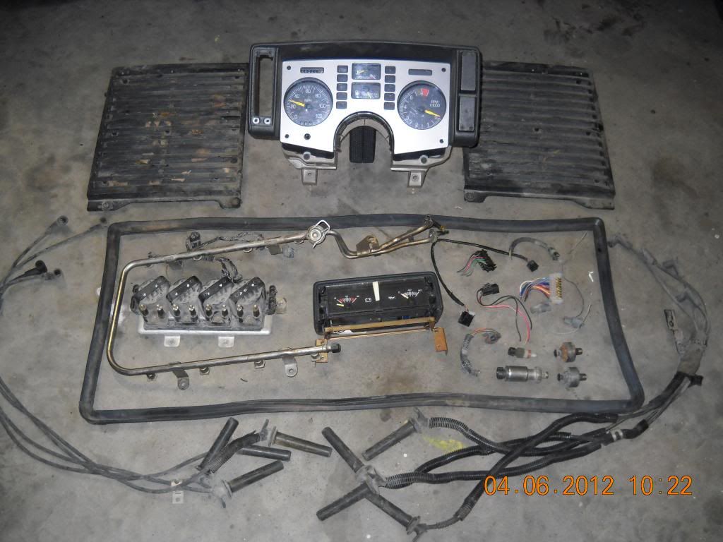

I'm doing some research on programming the ECU, in the mean time I hit the u-pull junkyard today. I knew they had a 88 fiero and wanted to get some parts before it gets stripped. It has a rusted cradle. Here is what I got.
Nebraska
APR 06, 08:50 PM
The gauges are going into this project. I picked up the oil pressure and temp sensors and also the wiring pigtails. Since this is a 84 the wiring is going to be tricky. Its not prewired for all of the gauges. I already put in the tach and spedo, I had to modify and calibrate the tach for the 8 cylinder. The gauge pod is next (volts/oil). I'll be searching on the forum for the wiring.
