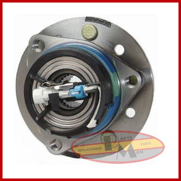

Khw
JAN 21, 09:20 AM
bearing? I would suspect the front used a hub. Could you take pictures of it and post them? On our 2000 Bonneville (yes I know that's not the same platform as the Alero) the front used a hub. There was a axle shaft nut you had to remove. You also had 3 bolts tucked in behind the upright that held the hub into the upright that you had to remove. After those came out a knock with a rubber mallet to free the axle shaft up and then a few knocks with it on the hub got it to start seperating.
Yup, I did a search for parts and it looks like your Alero uses a hub.
You can see the 3 bolts I was talking about in this picture that come in from the back side. Did you get those out?[This message has been edited by Khw (edited 01-21-2013).]
