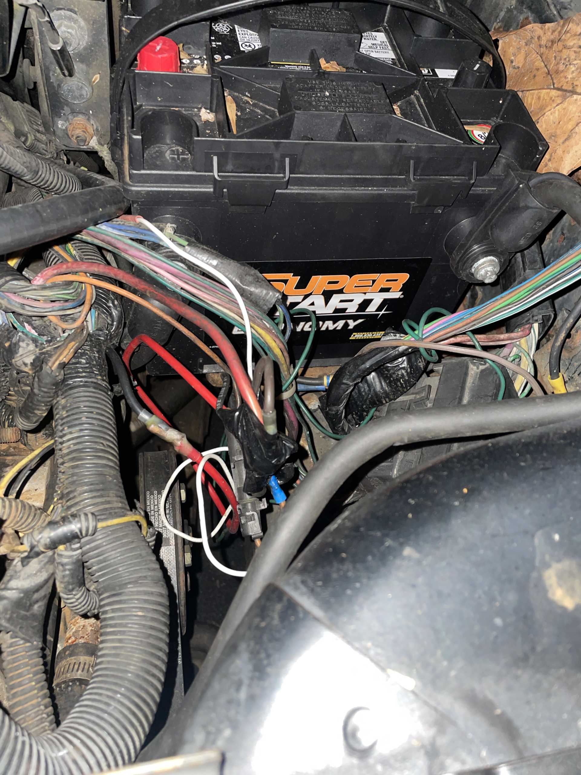

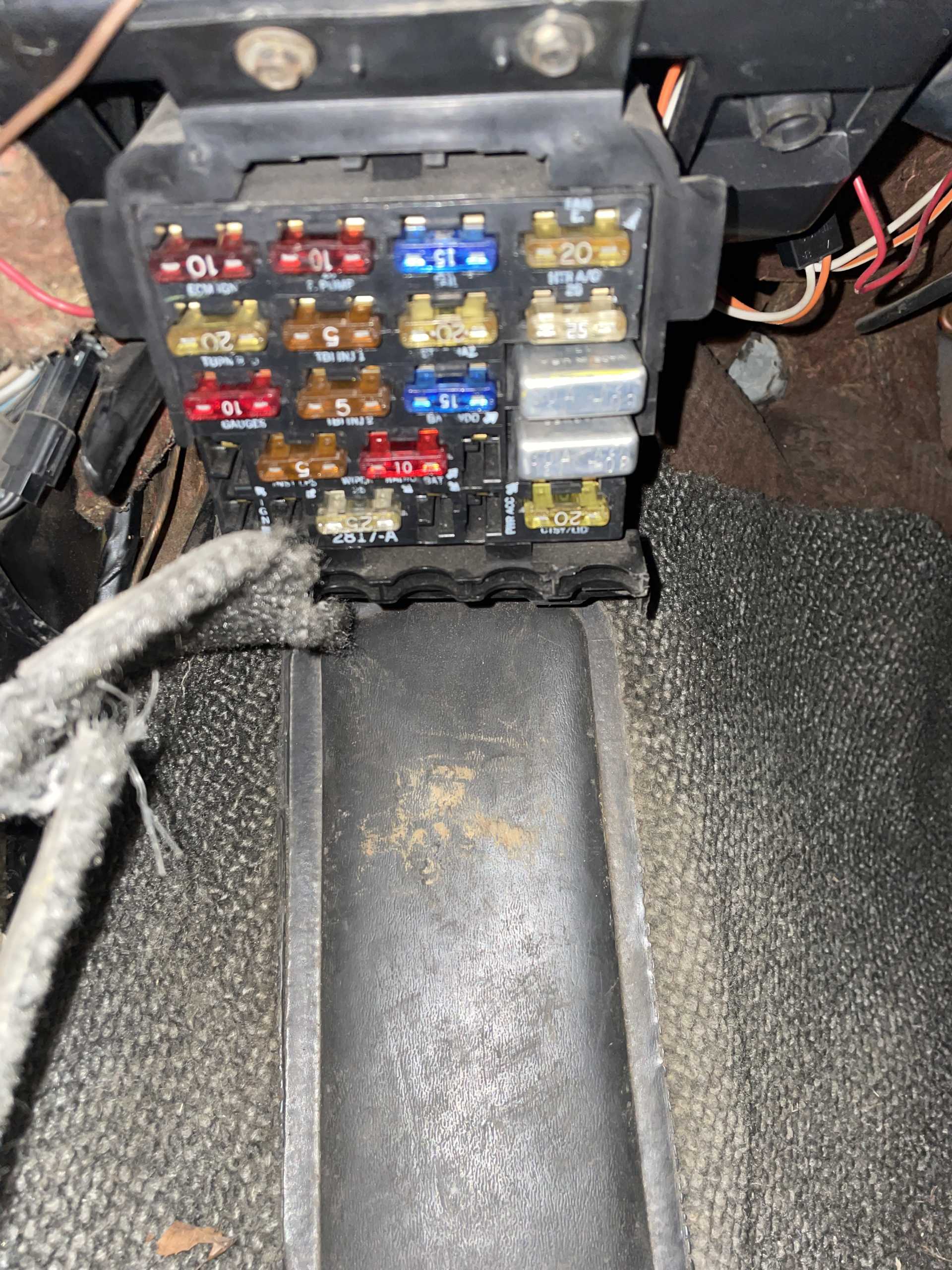

Hello! I am new here and to owning Fieros. I picked this one up around a month ago. Right now it is a 2.8 auto but am planning on doing a Getrag 282 and 3800 swap. I was told a crate motor was put in (newish block and heads but 40+ year old everything else) For now I just want to get it running decent enough. I must press the gas to start and it idle hunts quite a bit. Wiring wise she's a mess
It also appears someone installed a remote start box and a kill switch. (neither of which work) It somehow runs without an IGN fuse. Otherwise its really fun to drive. Yall got any suggestions on the issues listed or just another excuse to 3800 swap it?

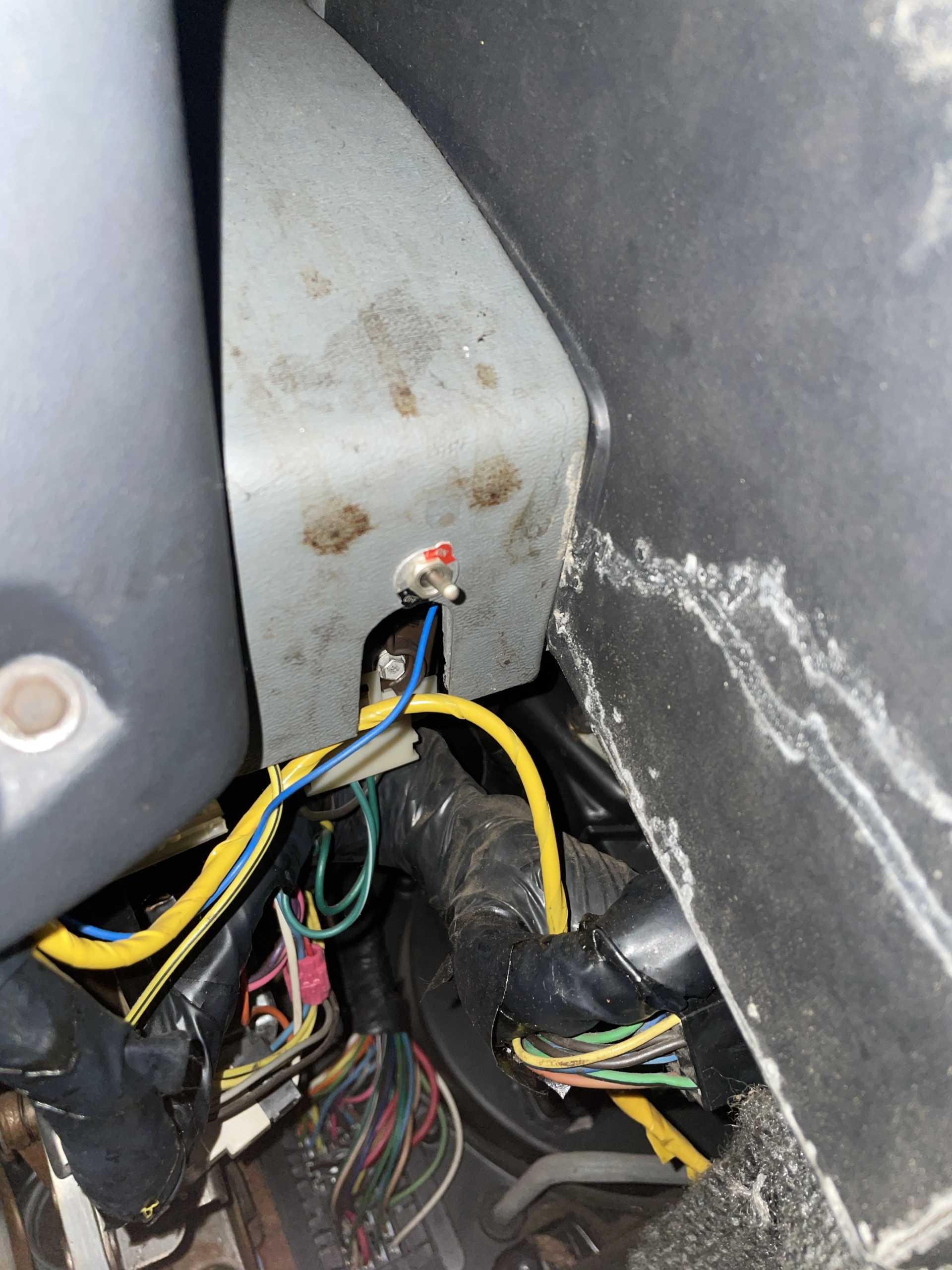

also photo of maybe kill switch?
Photo of fuse box (notice lack of IGN and BAT fuses yet the car runs and the radio/horn work)

Patrick NOV 17, 11:54 PM
Look closer... you have no missing fuses.
See This thread.

nathanninjacube NOV 18, 09:07 AM
Well, that explains it lol. Thanks for the info. Chose general because it was more supposed to be a "Hi I'm new" post. Sorry if its wrong! (did include general technical stuff. mb!)

That switch might go to an alarm system. I would follow the wire to see where it goes.
