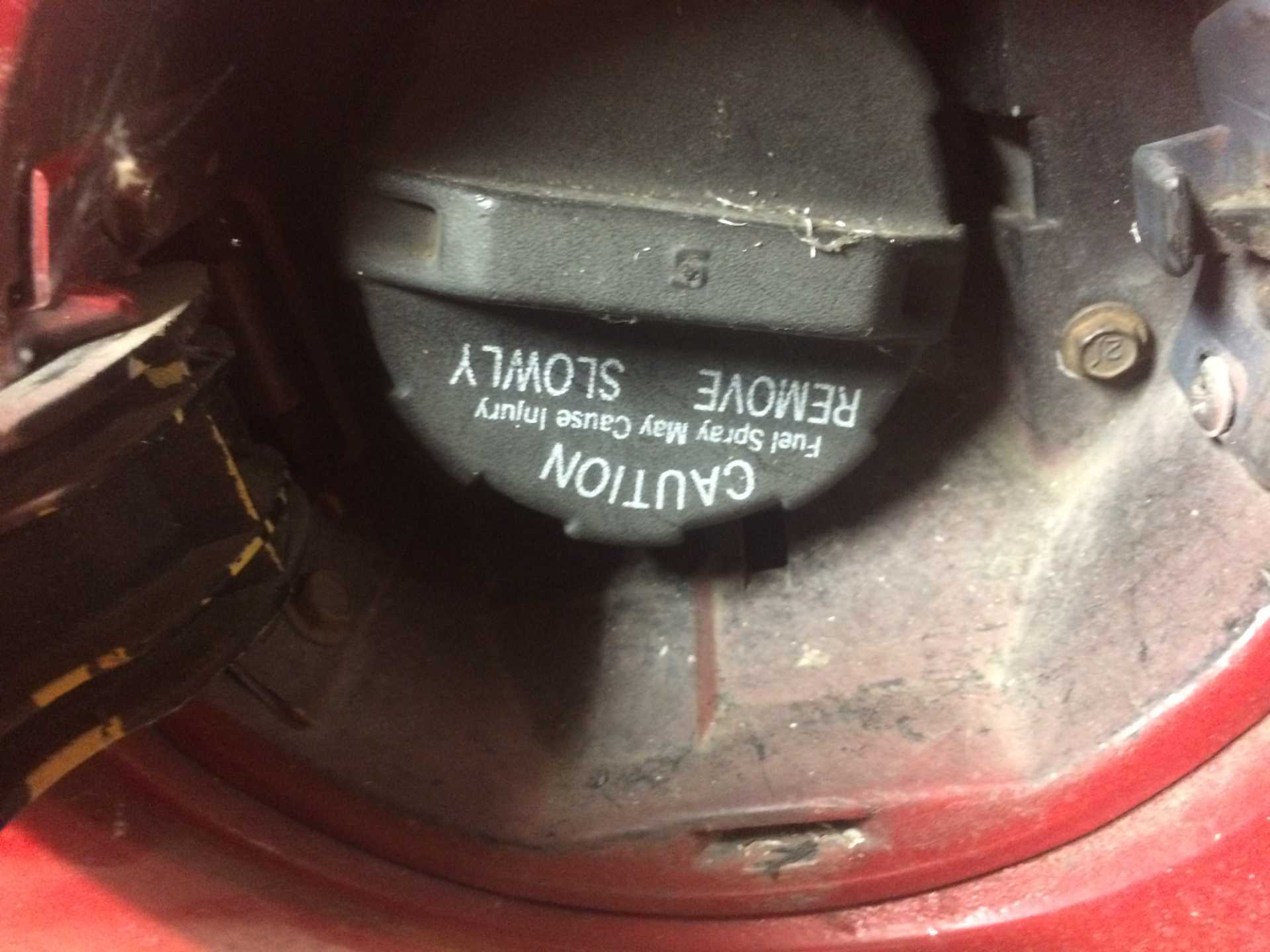

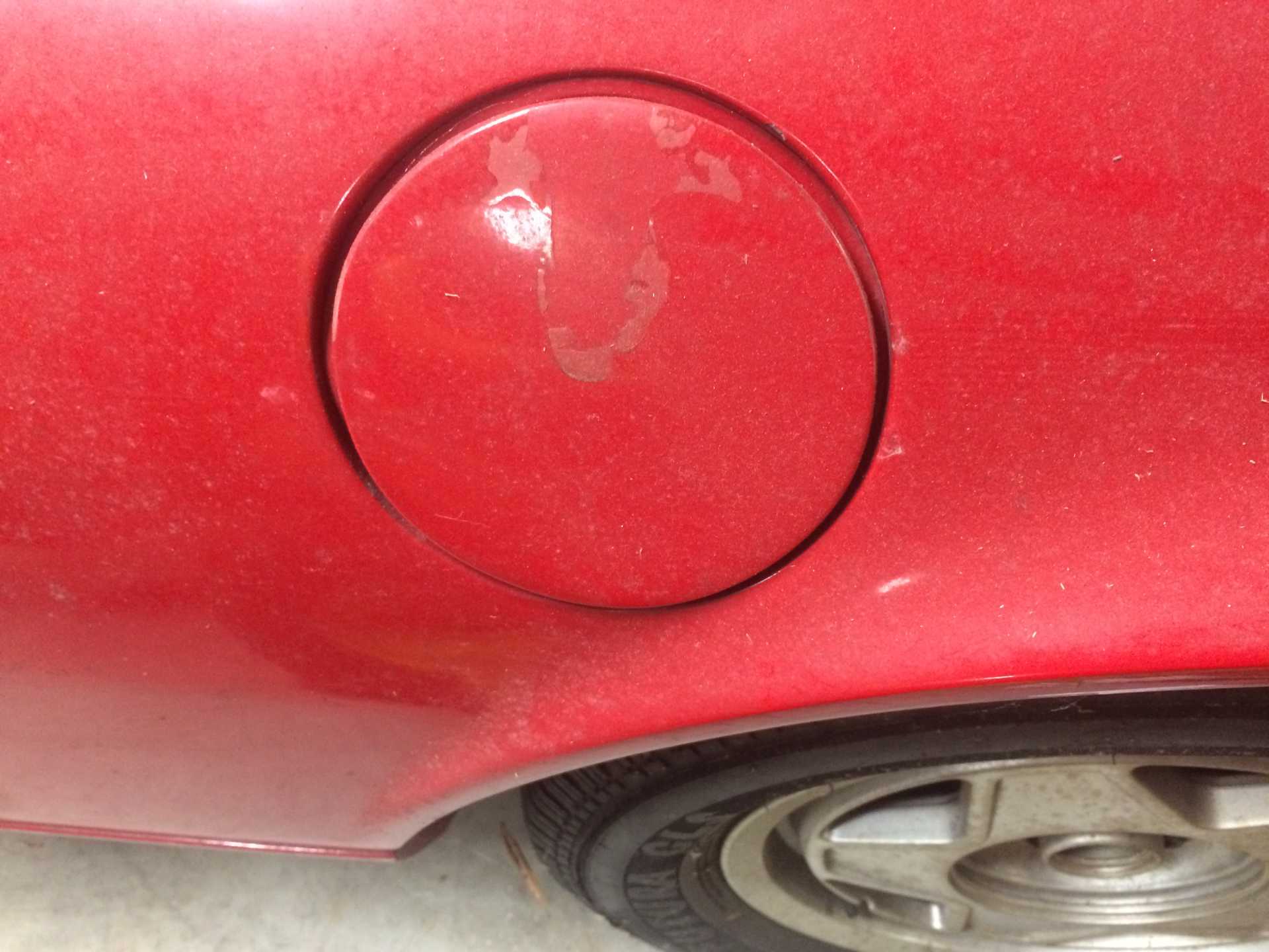

Here are a couple of photos but it still looks stock to me. I know for a fact that the stock Fiero external gas cap cover will directly bolt to a Mera. Note that I do not own a conventional Fiero so I might be wrong. These photos are all I can get without some vehicle disassembly and I am reluctant to do that. Maybe I can get a few more photos the next time I have it on a lift.

RCR
AUG 10, 09:24 PM
Thank you, Nelson. I appreciate the help.
Do you happen to know if the fill tube is stock, or was it split to accommodate the change in body width?

hnthomps
AUG 11, 06:53 PM
| quote | Originally posted by RCR:
thanx again,
Bob |
To the best of my knowledge, the fill tube is stock.

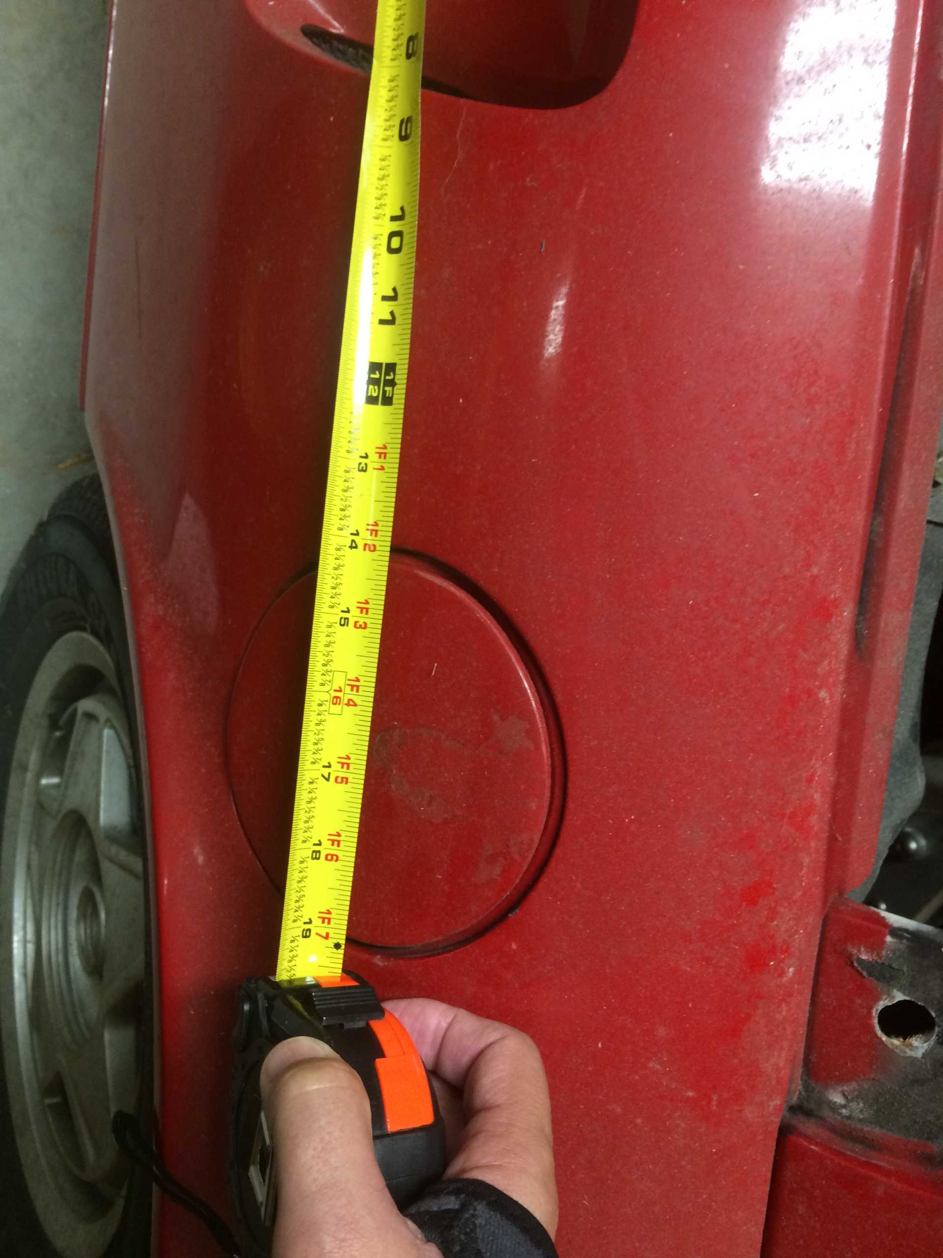

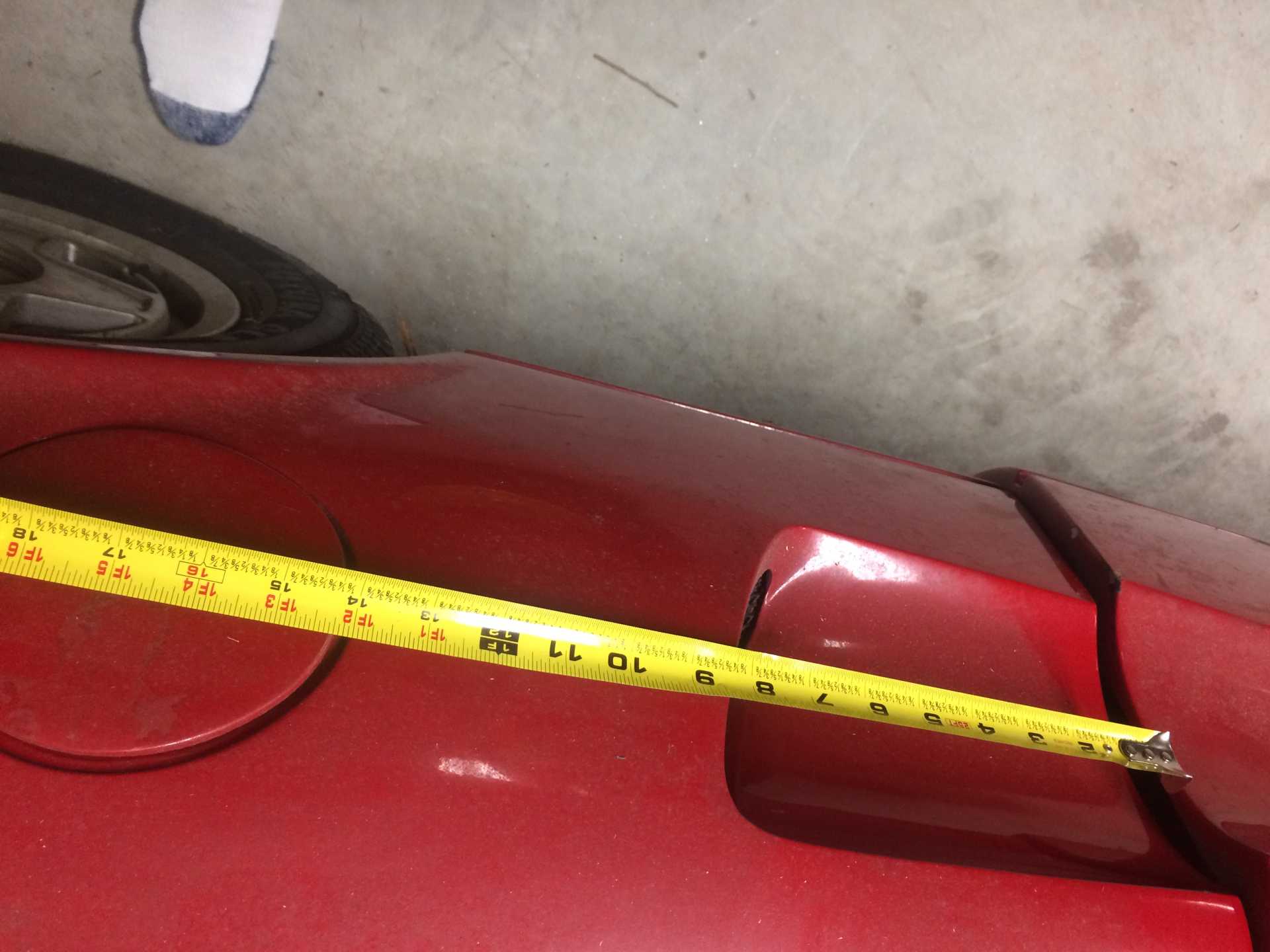

Hmm?? Can I ask one more favor, Nelson??
Could you please measure the distance from the Driver's door edge to the leading edge of the gas door? That will give me an idea if mine has moved back.

hnthomps
AUG 12, 09:08 AM
Again, much appreciated.
Bob
It looks to be almost exactly 14" for your desired measurement.

RCR
AUG 12, 08:15 PM
Perfect, Nelson. Thanx, man...
