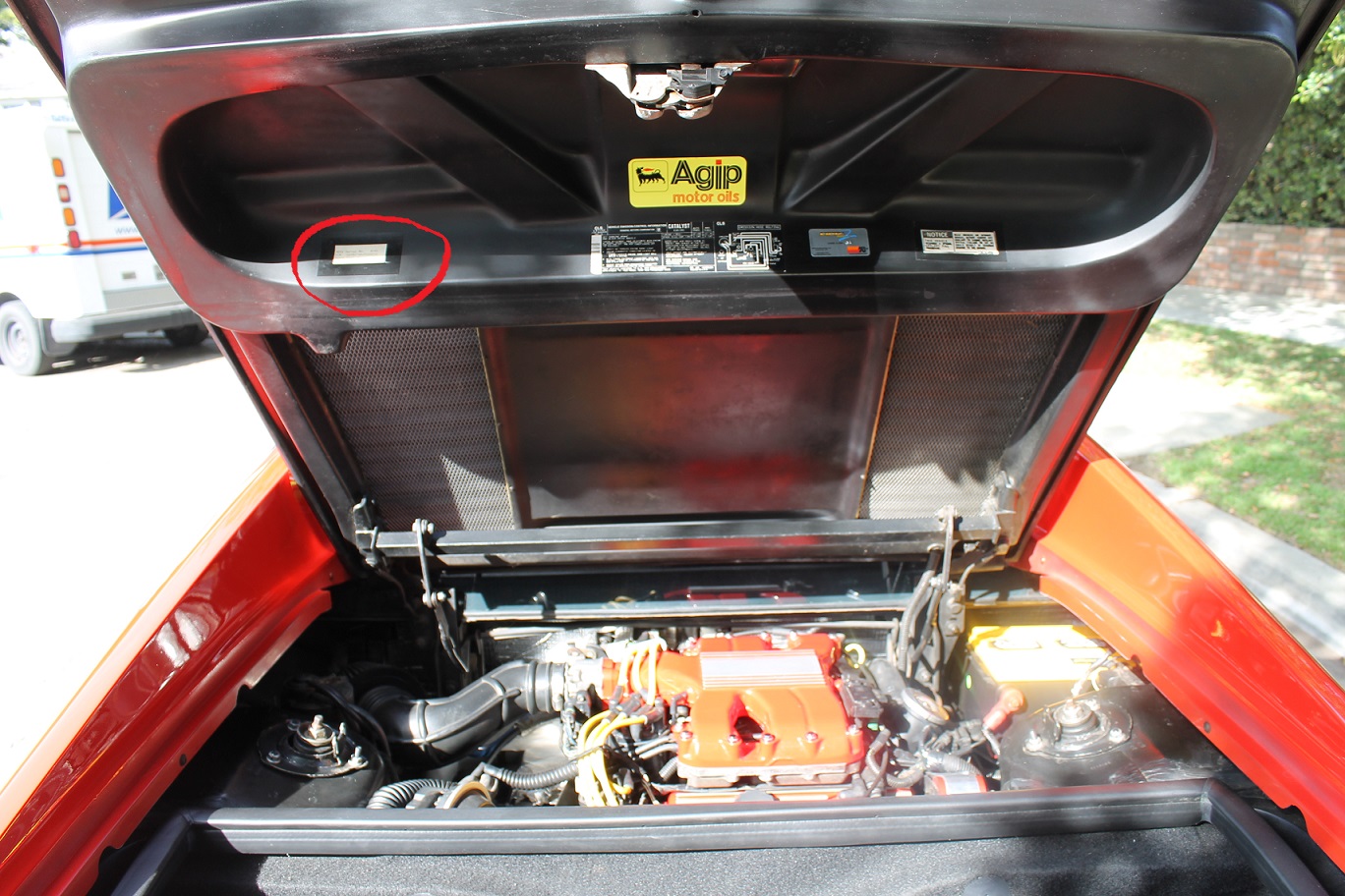

All of the MERAs I have seen have the production label on the left side, circled in red in pic.
My MERA, 8029, was built on a Formula chassis. It had a notch back trunk seal on it when I got it that needed to be replaced. I tried a GT trunk seal on it and my trunk wouldn't close, the corners were too thick. I put a new notch back trunk seal on and it closes like it should now and doesn't leak.

Thanks for doing that since I got preoccupied and forgot. My build stickers are in the same location.
