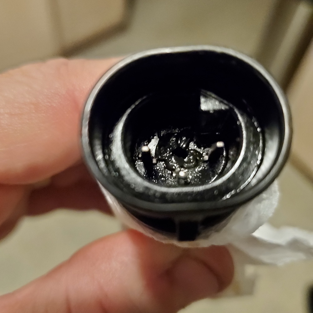

Sorry all, forgot to mention that its a 3800 motor w/ a stock 88 OPSU installed (the three wire unit). I replaced it w/ a new one, no more leak. Attached is a pic of the sending unit, when I compared the old one to the new one, the old one has a hole in the bottom of the electrical socket. You can put a pick thru the hole and into the sensor. This is where it was leaking from. This is the second time a OPSU failed this way, my daughters 2002 Beetle did the same thing. Anyway, its fixed now.... I hope.
