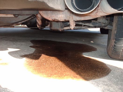

Here is the original leak pattern in the driveway:
Topcat suggested I check the oil pressure sender first and after consulting with my Haynes Repair manual and checking in the general vicinity of where I thought that might be, I discovered the only areas that were wet with oil and took these pics:
Here's the new leak pattern on the driveway. It's gotten wider and appears that the leak is either increasing or just expanding. (Our driveway is on a bit of a slight incline, so the oil is running downhill.)

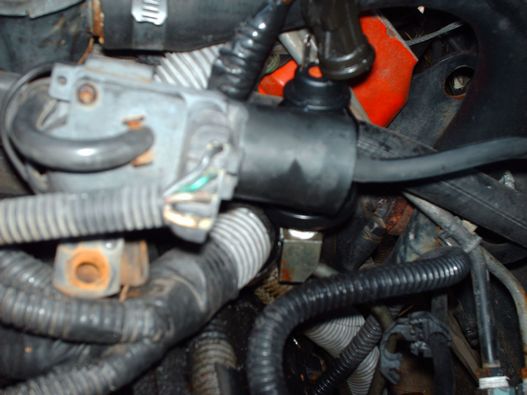

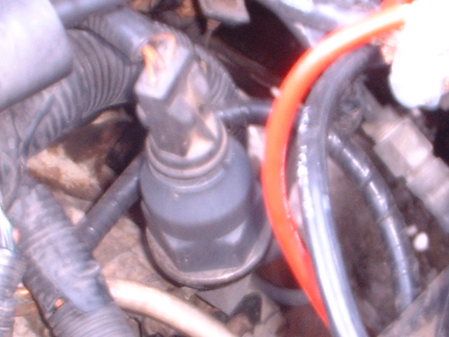

These are pics of what I think is the oil pressure sender:
Another angle:

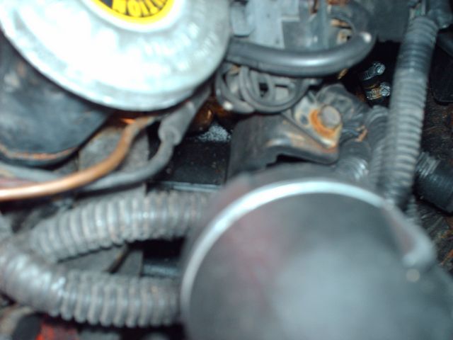

I tried to get a pic of the tube running down to the underside of the car since it's got oil on it as well.

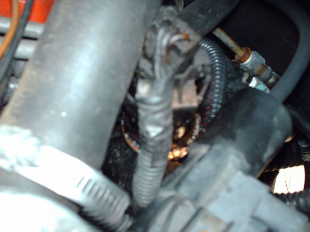

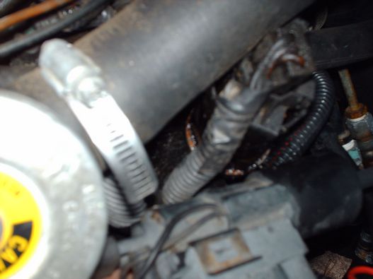

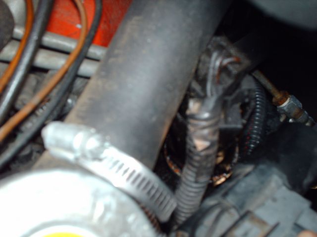

Here are pics from the underside of the car. The leak is on the passenger side, so we took these pics aiming up next to the rear tire.
Looking at these pics and the others from the other thread, is this coming from the oil pressure sender? What do I do to fix it?
The car runs great. I just want to get the leak taken care of before it gets worse or develops into a problem. The rest of the engine seems to be clean, so there aren't any other leaks that I can see.

The oil pressure sending unit has an encased plastic component housing that degrades after a good period of years use. That appears to be your problem and it should be replaced ASAP, not a good idea to operate the car until the leak has been corrected (low oil, and / or risk of fire).

That's the area of the oil pressure sender. Here's some pics showing it more clearly, though your earlier model sender will look somewhat different:
You'll see the silver tube that comes out the bottom of the metal block the sender is screwed into, that tube goes to the pressure port on the block. On non-A/C cars the sender is screwed directly into the block, but the A/C compressor required moving it to a different location as shown above.

here is the OPSU
there is a nut i want to say its a 15mm, use a wrench underneath the unit
it just screws out

Yep, that is it. It looks like the sender in your pic is wet with oil. The sender is not too hard to change, but it is in an awkward place.

Looking at these pics and the others from the other thread I suspect the timing case cover seal or the harmonic balancer may require a sleeve as it has a groove cut in it made by the old seal. This area is often over looked by rebuilders and/or the person installing the balancer, they figure a new seal will cover any leak, not so.
The reason I say this is the oil pattern left on the lower coolant hose as it is wet on the bottom and side not on the top from the area of the oil sending unit. To add the reason you seem to be continuing to leak oil is because of the oil sling over the front of the block and the lower area of the water pump, too far away for the oil sending unit.
The only way to check that is to remove the belt, crankshaft pulley and then the balancer retaining bolt and balancer for a visiual inspection.
Notice the top picture (if I'm looking at it correctly) the bottom of the oil sender is dry on the forward side. I can't see all of it because of the coolant hose is blocking the rest of it.

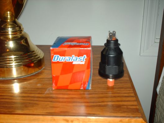

Picked up the part today from AutoZone........
Couldn't get to it yesterday and it rained all day today, so I couldn't change it out. I'll keep my fingers crossed that the weather holds out tomorrow so I can take care of it. From the looks of the one in the car, this looks like the culprit 'cause the entire casing is gone. I spoke to the previous owner and he said that the car has a Melling (sp?) oil pump in it, so a small leak will actually look like a big leak 'cause there's so much oil being pumped through.

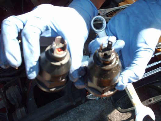

Report this Post01-19-2006 06:08 PM Click Here to See the Profile for Miss-Tress007Send a Private Message to Miss-Tress007Direct Link to This Post
Finally got some time (and some good weather) so I replaced the part yesterday and drove the car around to test it out. I let it sit overnight, then drove it some more......
NO LEAKS! Problem fixed! The car actually idles alot smoother and sounds better.
Here's a pic of the old one (on the right) and the new one. It looks like the little rubber stopper is missing in the old one. (May explain the reason why there was oil leaking out. )
I tightened the new sender as much as I could, but there was still a bit of thread/teflon tape showing. Is this screwed in far enough or should I be concerned that there's tape visible?
Thanks guys!
~Tress

If it isn't leaking and is tight your done!
Good job.

The tape showing is alright. That is a tapered pipe thread, which means, the threads get tighter the further they are screwed in. You probably tightened it about as much as you could.
Glad you got that fixed.

The sender uses a tapered pluming thread. (It is a 1/8 inch NPT Fine fitting. Same as small pipe.)
DO NOT force it. NPT fittings are sealed by the taper in the threads. They will almost never seat fully into the fitting and you don't want them to. If you force them you can break the part or split the fitting. I've seen broken manifolds and other parts from people forcing tapered thread fitting and sensors too tight.

Most of these sensor come from the factory with sealant already on the threads ( usually red in color) and you do not need the Teflon tape. But you are ok looks good
Don
Also the red plug is to keep moisture out of the sensor.
