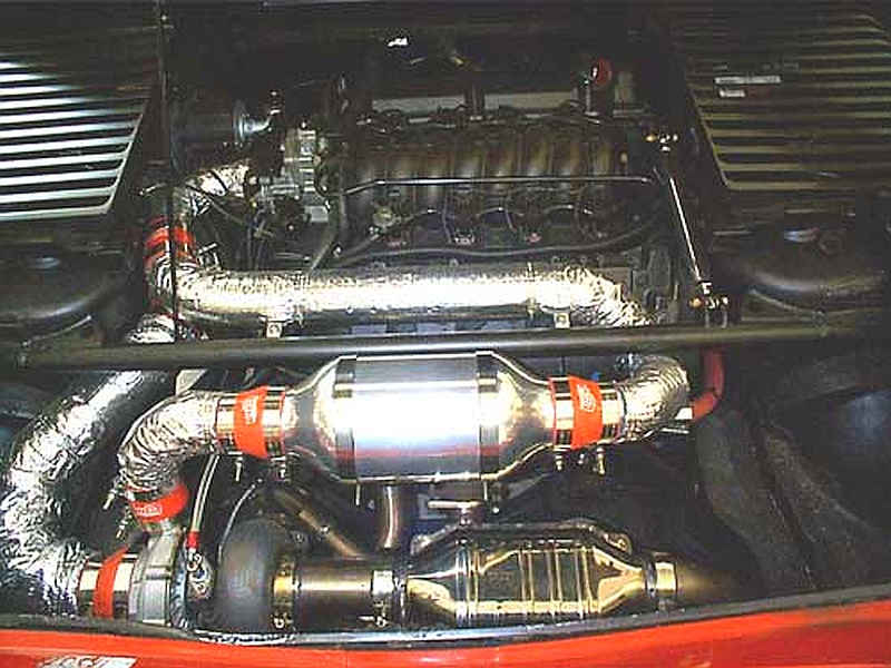

Hello All !! well somehow, maybe through my love of Fiero cars over the years I ended up with this car. Possibly a lot of folks here have seen pictures of this car as I can easily find them on the internet when you use the search posted in my subject line. I can't believe I own this car now! Always wanted a V8 fiero, any v8 will do haha ! but this car is neat. Anyway, working on getting it drivable again as it must have sat in a barn somewhere for a long time. Being a mostly chevy guy, I of course wish I had a small block chevy of any generation rather than this N* but hey, what am I gonna do but make it SING !! So far I have put a new Delco water pump impeller and added a Bosch water circulator for the cabin heat just to help it out... N* never had to push coolant so far and I like cabin heat. Tightened up all the myriad of hose clamps and added a few more in places critical like fuel etc... The turbo is still not quite 100% until I get the baby burped (cooling system) I cannot get on with other systems tests. Runs very smooth, nice soft motor mounts and excellent exhaust sounds like a regular v8 not a crazy loud v8 that most have due to lack of space. Anyone curious about the car drop me a line, although I may only be here once a week due to always working on something. Thanks ------------------ lets fix it

Welcome to the forums! Even if google can find pictures it's always nice to have them in the threads.

not sure how to post a current photo here. but here is a link in the following reply below, from before I got the car
I am currently seeking more info on the car, I am definitely an excited new owner!

thanks Patrick ! yes that's the car. I did not get the shiny cat though haha just the straight pipe was in it. I just returned from the local pick n pull with a small load of awesome custom plumbing from a N* to help sort out the air purge system to keep it cool for good. I feel very lucky to have went there today and stumbled across exactly what I wanted. I've read a lot of threads on this issue, will be plumbing up some stuff tomorrow. ------------------ lets fix it

Patrick, there is a large vent nicely cut out of deck lid, just above the cat/intercooler area
Ah... well, there'd have to be!
