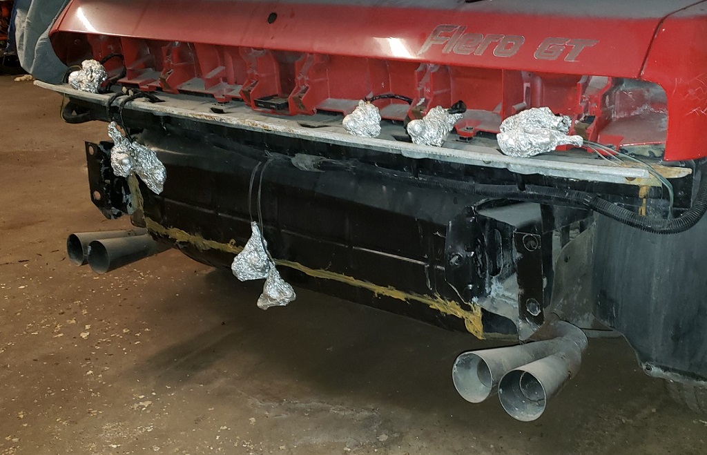

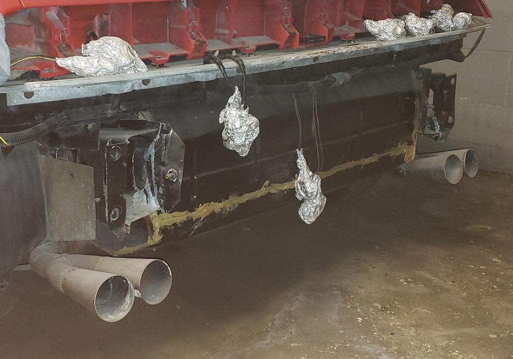

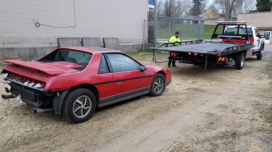

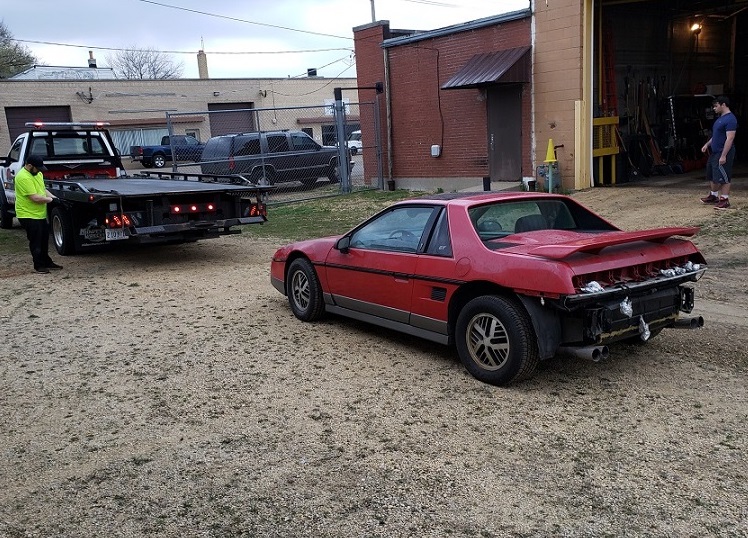

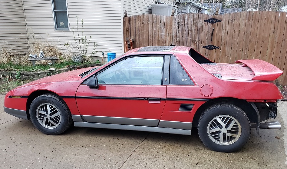

Looks pretty damn good... except for the back.
I'm curious though, just what is the story on the rear of the car?
hercimer01
APR 30, 09:30 PM
It was bumped in the back enough to bend the beam. And poke a hole in the bumper cover.
