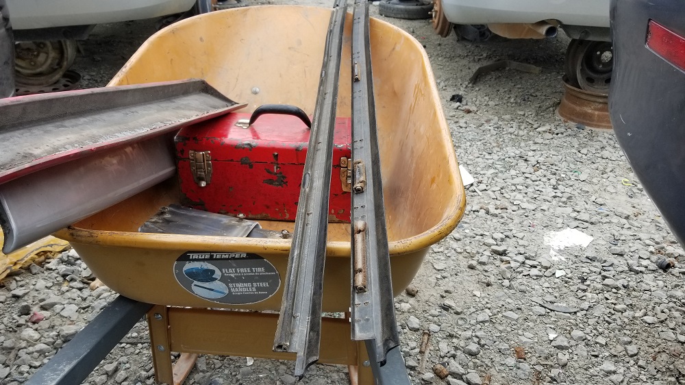

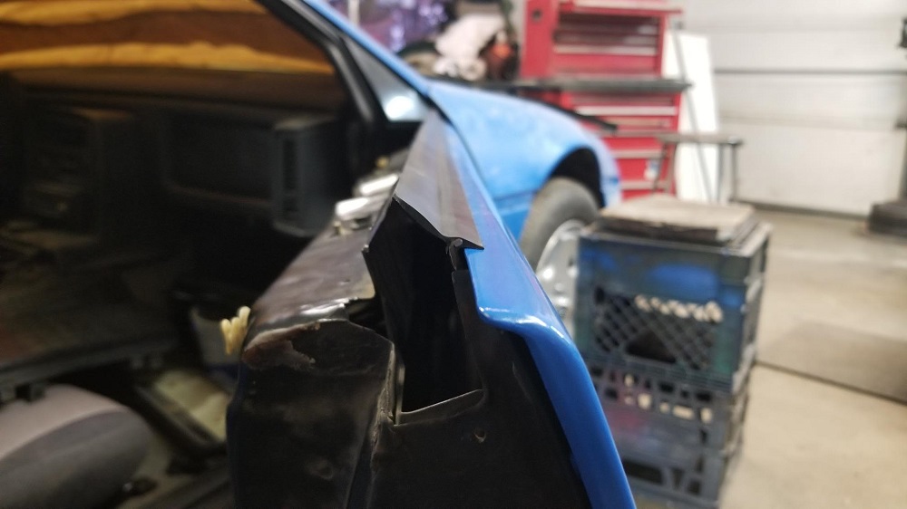

I'll have to take my doors apart to make sure, but here's what the Firebird/Camaro sweep looks like on one of my salvage yard door skins.
The Firebird sweep is on the left, the new Fiero sweep material is on the right. The rubber flange on the Fiero material sticks out more horizontally than the Firebird sweep, but that could because the Firebird sweep is 20 years old.
The Firebird/Camaro sweep is a better design, in my opinion, because it doesn't have the channel that would catch water. It’s one continuous slope from the window over the top of the door skin. I probably won’t be able to take the door apart and do a test fit until next weekend.

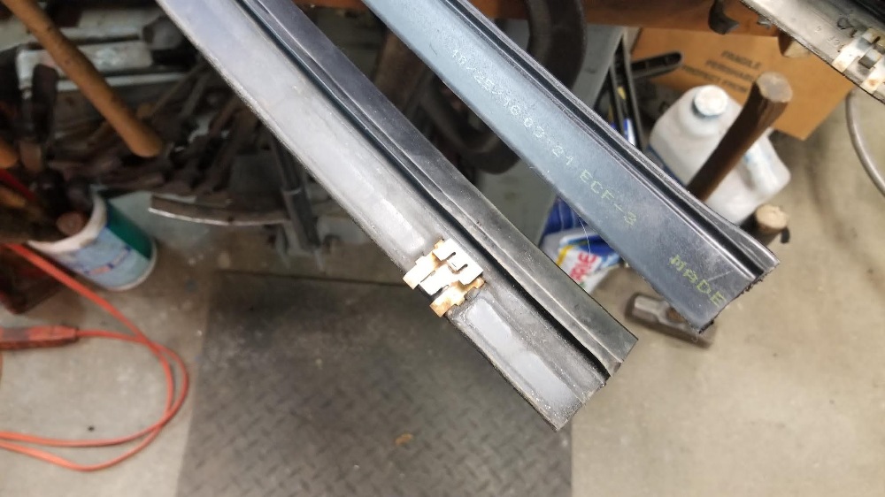

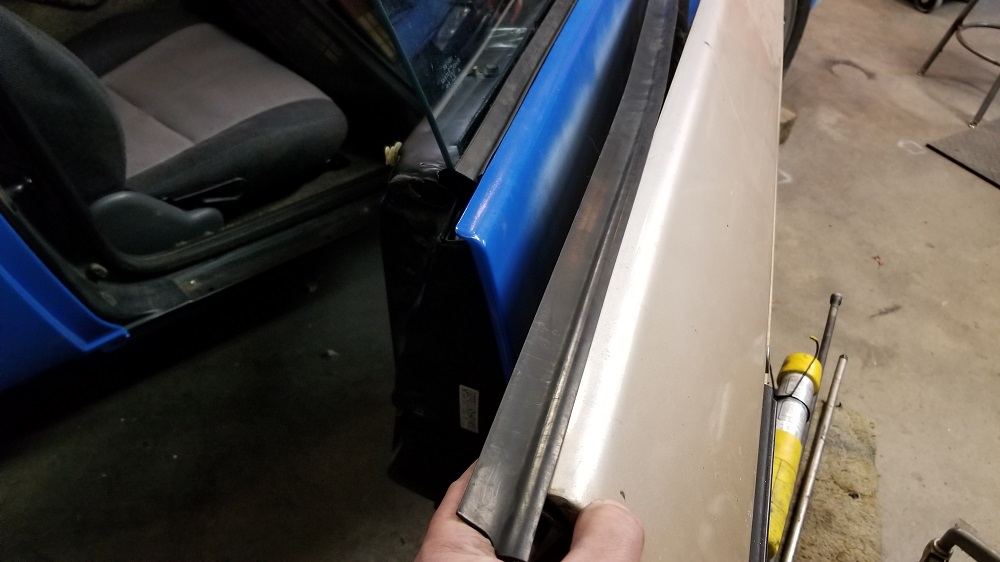

I spent some time in the shop this afternoon and the results were positive. As I mentioned, the Firebird/Camaro wipe is much wider than the Fiero wipe.
That's the Fiero wipe on the right:

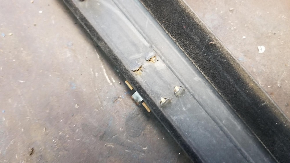

I discovered GM used at least two different designs for the Firebird/Camaro wipes. One design has the felt inserts like the Fiero's (although there are three of them instead of just two, probably because the wipe is a foot longer than the Fiero's). The other design has the felt as part of the wipe and runs the entire length:

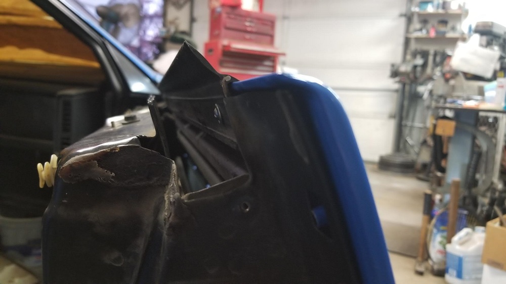

All week I'd been expecting to have to cut the Firebird wipe lengthwise to match the width of the Fiero wipe. I cut the Firebird wipe to length, then test fit it on one my salvage yard doors. There's plenty of room in the door for the wider wipe.

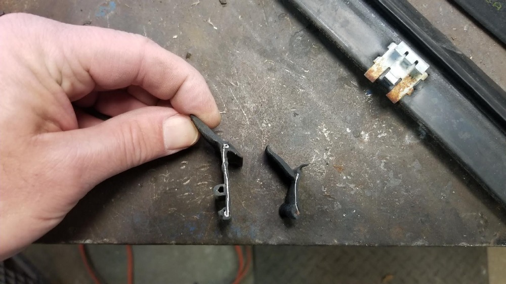

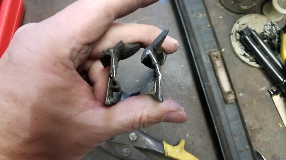

The Firebird wipe is attached to the door with these clips. They pry off easily.

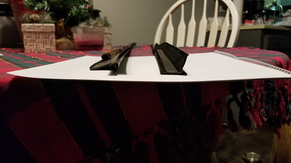

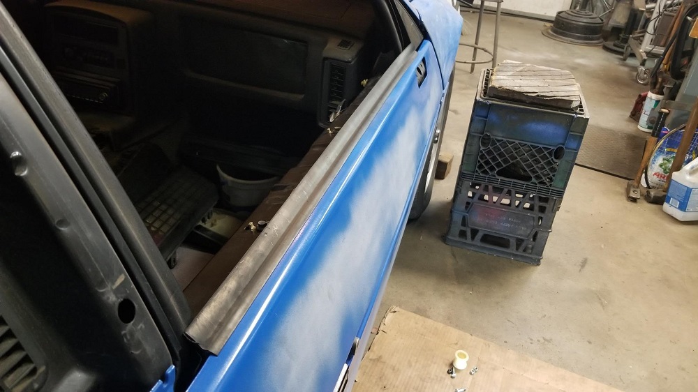

After cutting two wipes to the correct Fiero length, I then washed them carefully with soapy water. The result is two wipes that are supple and look almost new. I removed my second attempt at a DIY Fiero wipe from my passenger door, transferred the mirror mount over to the Firebird wipe, then test fit it on the Fiero:
