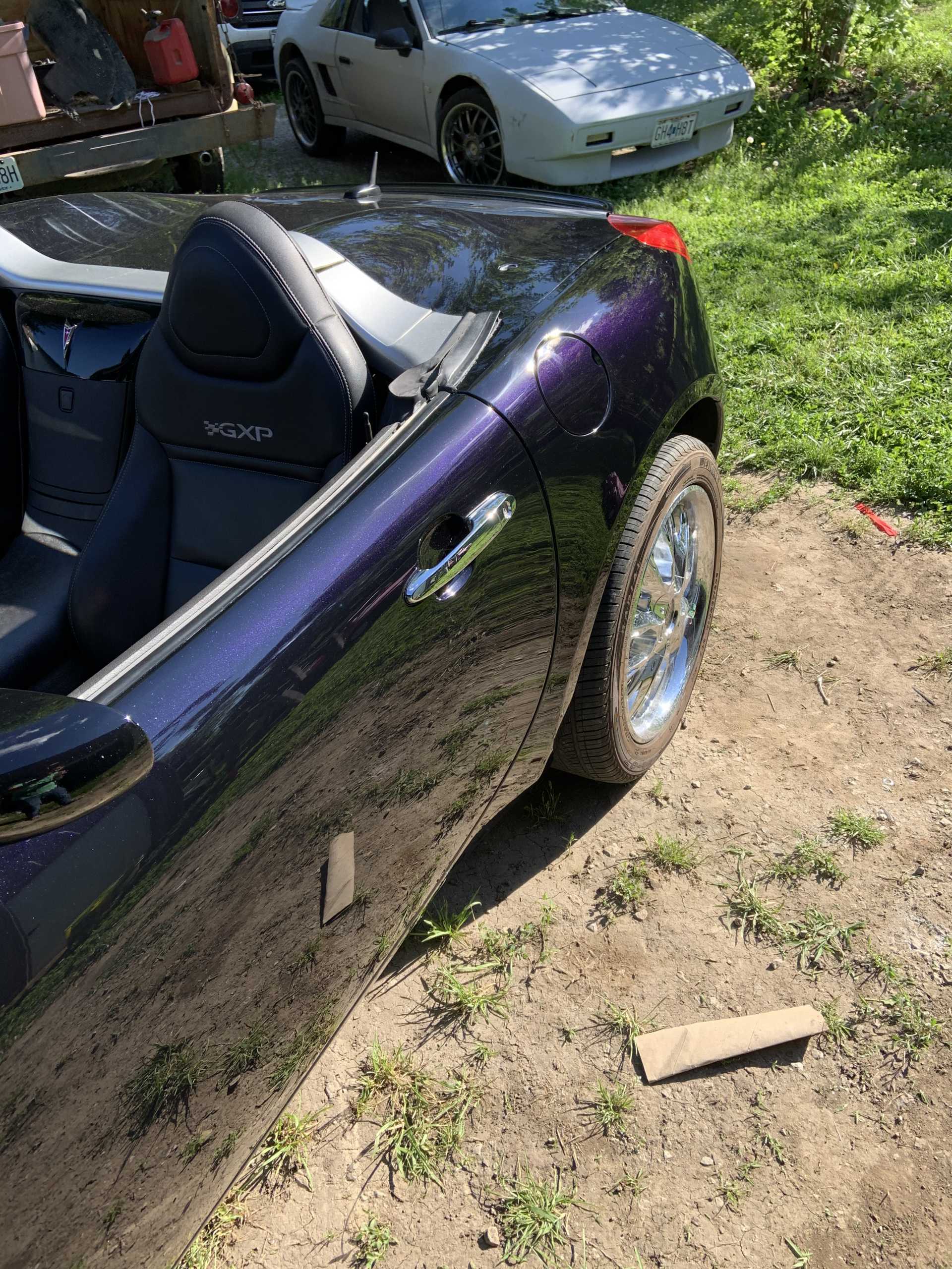

My client came to me with a solid black solstice. She wanted it to stay black but turn purple in the sun. I sanded everything down. Fixed a few door dings touched up the black and sprayed a coat of Pearl. 3 coats of clear and here is what It ended up as. Mission accomplished

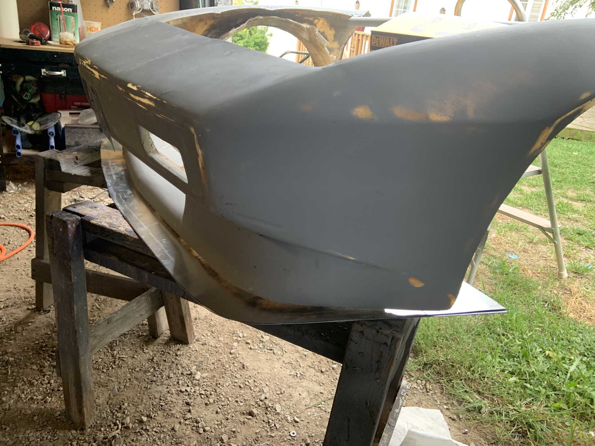

Working on the splitter getting things lined up.
Just need to take it to the break and make some bends.

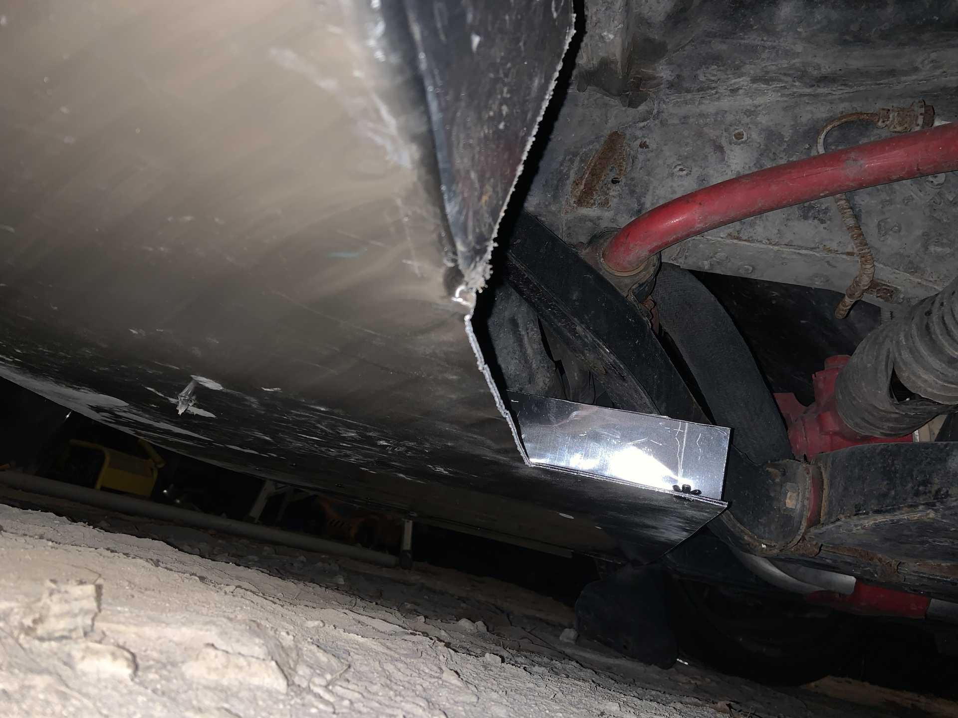

Was able to Mount it up for test fitting.
Flat bottom to the front subframe.
