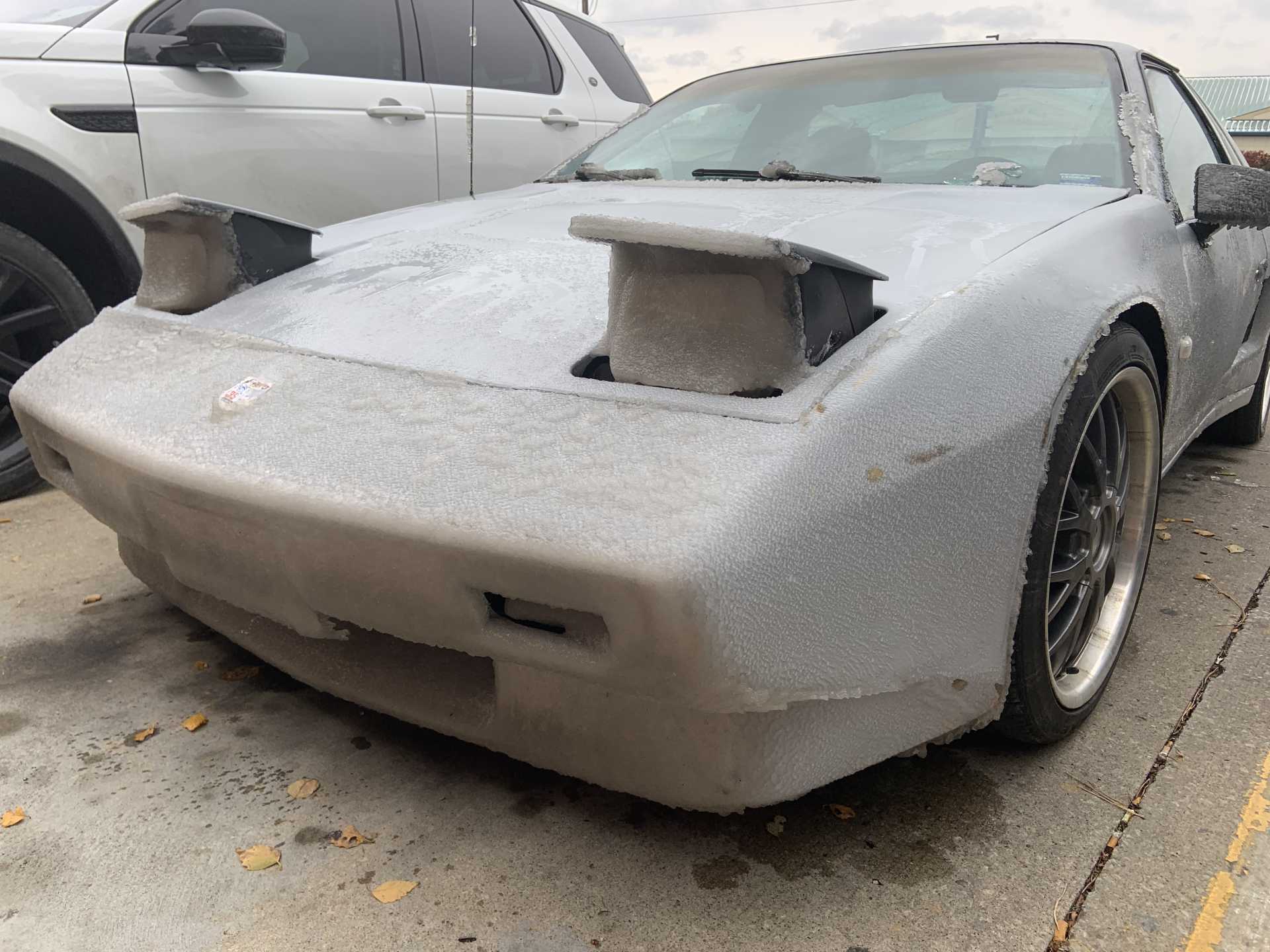

Well 6 months of rest is almost up so it’s about time to get back in the ball game working on this body. Just one crack has shown up and just a warps as the glass shrank. No I’ll start working on making all my gaps even and make sure the body gets blocked straight. I think I’m going to modify the bumpers at the lights to look more like the 87-88 coupe bumpers
Here is a look at the fiero as we got back from our trip in October. As you can see things were a little frozen.

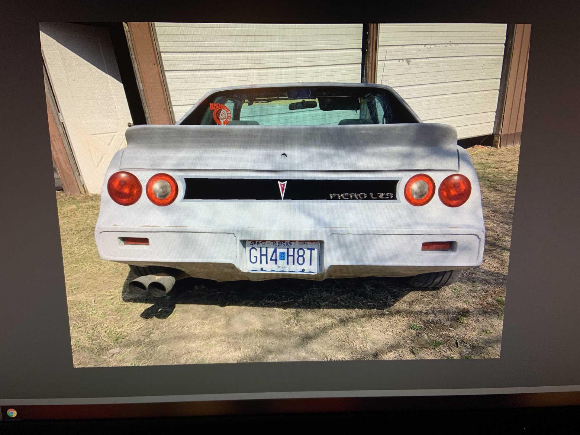

Awalker W02 MAR 09, 09:46 PM
Was playing around a little bit trying to stylize the rear a bit more. This is just a rough photo shop and I may play with the design a bit more. The spoiler is going to change as well. Not sure if I’m going to m just widen it and mold it in or if I’m going to go back factory with it.
Any ideas or comments?

Will MAR 09, 09:50 PM
Image doesn't work
Trinten MAR 09, 10:18 PM
The image is loading okay for me? Unless he fixed it already.
I can see the appeal there. It's a little bit Ferrari, but not trying to be a clone of any kind. Has a sleek 80s exotic car vibe to it.

Awalker W02 MAR 10, 11:03 AM
Yea my cellphone is weird and won’t allow me to post the photos in the initial comment. I have to go back in and edit the comment to add them.

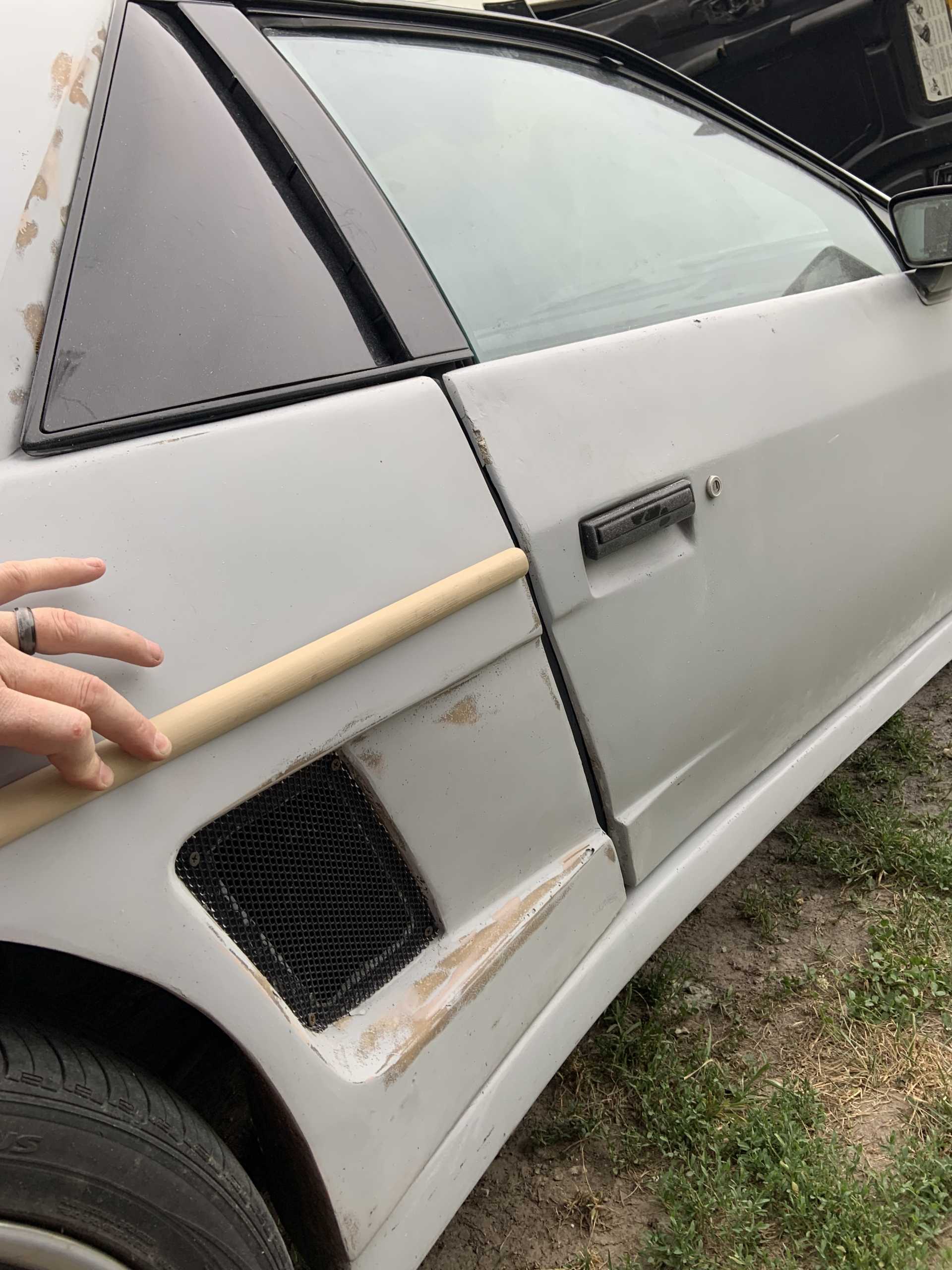

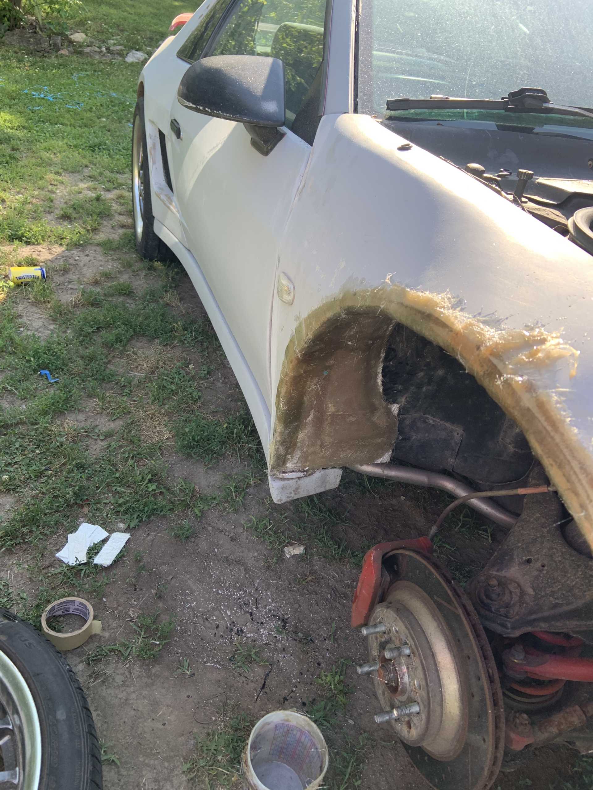

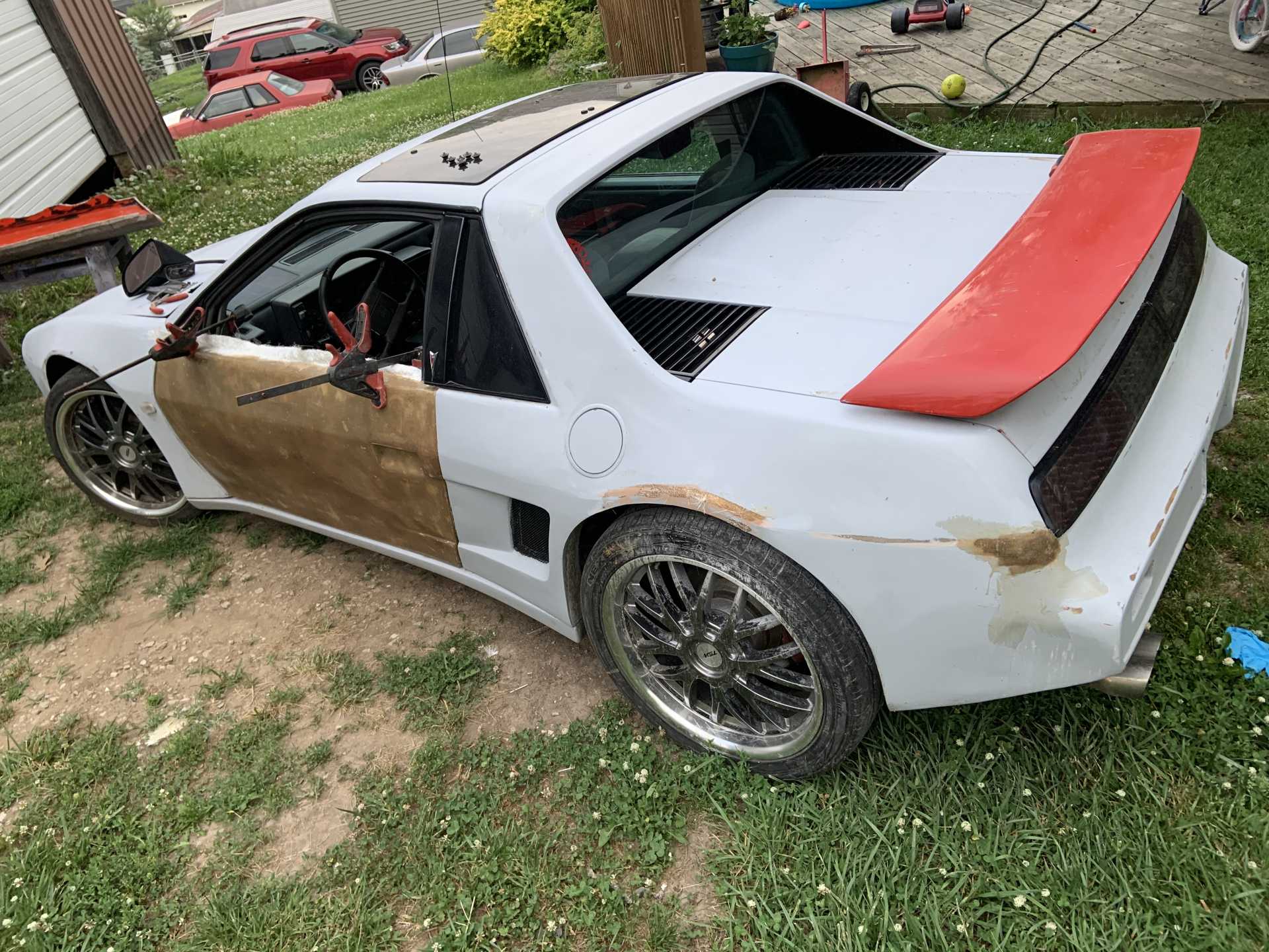

Awalker W02 JUN 23, 11:05 AM
Finished up my last customer so it’s time to get some work in before the next.
I recast my driver door skin as I was having some delamination issues with my fist. That panel was the first time I had cast from these molds and the largest cast really I have ever done so it was a trial to be honest.
I then moved to the front wheel liners and fiberglassed in the ps arch I had to move the whole opening forward about a half an inch to center the wheel so some additional body work was needed and as you can see still in progress.
My next objective is to figure out if I want to proceed with moldings or not? I have some half round Urethane adhesive molding. They will get painted but Thoughts?
