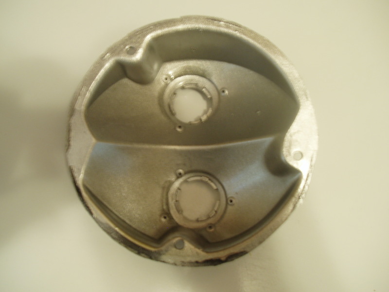

Larryinkc FEB 19, 11:53 AM
Originally posted by Rexgirl:
This is how I resolved the problem of my turn lights illuminating along with the brake lights on my 1987 SE based Mera... My solution involved the C-500 connector.
Taken from my 06-07-2014 post on "Paradise" page 149:
http://www.fiero.nl/forum/F...HTML/077195-149.html
To disable the brake switch from activating the rear orange (outside) turn lights on my SE based Mera, I did the following: Locate the C500 wiring connector mounted on the passenger side frame rail between the battery and the front of the strut tower. It has two multi-wire plugs; a front plug for the rear lights the another plug for the engine. Look at the front plug and you should see a LOOP of white wire that sticks out about three inches. Cut that looped wire and cover the cut ends with electrical tape. Now if I press the brake pedal, one half of each red tail light glows and the high mounted brake light (in the rear window) illuminates, and the orange (turn) tail light stay dark.
Pic: http://images.fieroforum.com/2012/c500loop.jpg
Thanks for the info, I finally got a couple of warmer days to work on my tail lights. I cut the looped wire and now the amber turn signals work right.
My tail light housings were warped where the bulb sockets twist in from bulb heat. I had some old C4 Corvette tail lights laying around so I cut part of the back out of them and pop riveted them to the Mera housings. The Fiero sockets don't fit in the Corvettte tail light backs so I had to change them too. The wiring for the tails and turns was a mess on my Mera so it was a good excuse the clean it up. It really worked out pretty good and now the bulb sockets twist in and lock like they are supposed to. In the process I found that one of the red tail light bulbs on each side of my Mera is a single filament bulb, they don't have a brake light filament. I am going to change it to a two filament bulb and socket so the brake lights will be brighter.
I also ordered some Plasma LED bulbs, they look pretty good, I will post an update when I get them.
