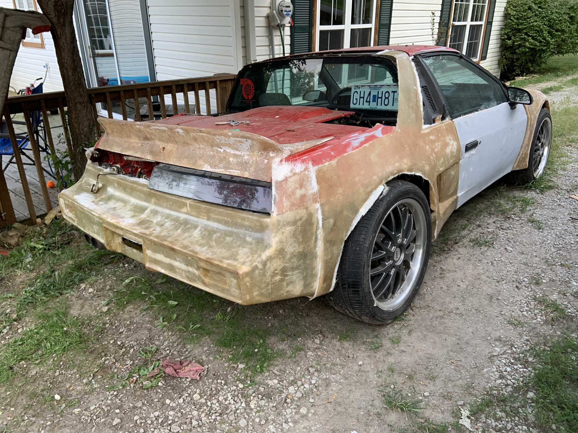

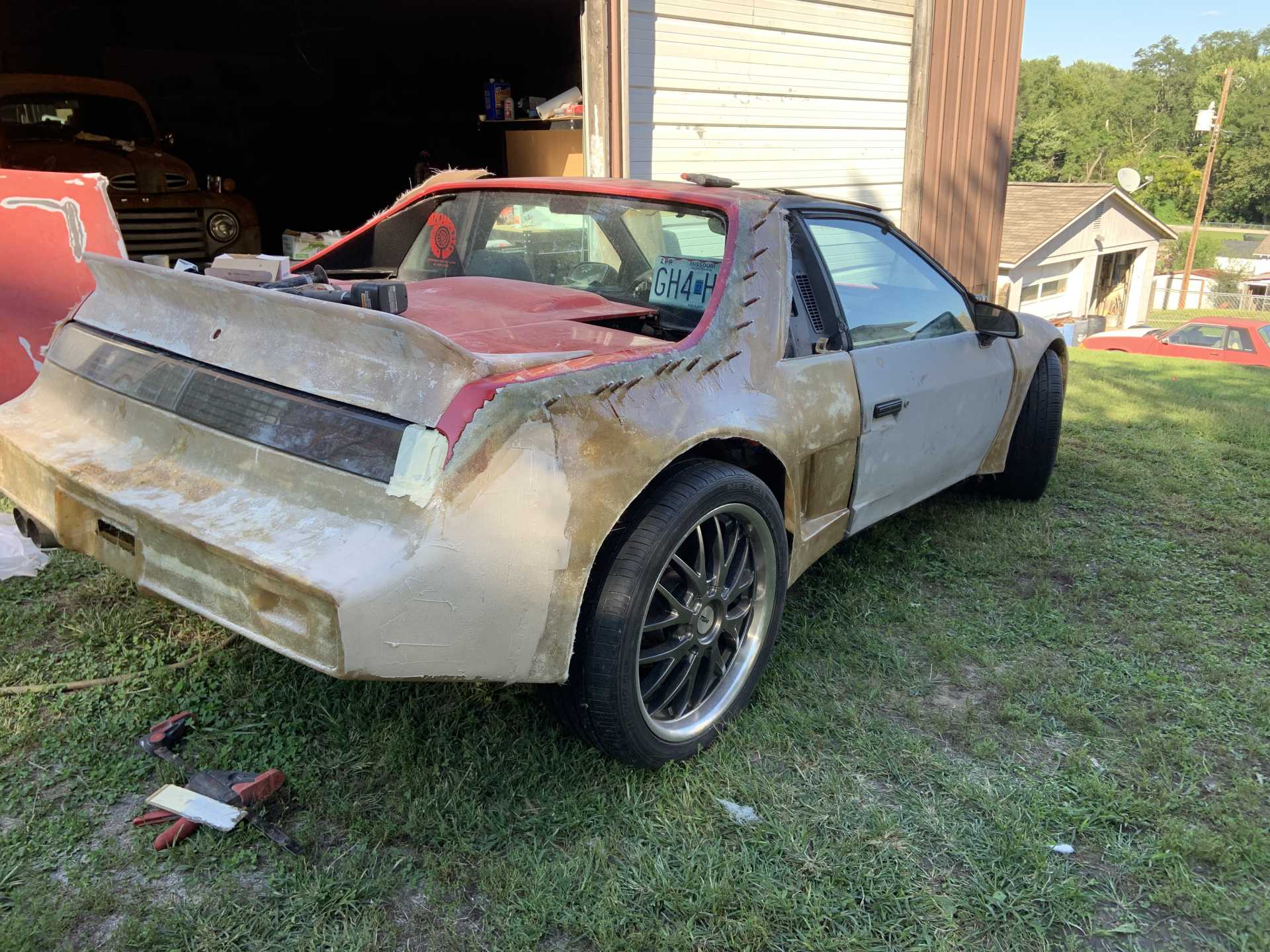

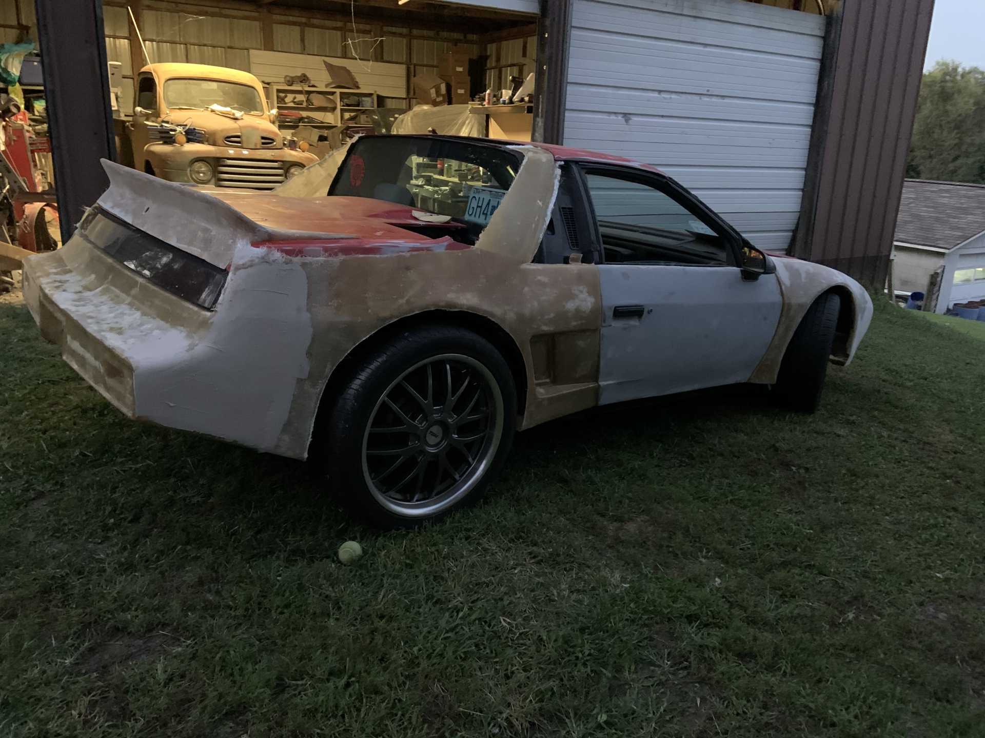

Another update. I haven’t made much progress but the rear bumper is cast.

Raydar AUG 25, 11:05 AM
This is a really interesting body!
I've been around Fieros a LONG time, but can't recall ever seeing a front end even remotely like that... keep up the great work!
Heck... I bought my first Fiero new in 85. I have never seen that body. Ever.

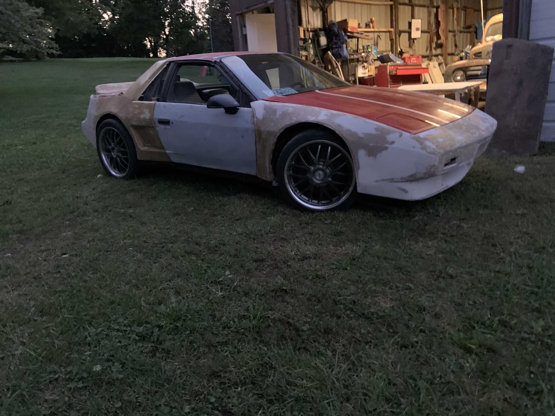

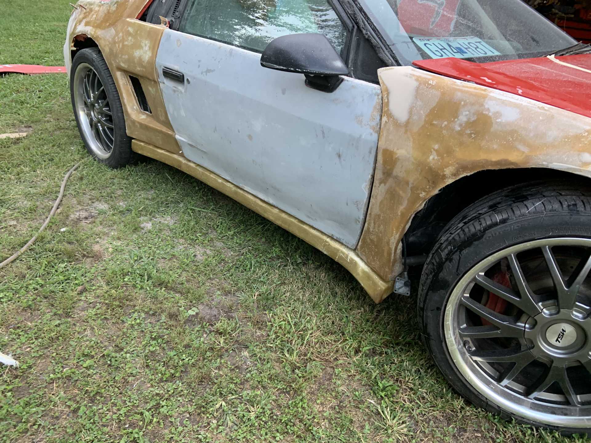

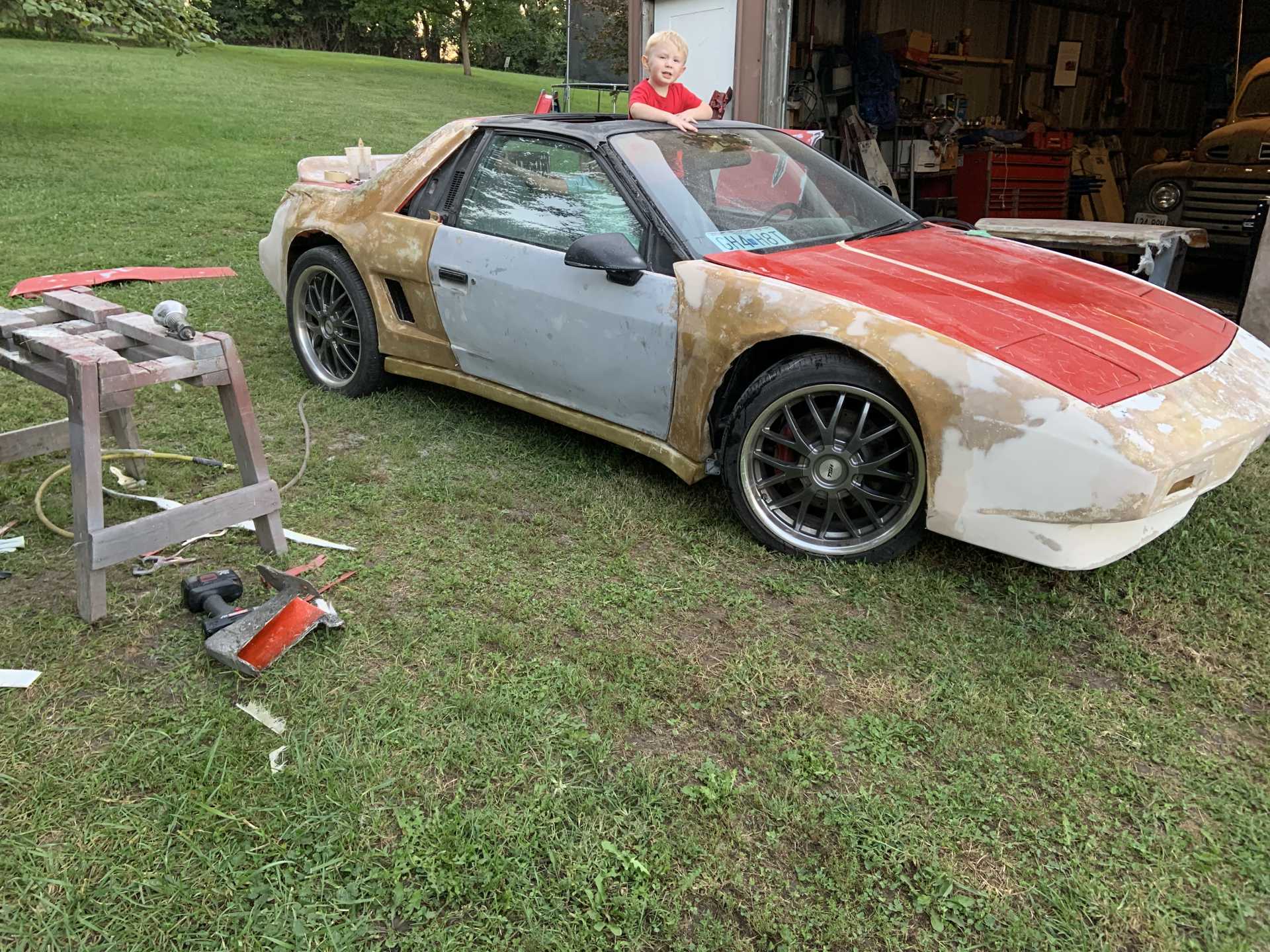

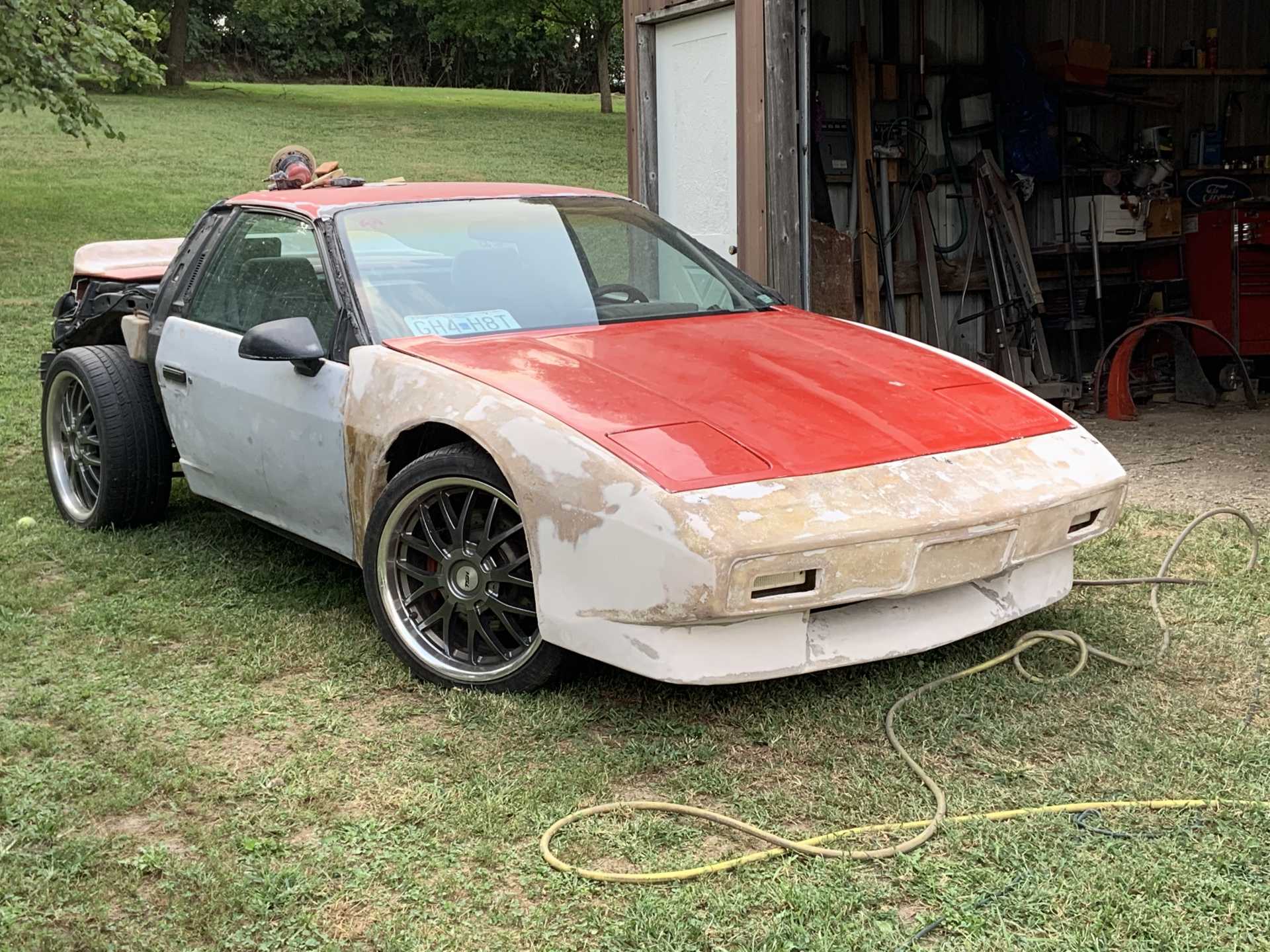

Awalker W02 SEP 07, 09:49 PM
The front clip is officially fit. I have a little work to do at the front door gap to fit my liking but everything else is looking great and ready for primer.

Awalker W02 SEP 12, 08:55 PM
I finished up attaching all the mounts on the passenger door skin, fiberglass the rear clip to one complete piece, and cast the ds door skin today. Very productive day today

Awalker W02 SEP 13, 09:16 PM
I did make some progress today as well. Cast the Passenger rocker and glassed the passenger quarter to the clip.

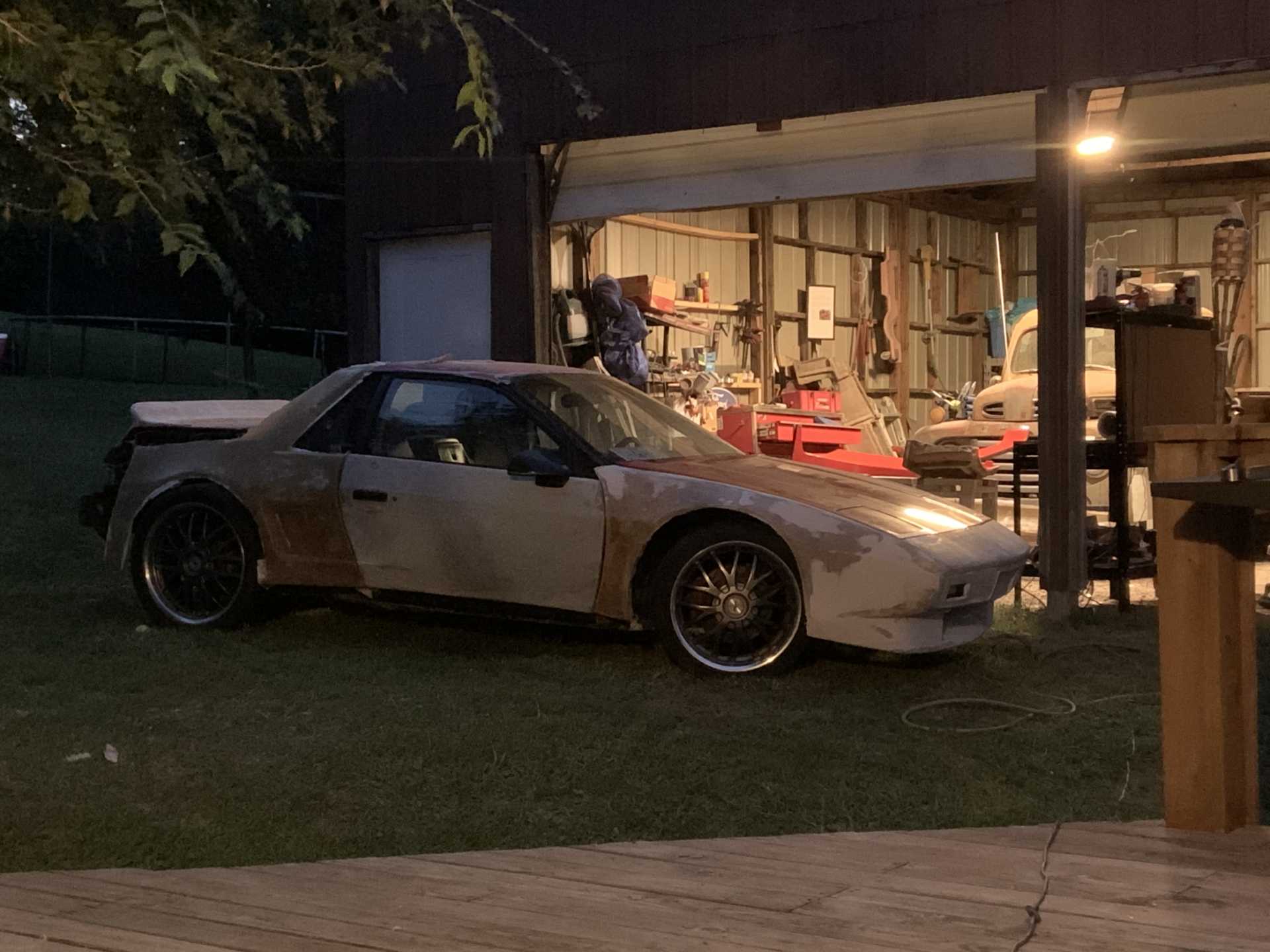

Awalker W02 SEP 14, 09:20 PM

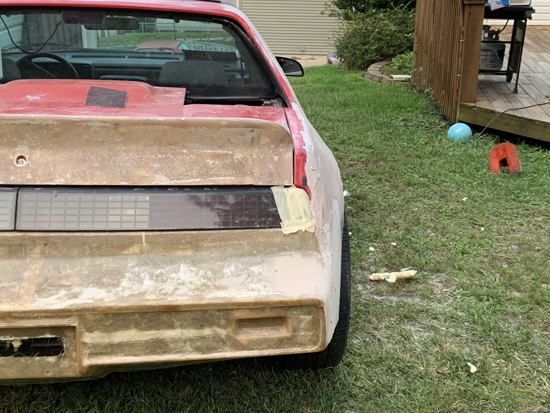

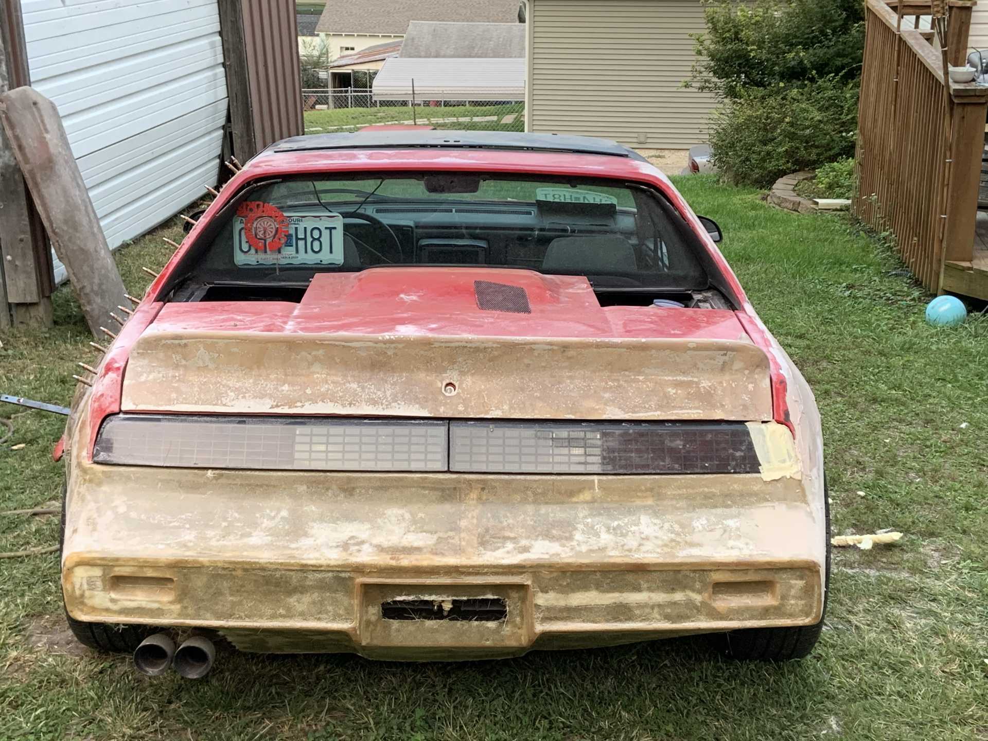

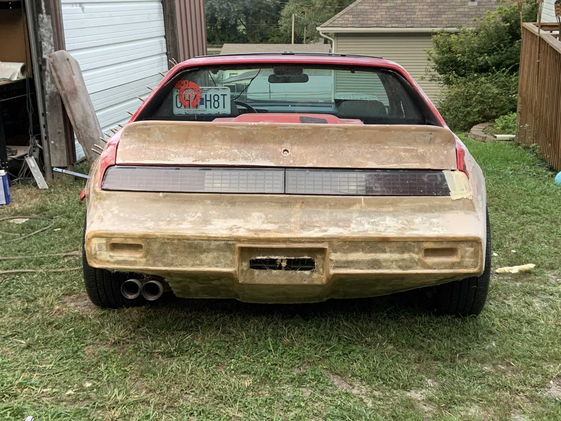

Here are a few more pictures
[This message has been edited by Awalker W02 (edited 09-14-2020).]
fieroguru SEP 14, 09:42 PM
Most of the body has some potential, but that rear bumper just doesn't do it for me. Looks like it sticks out a few inches past stock and looks a little out of place. Might be an area worth reworking.
Awalker W02 SEP 15, 09:11 AM
Yep, that rear bumper is definitely on my list. I have figured a way to shorten it a bit. It also needs something else like a diffuser or something a little bit lower. I’m still working out the details but there will be some reworking done here.
