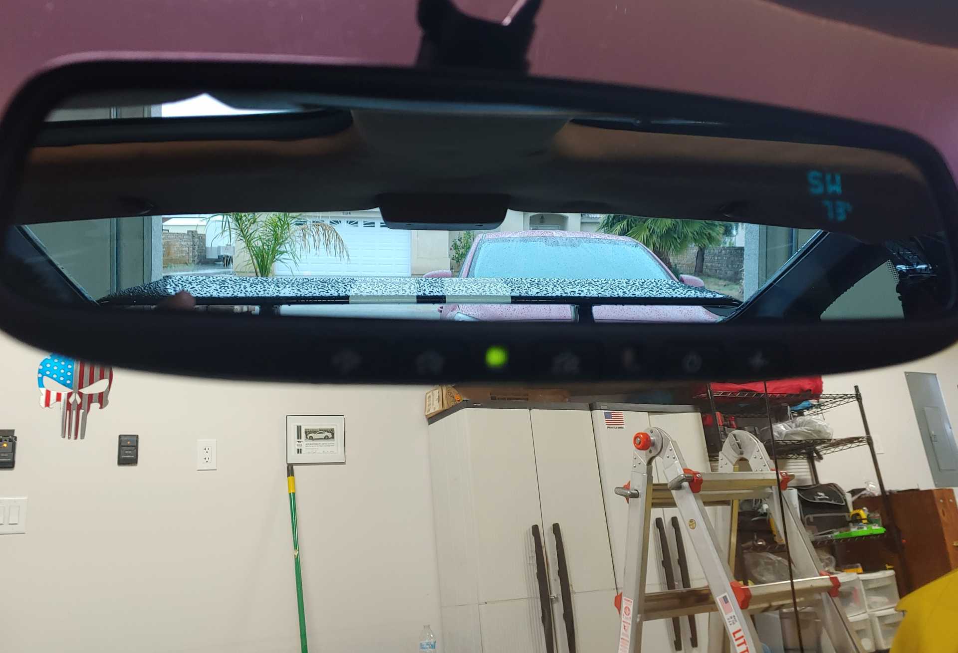

I got my homelink mirror wired up and working.

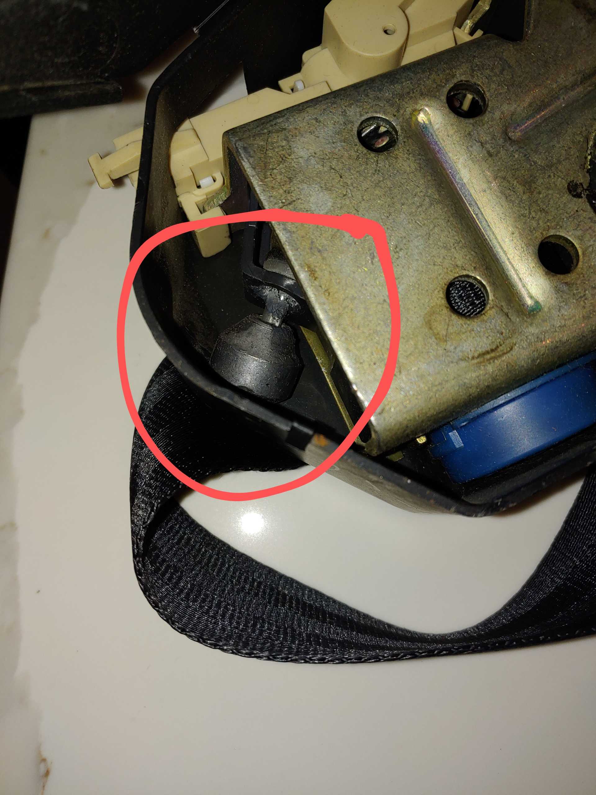

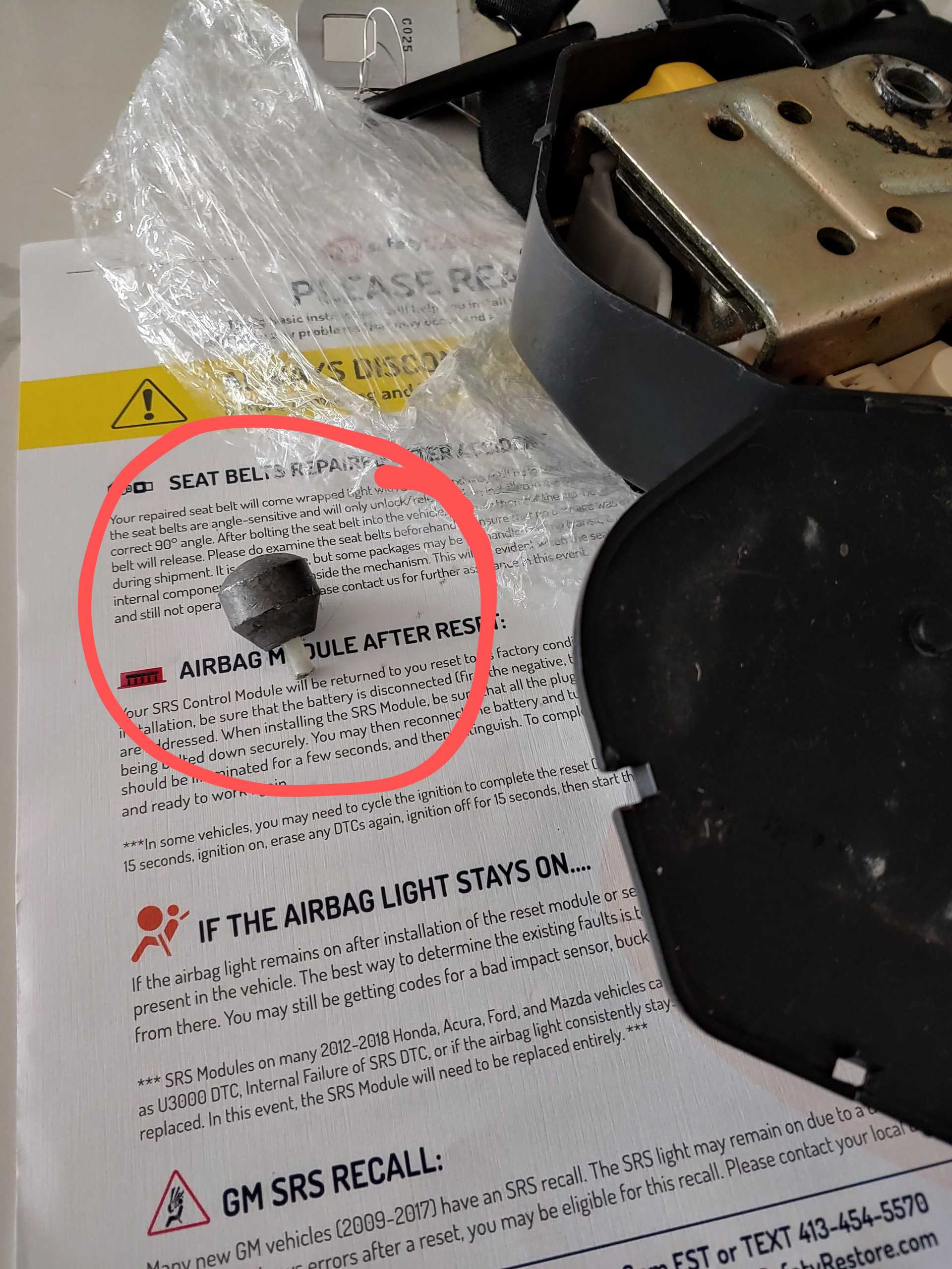

Does anyone know what this part of the seat belt mechanism is for? Is it essential to the function of the seat belt mechanism? I sent my seat belts in to be re-webbed and when I got them back, this piece was rattling around inside, it had broken off. The other seat belt is just fine.
The good one
The broken one
fieroguru MAR 15, 12:30 PM
I suspect that is the pendulum lock for the seat belts.
Under rapid deceleration or impact, the weight swings forward, locking the seat belt. If it is broke, I doubt the seat belt will work in an accident.
Chief08 MAR 15, 01:00 PM
That makes sense, when I told them about it and sent a picture, they said that it wasn't part of the seat belt and I could just toss it. I knew that wasn't right, but I didn't know what purpose it served, so thank you.
Can you tell me how you connected the temp side? where did you put the sensor? I put one of these in but can only get the compass to work. Thanks.
And BTW, I've been to Yuma. It's NEVER been as cold as 73 degrees!
[This message has been edited by Habanera Hal (edited 03-15-2020).]
Chief08 MAR 15, 06:20 PM
I put the temp sensor right behind the center of the the front bumper do it would be in front of the radiator and protected from direct air flow. As for being 73 degrees, it was cooler because it was a rainy day, yes it actually rained for three days.
